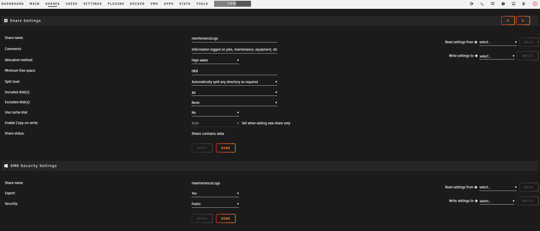

Here are the settings for the share with the issue:

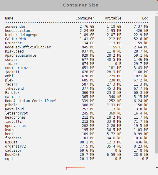

I know this is not what you are posting about, but it looks like you are filling your docker image. You have it set to 50G but the only thing that will do is make it take longer to fill. If you have your apps configured correctly it is unlikely you would ever need even 20G.
Yes, you're definitely right.  I have many many dockers and there has to be at least one or two that are storing some sort of file inside the container and making them grow.  Haven't found a simple way to solve his one yet.  This shows it should be around 20GB.  Not sure why zoneminder and HA get so big.  Homeassistant database gets large but that's on the array.  Zoneminder recordings have their own share.  DelugeVPN downloads to different folders within a share.  Always been perplexed by this one.
Edited by Living Legend
Your diagnostics show 18G currently used. Does it eventually grow to fill your 50G?
