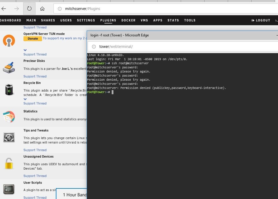

@ken-ji ssh didn't work.. enter the password right 3 times
do I need to remove the ssh plugin...  do I not loose the features off ssh then... as all I know when I was following instructions it stated you needed to install it for extra features
You probably should or at least disable all the settings for it. - SSH plugins adds features but you don't need them until you get the base ssh working.
you can remove it on the mitchsserver then reboot to be sure that its disabled.
@ken-ji nope didn't work  deleting ssh pluging and rebooting  didn't help

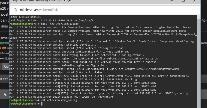

can you run this on mitchsserver
tail -n20 /var/log/syslog
then post the output here.
You can copy and paste from the webterminal (I've forgotten that you can do that), just highlight with the mouse then rightclick to copy
then also cat /etc/ssh/sshd_config and paste that too...

root@mitchsserver:~# tail -n20 /var/log/syslog
Mar  1 17:36:29 mitchsserver root: Fix Common Problems: Other Warning: Could not perform unknown plugins installed checks
Mar  1 17:36:30 mitchsserver root: Fix Common Problems: Other Warning: Could not perform docker application port tests
Mar  1 17:36:39 mitchsserver emhttpd: req (1): userName=root&userPassword=****&userPasswordConf=****&cmdUserEdit=Change&csrf_token=****************
Mar  1 17:36:39 mitchsserver emhttpd: shcmd (115): cp /etc/passwd /etc/shadow /var/lib/samba/private/smbpasswd /boot/config
Mar  1 17:36:39 mitchsserver emhttpd: Starting services...
Mar  1 17:36:39 mitchsserver emhttpd: shcmd (127): /etc/rc.d/rc.nginx reload
Mar  1 17:36:39 mitchsserver root: Checking configuration for correct syntax and
Mar  1 17:36:39 mitchsserver root: then trying to open files referenced in configuration...
Mar  1 17:36:39 mitchsserver root: nginx: the configuration file /etc/nginx/nginx.conf syntax is ok
Mar  1 17:36:39 mitchsserver root: nginx: configuration file /etc/nginx/nginx.conf test is successful
Mar  1 17:36:39 mitchsserver root: Reloading Nginx configuration...
Mar  1 17:36:42 mitchsserver emhttpd: shcmd (128): /usr/bin/php -f /usr/local/emhttp/webGui/include/UpdateDNS.php
Mar  1 17:36:42 mitchsserver emhttpd: shcmd (128): exit status: 1
Mar  1 17:36:42 mitchsserver nginx: 2019/03/01 17:36:42 [alert] 13949#13949: *1919 open socket #18 left in connection 17
Mar  1 17:36:42 mitchsserver nginx: 2019/03/01 17:36:42 [alert] 13949#13949: aborting
Mar  1 17:37:07 mitchsserver sshd[3575]: Failed password for root from 192.168.0.3 port 51092 ssh2
Mar  1 17:37:10 mitchsserver sshd[3575]: Failed password for root from 192.168.0.3 port 51092 ssh2
Mar  1 17:37:13 mitchsserver sshd[3575]: Failed password for root from 192.168.0.3 port 51092 ssh2
Mar  1 17:37:13 mitchsserver sshd[3575]: Connection closed by authenticating user root 192.168.0.3 port 51092 [preauth]
Mar  1 17:46:33 mitchsserver login[16131]: ROOT LOGIN  on '/dev/pts/0'
root@mitchsserver:~# cat /etc/ssh/sshd_config
yes better. you can also use the </> in the edit toolbar to paste it in monospace, which makes code and text from screens easier to read.
odd. your /etc/ssh/sshd_config should not be empty... that's why root is unable to login...

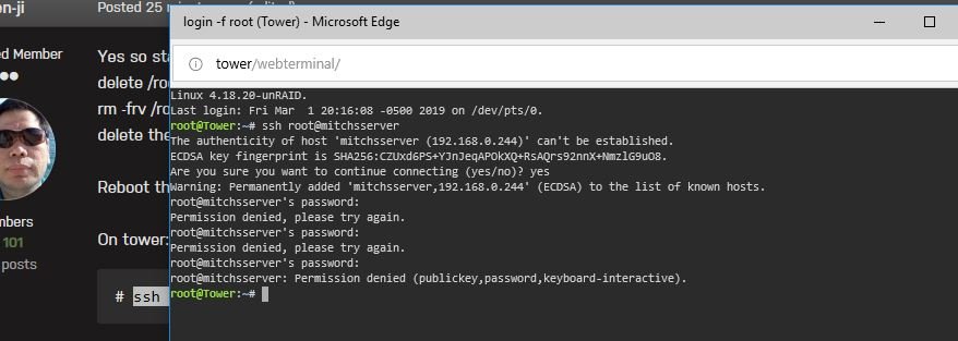

1 hour ago, ken-ji said:
On tower:
# ssh root@mitchsserver
This will definitely prompt about the unknown key (like this)
The authenticity of host '192.168.71.1 (192.168.71.1)' can't be established.
RSA key fingerprint is SHA256:DsrQk63wK2wX+GZRvT8Z2eP3C/W3qk9jb4z5cQQ4nyg.
Are you sure you want to continue connecting (yes/no)?
Just type yes
If there was no root password on mitchsserver set via the Web GUI, this will let you in right a away, else it will prompt you for the password which should let you in right away.
Repeat for mitchsserver.
Now do this.

yaaa it let me in     but fails on trying to login tower from mitchs server
Linux 4.18.20-unRAID.
Last login: Fri Mar  1 20:28:37 -0500 2019 on /dev/pts/0.
root@Tower:~# ssh root@mitchsserver
root@mitchsserver's password:

ECDSA key fingerprint is SHA256:LZ7Gv59/aJoBgmJ9/fBADDmpfbtgb1Z30cSzGQh7TRQ.
Are you sure you want to continue connecting (yes/no)? yes
Warning: Permanently added 'tower,192.168.0.3' (ECDSA) to the list of known hosts.
root@tower: Permission denied (publickey,keyboard-interactive).
