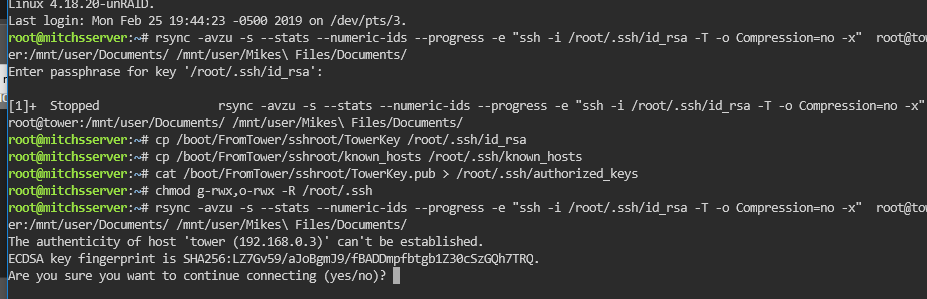

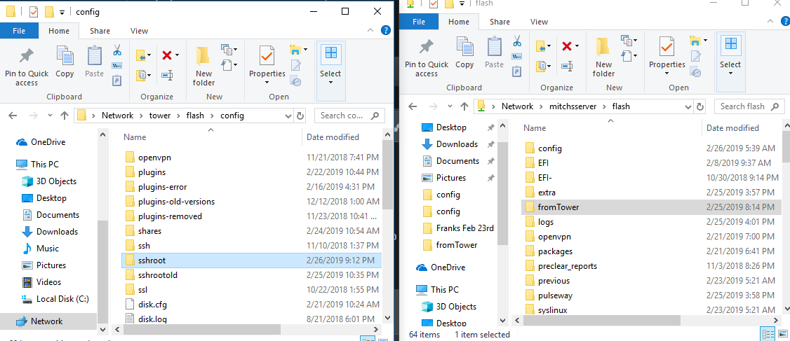

@Hoopster   still having issues everytime I reboot I gotta type "yes"  as it says it cant establish a connect... it copies the files at boot up  and here you see I did it manually...  but its not connecting do you know why
I re did a new phrase on tower...  then copied the towers    Flash/config/sshroot folder to  the mitchsservers     flash/config/FromTower/sshroot  folder on the usb
but its not saving
and on the tower (main server)  I typed
ssh-keygen -t rsa -b 2048 -f /root/.ssh/id_rsa
cp /root/.ssh/id_rsa /boot/FromTower/sshroot/TowerKey
cp /root/.ssh/* /boot/config/sshroot/

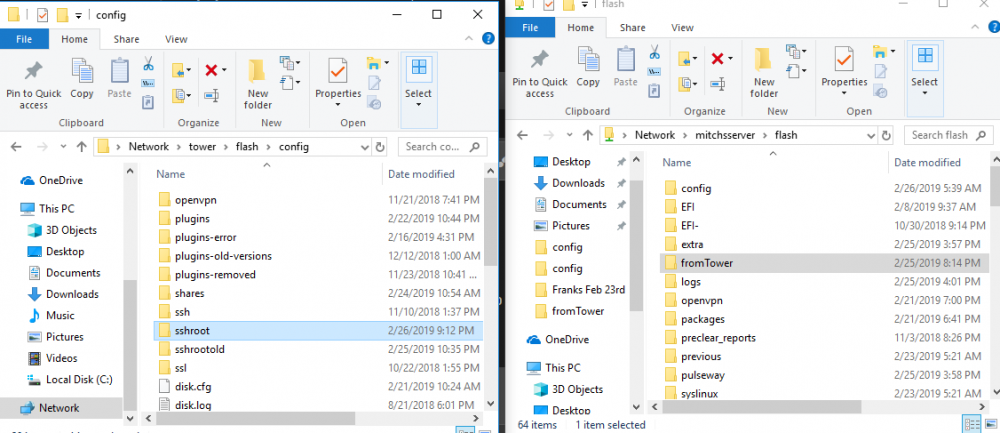

and then I copied  Towers    Flash\config\sshroot     to  mitchsservers       Flash\FromTower\sshroot
and I still cant connect
@Hoopster  I also slimmed the code down  but it still gives me the damn cant connect

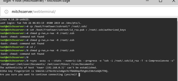

ok so that didn't work
that command you gave worked for whatever it did 3 things
then I copied in windows  Towers  sshroot folder (Flash )  to  mitchsserver (FromTower) (Flash)
and then I ran the commands that the go file would run... and it doesn't work also  chmod doesn't exist now too
as I wanna be able to run rysnc either from Tower  or from Mitchserver  and I currently trying to run from my sisters server...

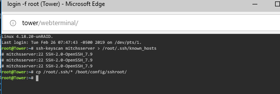

You ran ssh-keyscan on tower, so tower can now run rsync to mitchsserver without getting prompted.

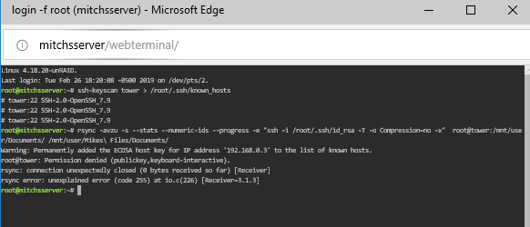

You should also run ssh-keyscan tower on mitchsserver, which would let you run rsync to tower without getting prompted.
root@mitchsserver:~# ssh-keyscan tower > /root/.ssh/known_hosts
root@tower:~# ssh-keyscan mitchsserver > /root/.ssh/known_hosts

I must be missing a step that didn't work either
ssh-keyscan is a command to fetching the host keys before you actually connect.
In a really strict security environment, the keyscan command is run and compared to the expected host keys (either pre generated, or compared to a local access). It also allows automation to run without having ssh to a new server block with the authenticity prompt you've been blocked with.
You're current screen indicates that the id_rsa file in mitchsserver is not considered valid in tower.
if you are using the same id_rsa file on both tower and mitchsserver, then the same id_rsa.pub should be used (copied into authorized_keys file)

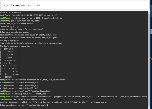

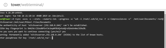

so now I tried from tower to push the files to mitchsserver
rsync -avzu -s --stats --numeric-ids --progress -e "ssh -i /root/.ssh/id_rsa -T -o Compression=no -x"  /mnt/user/Documents/ root@mitchsserver:/mnt/user/Mikes\ Files/Documents
it does the same error    says cant establish  and need to yes no  ugh  this frustrating  what am I doing wrong?
there has to be something wrong.. so I decided to go back do what I showed  and what you said keyscan…    I re did a new key  I copied to mitchsserver
 I ran  one direction from tower to mitchsserver and the damn friging thing still not working it cant find it...I getting frustrated with this rysnc stuff
Edited by comet424
You are triggerring a different issue here. Notice that it is asking for a passphrase.
Did you just press enter when it asked "Enter passphrase (empty for no passphrase):" ?
ya I noticed.. how do I fix that problem  its not reading the paraphrase from the file.. so this just frustrating
