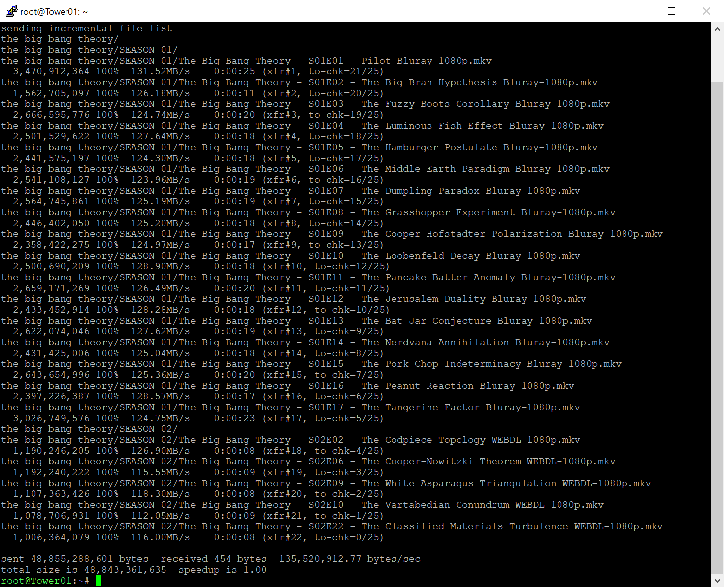

@johnnie.black ran a test and had an interesting outcome.
Any thoughts on why I went from +/- 115Mb/s to 50Mb/s?
Thermal?
Test bkup disk is an - HGST HUS726060ALA640 Ultrastar He6 (Helium Platform) 6TB 7200RPM 64MB Cache SATA 6.0Gb/s
NO cache, but parity is still enabled...
64GB ram and processors did not seem to be working hard at all.

@johnnie.black - Worked like a charm!
One thing was rather concerning though, during the 'sync' CPU 8 and 12, out of 24, were pegged at 100% usage while the others were only 10-20% usage.
Normal? Is there a way to spread the love around?
(And for those wondering, yes, I DO own the discs! ;) )
27 minutes ago, TechMed said:
Normal?
Yep, not much you can do about that.
