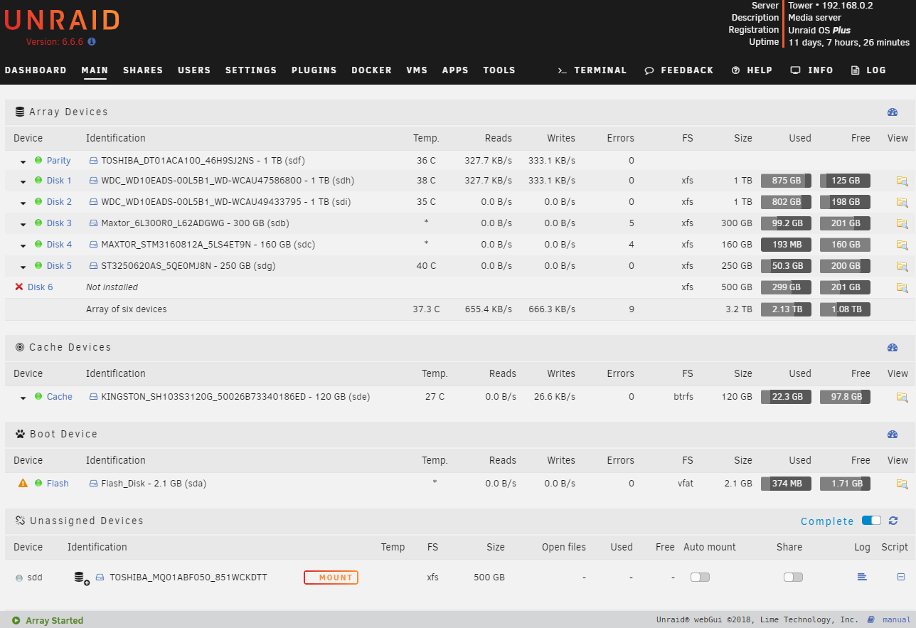

Hey folks -
First time I've encountered an error on UnRaid, running version 6.6.6. The Fix Common Problems plugin is telling me that Disks 3 & 4 have read errors, and Disks 3 & 6 are in Read-only mode.
  1. How do I remove the unused disk 6 from the array? I moved all the content off the drive a long time ago, I just need to clean up the array finally.
  2. What do I do about Disk 3.... and then Disk 4? So I get my array back into good health.

7 hours ago, jeradc said:
How do I removed the unused disk 6 from the array? I moved all the content off the drive a long time ago,
First, click on the folder icon to the right of the emulated disk6 slot, and see if there is anything there you want to keep. Just because the disk is listed as not installed, doesn't mean it's unused. You appear to have 300GB of content on that slot that will be lost if you remove it.
You should also post the diagnostics: Tools -> Diagnostics
Honestly, from the meager information you have provided, my best advice is to purchase a 4 or 8TB USB drive and make a copy of all the data on the array at the moment. You have less than 3TB used, so that shouldn't be too much trouble.
Some of the drives in your array have got to be pushing 15 years old, I'm surprised you haven't had a catastrophic failure. Keep in mind that ALL drives in the array are used to recover a single bad drive, and you are currently in that state, where if you lose another drive, you will lose all data on both disk6 and whichever other drive or drives decides to die next.
Your data is in a very risky state right now, I'd back it up to another location asap.
@jonathanm - Disk 6 "not installed" is the (SDD) drive listed as "unassigned" and I am 100% confident it has zero content.
Secondly, I'm aware of the age of array, and do a have a cloud backup with crashplan. :)
Right now, I just need to know the steps to put the array back together. I have (2) 1.5 TB drives available to add to the array, or to use to replace any of these drives, if needed.
thanks!
Disks 3 and 4 issues are likely a controller problem, can't see SMART for either, don't know if it's the controller or if they dropped offline since the syslog cuts off, they are both using a JMicron controller, not recommended for Unraid.
A reboot might fix it for now, if if does, and SMART looks good for both, you need to do a new config to remove disk6, assuming any data there doresn't matter.

I tried to use the Unraid web GUI to reboot or power down, but there was no response from the system. I held the power button for 8 seconds and the system came back up and said the array has returned to a "good" state.
No errors and everything is green. SMART show's no errors, with the short tests returning "completed without error".
But I dont trust it, lol.
I think I need to do the following:
  1. Remove the unused disk 6 by "doing a new config". (I'll google this I suppose)
  2. Upgrade to 6.6.7
  3. Run a consistency check on the array (unless setting up the new config has that step).
Edited by jeradc
You should also replace that JMicron controller sooner rather than later, or risk the same happening again.
