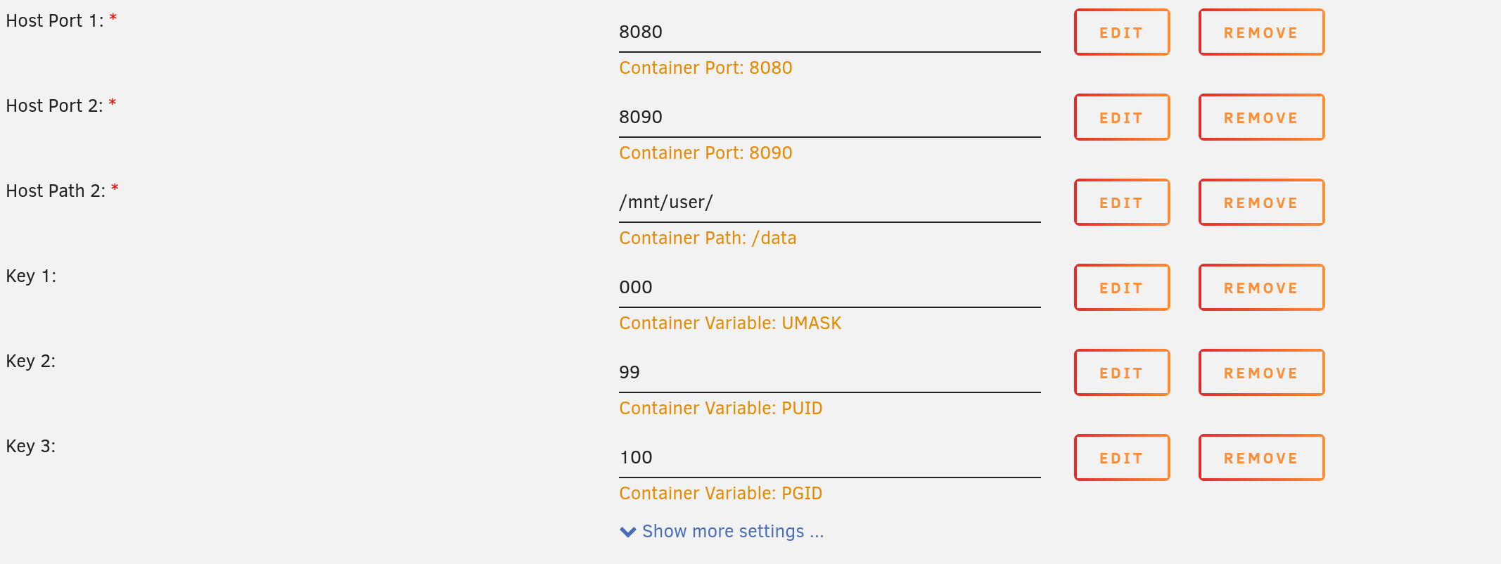

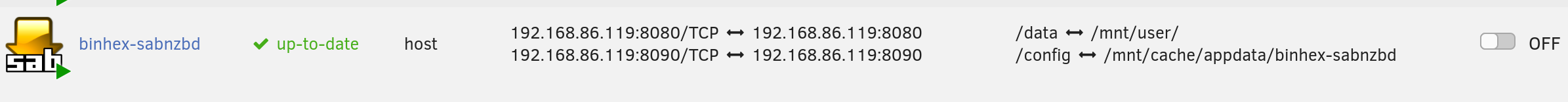

bonienl here you go, thanks for taking a look, I have spun my wheels on this for a while!
Details about my network: ATT Uverse Gigapower Fiber -> Hardwired into DMZd Google WIFI where all it goes into a switch to the rest of the house, and the wired devices (including unraid) and wifi. All machines including UNraid (plex docker) are functioning as expected.
Edited by ruthlessone
add network details
The container is set to use the host network, which means it is directly accessing the interface, similar as Unraid itself. When Unraid has network/internet access so should have the container.

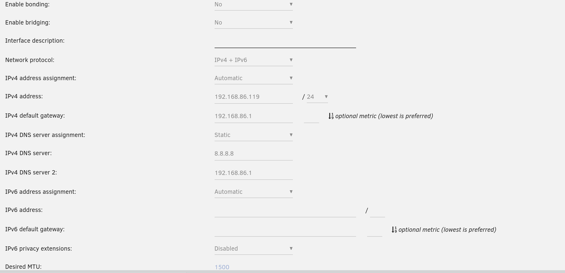

Here you go!
I don't see anything wrong in your network settings.
A minor thing, you have enabled IPv6 but your router is not giving out IPv6 addresses, though this should not be an issue.

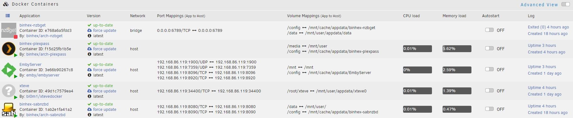

This is my setup. Not sure why it isn't working thod2384126fc38d7c1851c8375dd7f0326.jpg

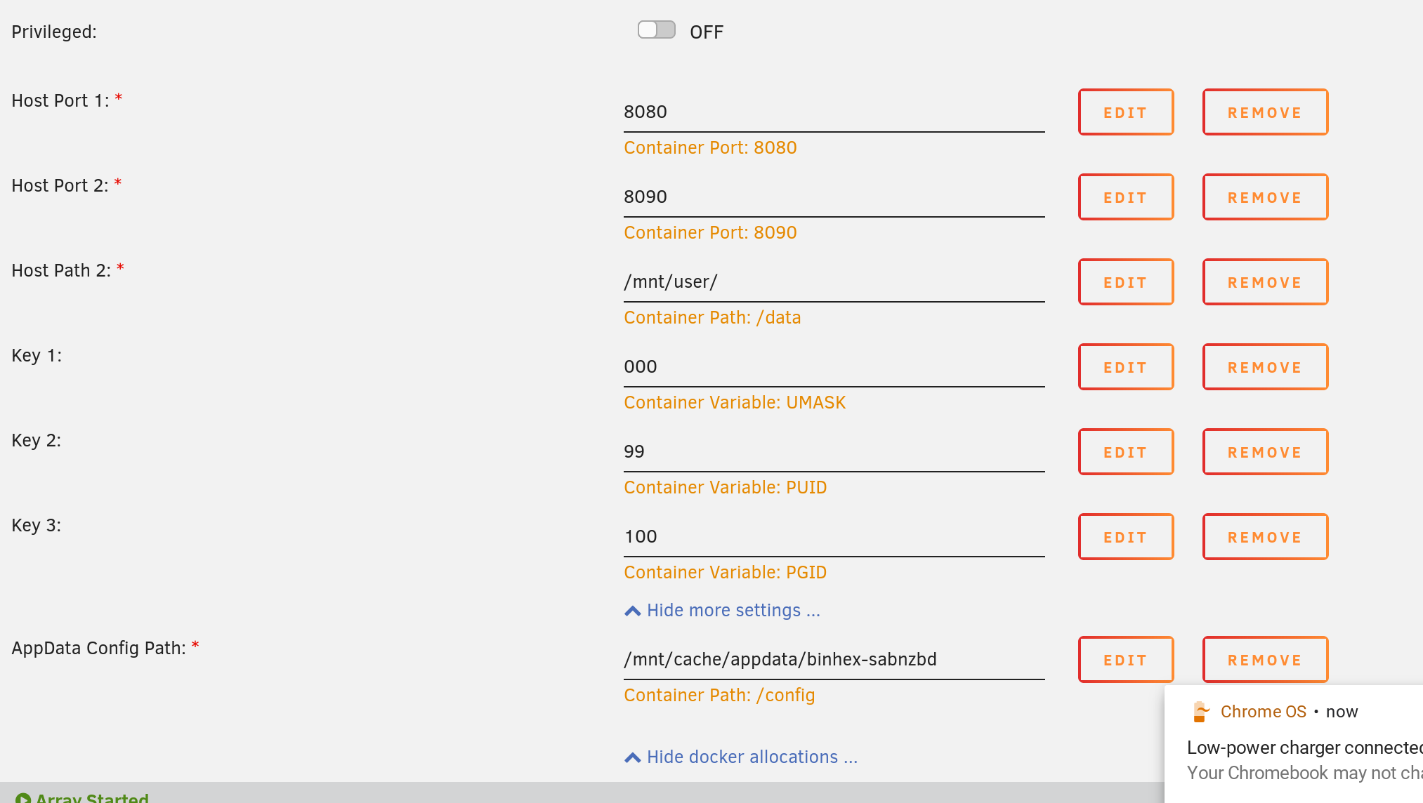

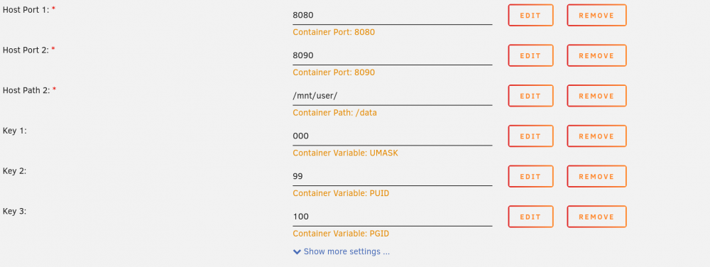

Do you have the "--dns" parameter set for this container (see extra parameters field in advanced view) ?
I don't, see attached, what should I have in there?
16 minutes ago, bonienl said:
Switch to advanced view
I expect no DNS setting here (extra parameters)
Here it is in advanced view, Umask? Doesn't seem to be any DNS entries. I can add, just need to know what to fill in.
