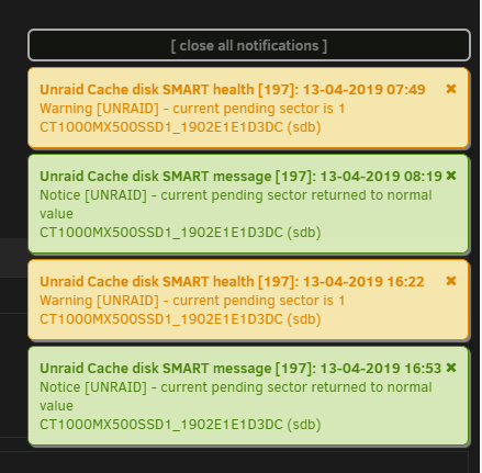

Keep getting Current pending sector is 1 warnings (SOLVED)
Every day I get current pending sector is 1 warnings but after some time it returns to normal
I have checked the smart report and it doesn't seam to show
Could some one please advise me how do I fix this so as not to keep receiving the warnings?

You can turn the reporting of that Attribute off for just the cache drive under the Device properties for that drive only (  Main  tab, click on the drive you need to modify under the Device  column)
Interesting, have exactly the same issue here with my 1tb MX500 cache drive
It'a known issue with the MX500 SSDs:
