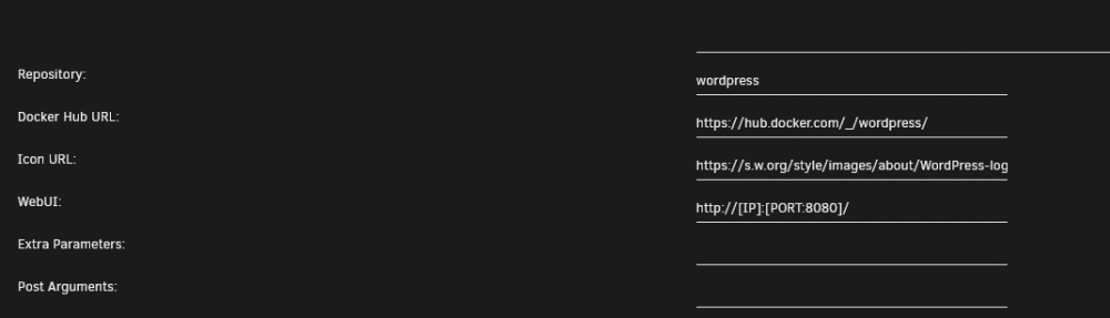

  1. Having some issues updating the container. It says there's an update but it doesn't pull anynthing. When looking and the template I notice there's no repository adress, is this correct?

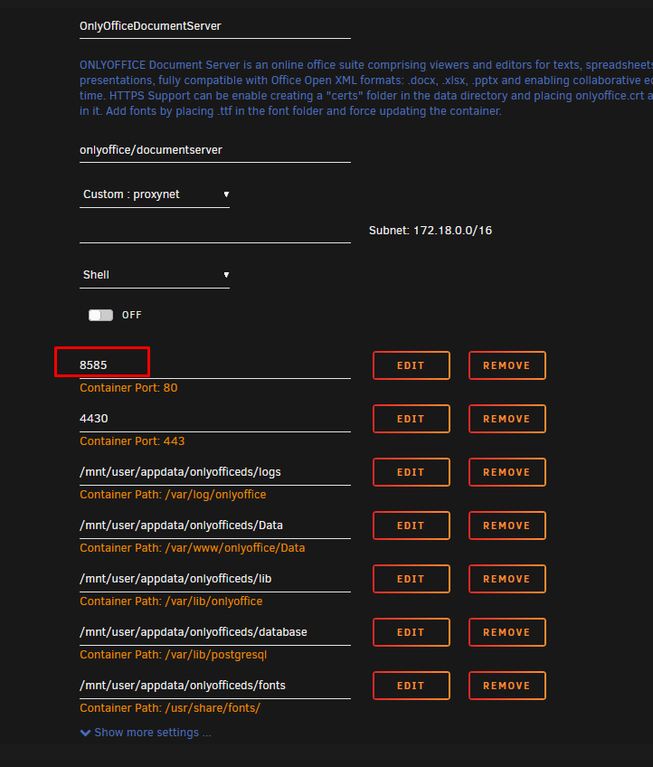

  8. Everything is left unchanged like in ED's guide except I have changed Host port 1 and the network which is set to use my Let's Encrypt proxy network like in ED's guide
  9. Hmmm ... there is actually no such thing that I can find. The configs I know of is the Letsencrypt proxy config, the docker template in Unraid. Can you point me in the right direction where I can find what you are looking for, thanks?
  10. Thanks but it didn't work, why should I remove this folder?

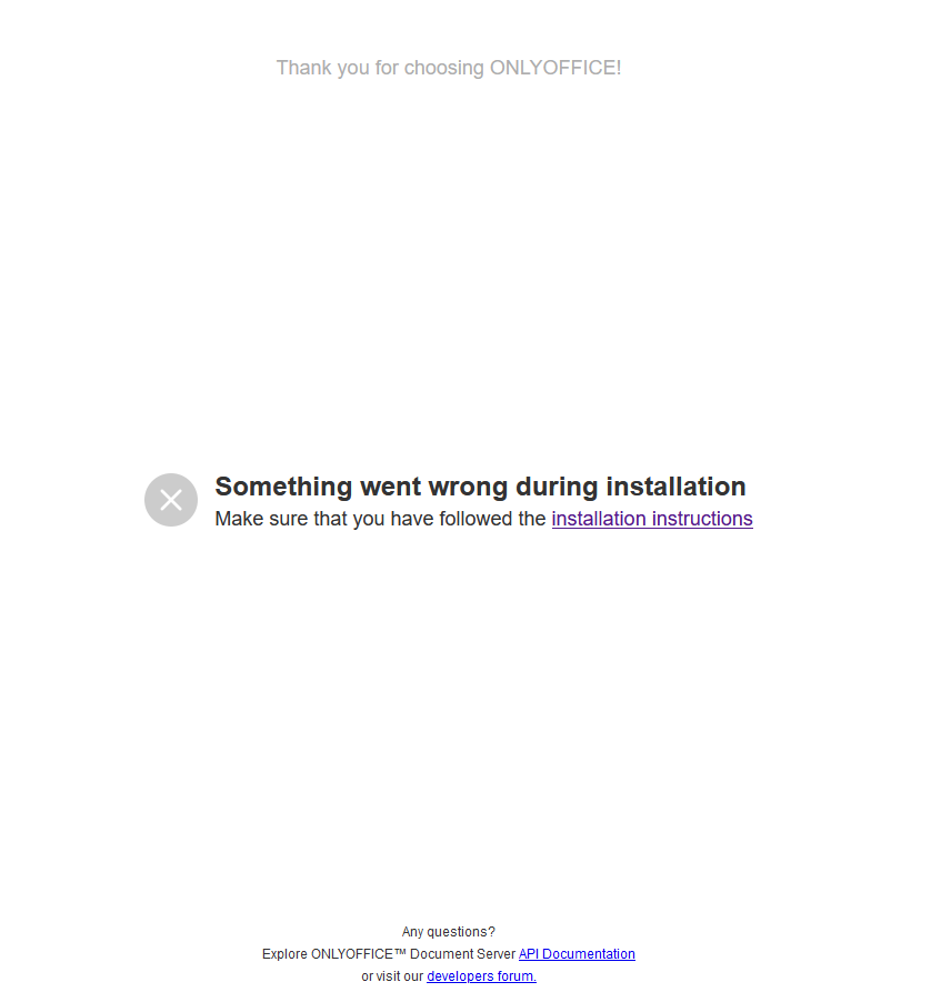

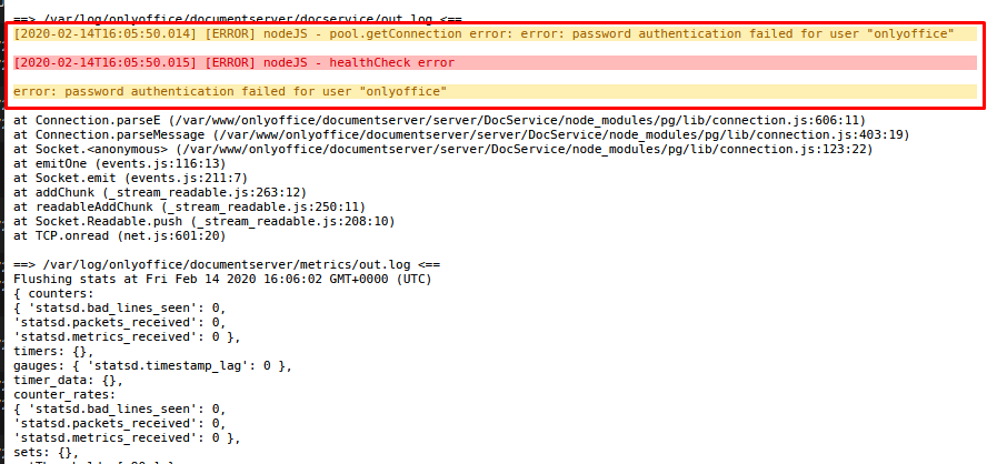

  11. Have followed Spaceinvader's guide here to setup OnlyOfficeDocumentServer but the container seem to malfunction, when I https to it via my web browser I'm greeted with this: And the logs: Any ideas?
  12. Have followed Spaceinvader's guide here to setup OnlyOfficeDocumentServer but the container seem to malfunction, when I https to it via my web browser I'm greeted with this: And the logs: Any ideas?
