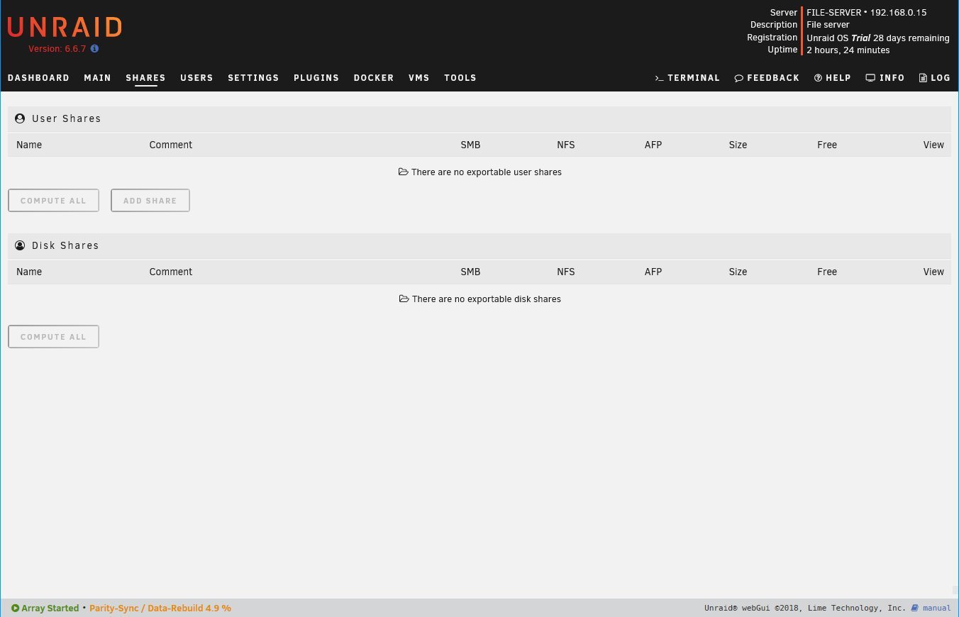

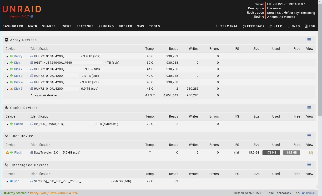

Attached are two screenshots: one of the main/ screen, showing drive 6 being rebuilt, and one of the shares/ screen, showing everything greyed out.
Perhaps I don't understand shares. According to the youtube video, you just click [Add Share]. Help!
It's probably greyed out because a parity sync is in process, when the drive is rebuilt you will be allowed to create a share. I've never noticed this before, so I am just guessing, but it makes sense to me.
Those screenshots seem to indicate none of the disks have been formatted (nothing in the FS column), so there is no place to create any shares.
If you think that is wrong post a diagnostic.
When you insert a new drive, a [Format] button appears near the bottom. I can't remember the exact wording of the button--I only did it once for each drive. But I remember that it defaults to 'xfs' and that you need to get through that step before moving forward. But, logging in as root, I don't see any of the drives mounted. In Unraid, are the drives mounted as normal under Linux? What's the expected behavior of an 'ls /' or a 'cat /etc/fstab' or a 'ls -l /dev/disk/by-label'?
Edit: the mystery has been solved. Somehow Unraid was operating in Maintenance Mode during the rebuild.

When you [Stop] and then unclick the [x] Maintenace Mode checkbox (which doesn't appear during the rebuild), and then re-start, the file systems reappear. Another UI gotcha--there should be far more feedback if you're in MM, like "DRIVES OFFLINE - MAINTENANCE MODE" under all of the columns to the right of the drives.

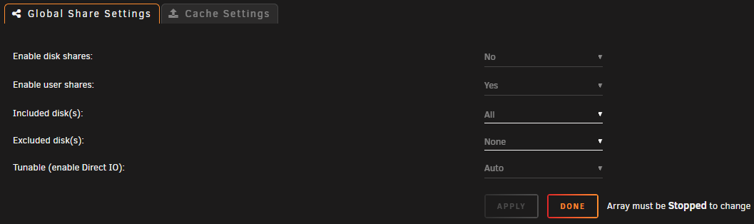

FEATURE REQUEST: Under Shares -> Share Settings, show more information about the drives rather than just "Disk 1", "Disk 2", etc. This includes the Included Disk and Excluded Disk, as well as any other areas in the product that use the same subroutine. Failing this, the user must open a new tab on the browser (to Main) to figure out which drives numbers are associated with which drives.
Drives need to be identified, at the moment of input into the form, by the drive manufacturer or drive type or size, etc. "Disk 1" is nondescript to a human. But "Disk 1 - HGST - 9.9TB - *GJ9B" indicates that it's the Hitachi SAS drive, the big one, whose serial number ends with GJ9B. Yup, that's the one.

BUG REPORT (Minor): In Shares -> Share Settings there is no help for the two settings, "Read settings from" and "Write settings to". What do they do?
Suggestion: have an intern or moderator go through the product, screen by screen, and make sure that every setting has associated help.
Edit: See the post, '"read settings from" "write settings to" what is this?' The lack of help / feedback for these settings has already been noted.
Edit Again: apparently these settings act as a type of "like this", in which case they should be called, "Set the share up like this / copy the share settings from", and "Remember these share settings / save the share settings to be used again, later."
The bug is actually that the help is not properly linked to the text field.
Turn on global help on that page to see the explanation.

He was actually talking about something else but his wording was misleading. He thought he couldn't add any shares because of the rebuild, but it was actually because he was in Maintenance Mode.
The screenshot you gave there has been that way for as long as I have paid any attention to it.
Might be something there though it might also be a little difficult to get the serial numbers to fit in the UI elements for include/exclude. And, those settings are really about the slot, and not about the disk in the slot. If you replace one of those disks, or even just rearrange the existing disks, the setting still applies to whatever disk is in the slot, and not to a specific hard drive.
