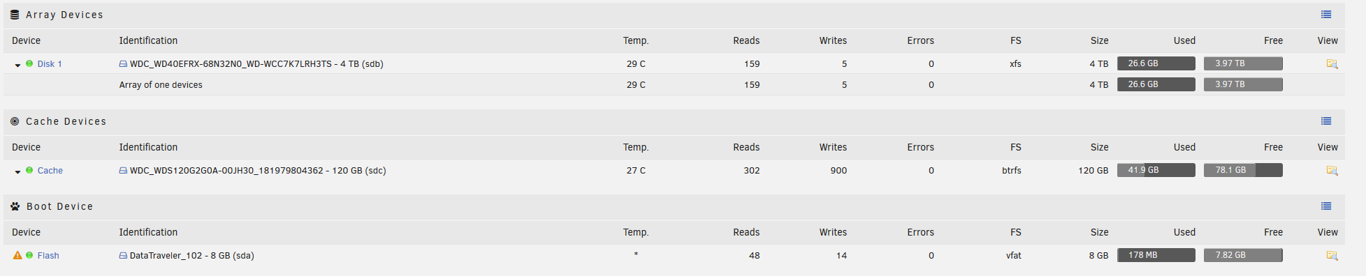

I just installed Unraid and I have two WD Red installed, first part of my problem; for some reason they are showing as one drive and I cannot figure out how I seperate them. Will this course problems down the road? I assume it is not ideal but I cannot find a way to deal with it. second part of my problem; the two drives showing as one disk is called Disk 1 and then I have a ssd for cache which shows just fine in the "main" tab, then when I go to shares I have called my Disk 1 called Storage and it should reflect the size of Disk 1 but it doesn't it shows the ssd in size, so I clicked on it and you can include or exclude drives but it doesn't change anything. Then I tried to turn off the cache ssd and then the Storage folder also disappears, which is wierd.

They are both 2 TB drives

WD40XXXX is a 4TB drive, a 2TB would be WD20XXXX

Ha. I don't know what to say other than after opening the box you're correct, it is one 4 TB drive. Which of course makes me happier than two 2 TB if I ever were to upgrade and use different raid options... anyways lol! Btw in the builders defense he did put it together like a year ago and had it sit in a closet :)

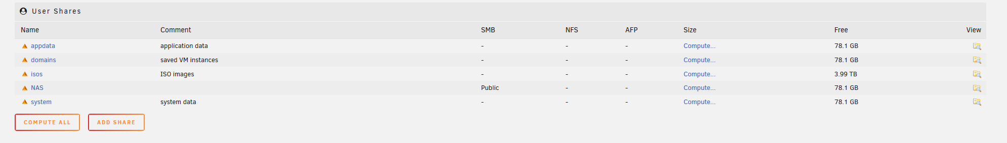

I still have the problem of Disk 1 not showing as the storage for my main share named "nas", it doesn't seem to care if I include the Disk 1 or just use the all option, the only thing that did change something was when I turned off the 128 GB SSD then it disappeared, which it shouldn't. I tried to unmount Disk 1, but no luck.

What do you mean not showing? If the options to include cache were ticked before changing and you had wrote data to this share there will be data stored on your cache drive. To move this install the unBALANCE app from Community Apps to move the data. Once it is moved the small ! icon should disappear as no files are stored on cache anymore for that share - Link below gives a small explanation about excluding disks

It just finished with the preclear but it still doesn't show the capacity in the free bracket
It's really not problem but it looks like the share (folder) dosn't yet exist on disk1, copy something to it or change the share to cache="yes" and run the mover.

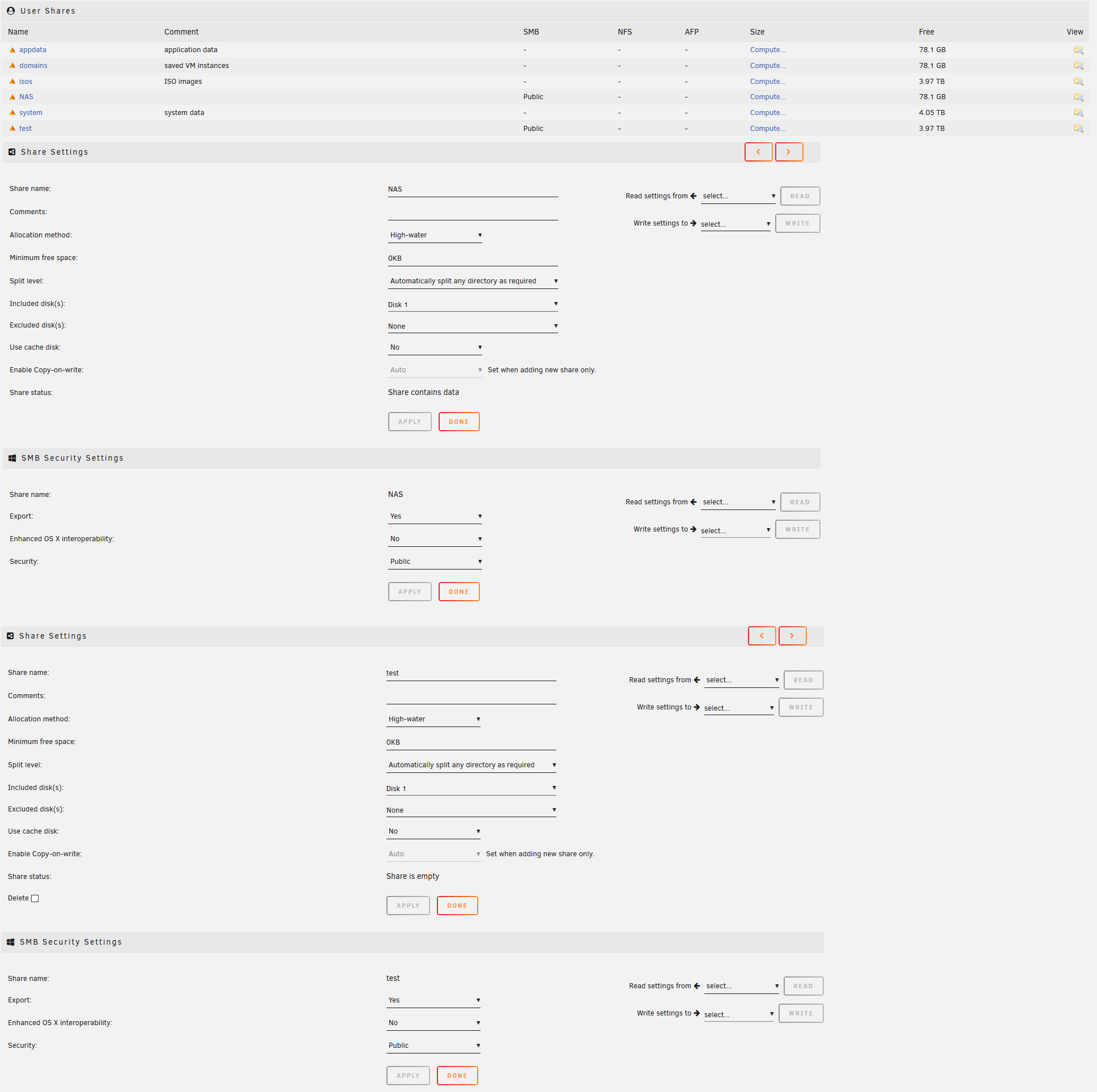

I removed it from the array, and precleared it. that took a while, then I added it to the same place again (unraid tells you that a disk is missing). then I started the array again and added it to the shared folder and that is when the screen capture comes in, it should show 4 tb more than it's.

It seems to be a problem with my cache ssd, I stopped everything and remounted the 4 tb hdd to disk 2 instead of disk 1 and that didn't do anything, then I mounted it back on disk 1 and so everything was as when I started.
I removed the cache ssd and that did also remove the folders, and then I remade the shared folder with on the hdd active, two things;
it worked and I could see the 4 tb as the shared folder, secondly I then attached the cache ssd to see what would happen and now I could see the folders have 4.05 tb of capacity, so I guess that is the ssd and some wierd rounding since it is 128 gb, without the ssd cache it said 3.99 or something.
but I'll just try a different ssd I have quite a few, a KingDian whatever that is, a few of the cheapest 128 mb Kingstons one Intel and one SP I think that's Silicon Power.
Oh just thinking about what ssd I have in the NAS right now, it might be m.2, could that be making problems? as I don't know what hardware is recommended with Unraid
