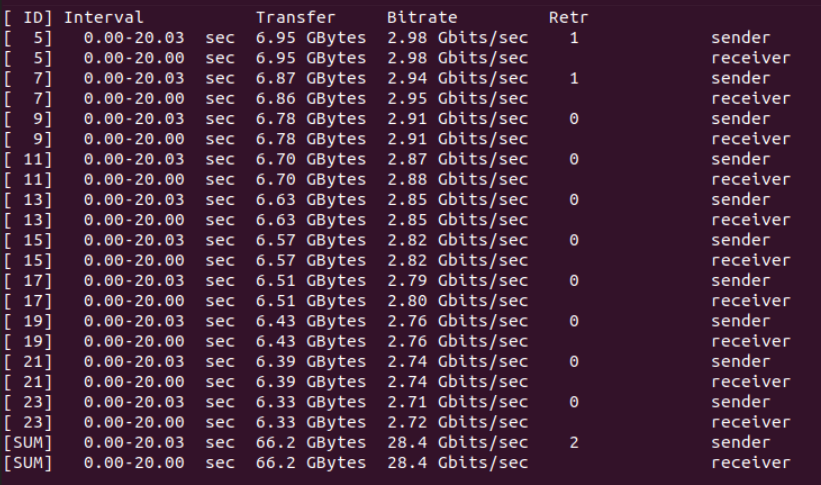

Out of interest I made a test between my Ubuntu 19.04 server VM (10.0.104.11) and my Ubuntu 19.04 desktop VM (10.0.104.12).
I use parallel TCP sessions to maximize the throughput. This is the command used at the desktop side.
iperf3 -c 10.0.104.11 -i0 -t20 -P10 -w400k -R
Since both VMs are on the same host, there is no true network limitation and performance is more determined by the VMs themselves.
The Ubuntu server maxes out at 28.4 Gb/s on my server and shows the driver is capable of handling very high speeds.
