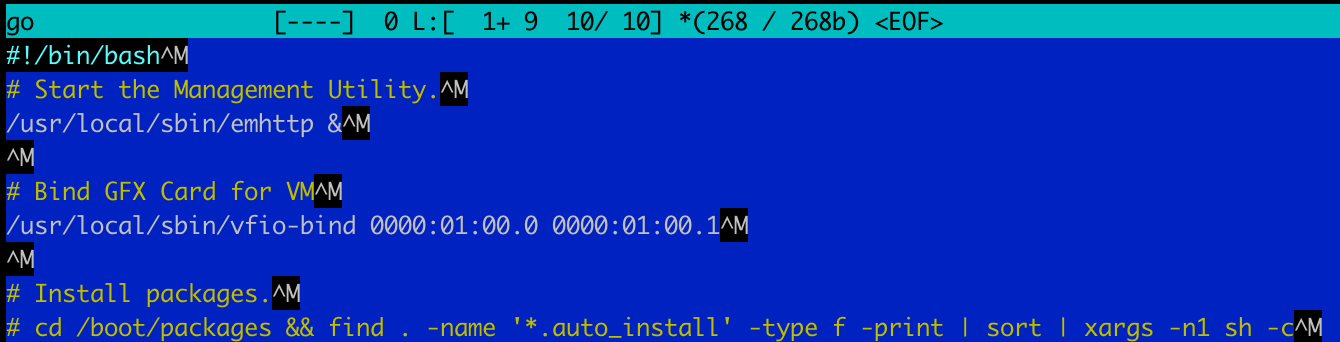

Did you try my earlier suggestion to start in safe mode and also comment out the packages installation?
Something has borked your system, need to find out what ...
Tried safe mode early on and it didn't make any difference it seems. How do I properly comment out package installation when going into safe mode?
You need to edit the 'go' file and comment out the line I highlighted (not sure which packages are installed though). A reboot is required afterwards.
Trying that now... even though there is no /boot/packages/ folder anyways
no luck - same issue in safe mode with all plugins disabled.
