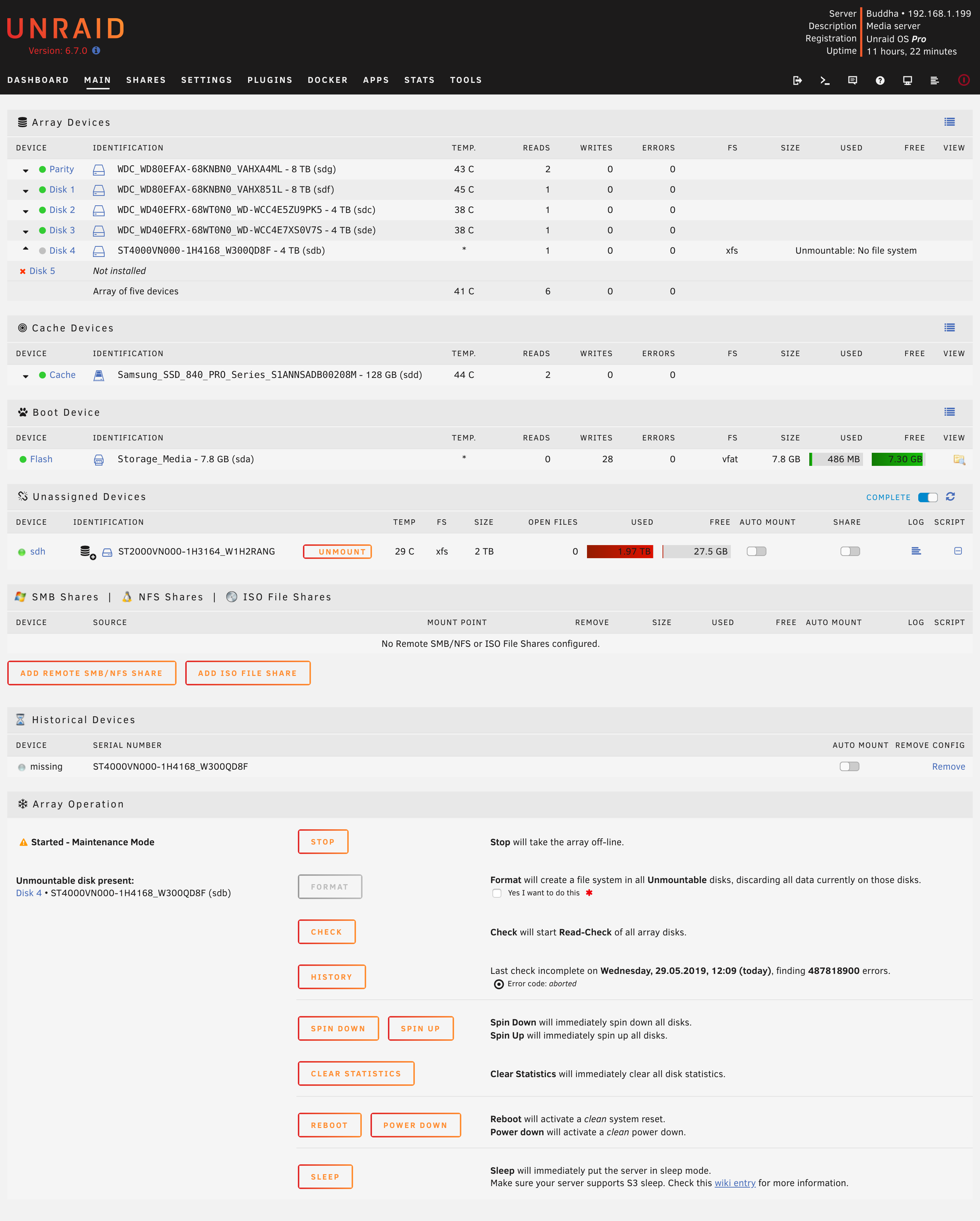

So i keep going farther down the rabit hole.... i took a camera shot real quick before i started this step...IMG_20190529_103442.thumb.jpg.a41c532dfcc414f4ecad6abae7ddb7aa.jpg
I started the parity check swapped out disk 5 for the old 2 tb (this is before i went to replace the parity drive like you said)....
but in any event the array is running in maintenance mode and now it's telling me there's no file system on drive 4....unraid.thumb.png.edf5bddaba234218d63bd532c220732b.png
thoughts?
There's no filesystems when running in maintenance mode, though not sure why it's only saying that for disk4, but since you started the array without disk5 you can't rebuild it because parity is valid, you'll need to do a new config, and for starters assign only the data disks (and cache), leave parity unassigned, start the array and check all data disks mount OK.

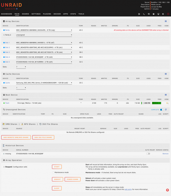

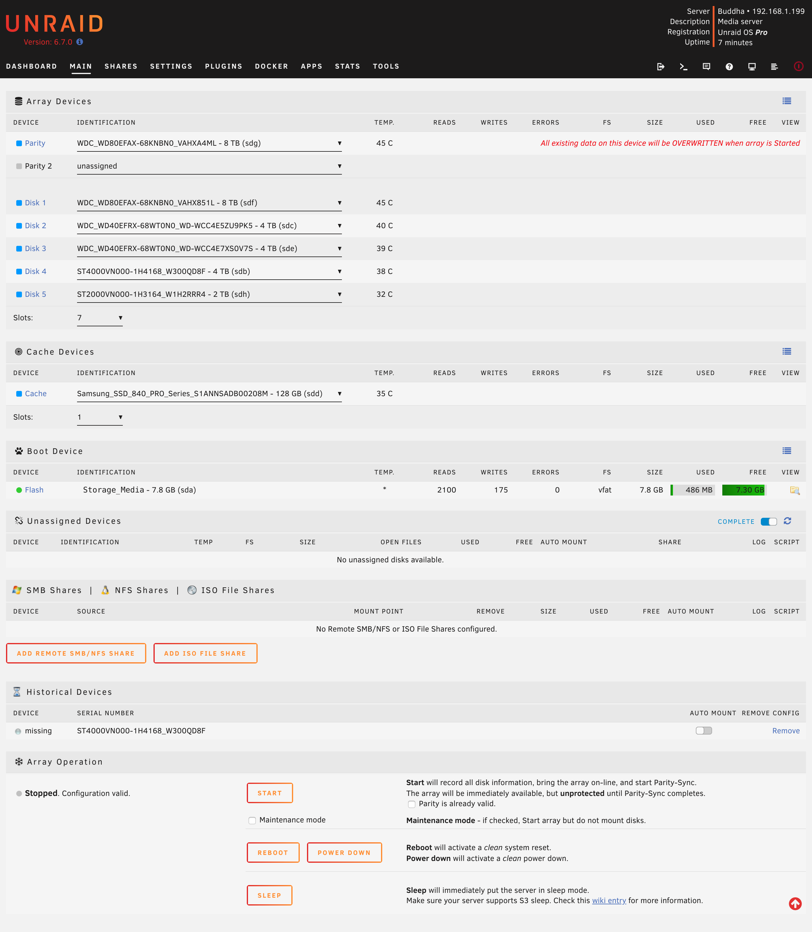

okay so here's how i set it up this time: am i ready to turn this back on and let the drives sync?
just to be clear - the 8 tb parity drive was properly rebuilt.
disk 1 is empty (and should have data contained on a 2 tb drive sitting outside of the.
disk 2 was never touched (other than being relocated)
disk 3 was never touched (other than being relocated)
disk 4 is the old parity drive that i replaced in the array (up from 2 tbs)
disk 5 was never touched (other than being relocated)
by relocated i mean just moved to a different slot in the case and then given a different disk number in unraid.
so am i ready to hit start?1108021820_unraidcurrent.thumb.png.1779faa28b84163b72f911d11c025e26.png
Since parity is already out of sync and there are no extra ports, I would recommend to unassign it for now, start the array, all disks should mount correctly, then connect old disk instead of parity and copy the data from it to the array, when all is done reconnect parity and sync it.

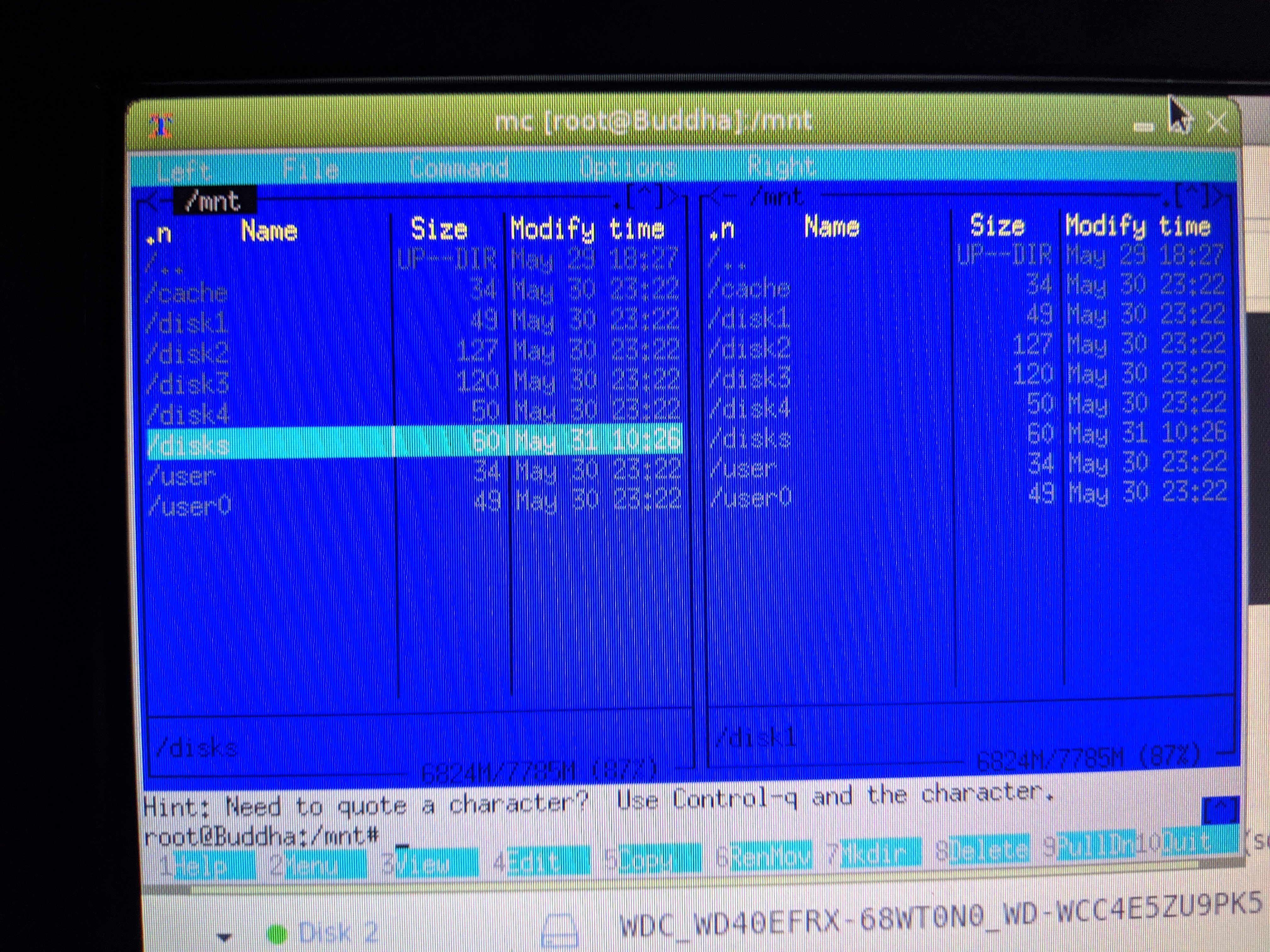

okay - so - i unassigned the parity drive, removed it, inserted the 2 TB drive, started the array, ... restarted the computer, and mounted the 2 TB drive. Since the drive mounted - it sounds like it means i indeed have the correct 2tb drive. okay so then i launched MC via the start menu and read
amongst other things.  however, as you will see from my setup - i don't see the drives listed - only directories. i want to copy from the unassigned drive to the drive in disk 1 slot but can't figure out how to get that to work ...as in my reading i was told you can only copy disk to disk and share to share. here's a screen cap of the drives. Also notice how it says one of the drives is unmountable? I dunno what's up with that. and if i stop the array it tells me disk 5 is unmountable not disk 4. Meanwhile, just to make sure - you mentioend that a disk won't mount if it's duplicated already and since the unassigned drive mounts - does that confirm that i'm using the right drive?IMG_20190530_231309.thumb.jpg.cd2d07a633969168bfb2bcd1d2a6b82f.jpg
Edited by helpermonkey
Just type "cd /mnt" in prompt, then you would see "user" and "diskX" share directory. Remember don't perform any disk <-> user operation.

So so while I wait for the new card if i move down the tree disks displays the directory as the identification info for the drive (aka ST2000VN000-1H3164_W1H2RQHS). so should i copy /mnt/disks/ to /mnt/disk1/ or should i copy the directory one layer down?
