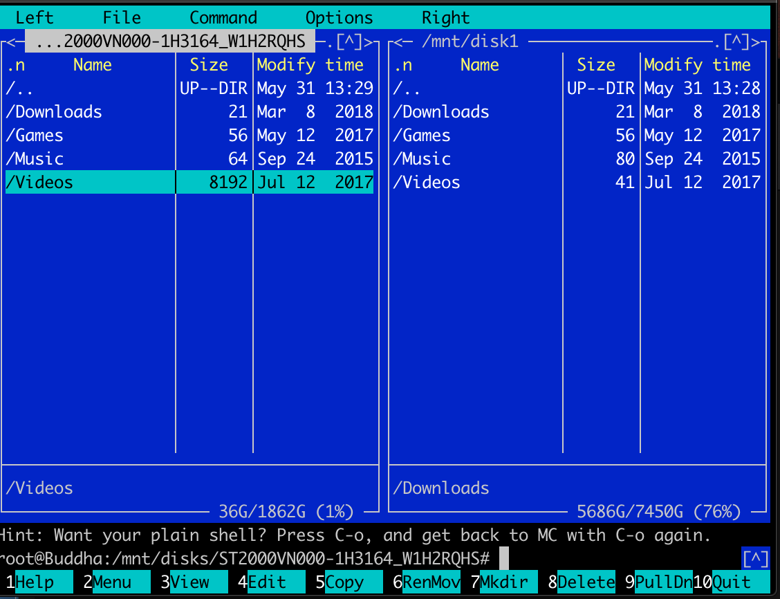

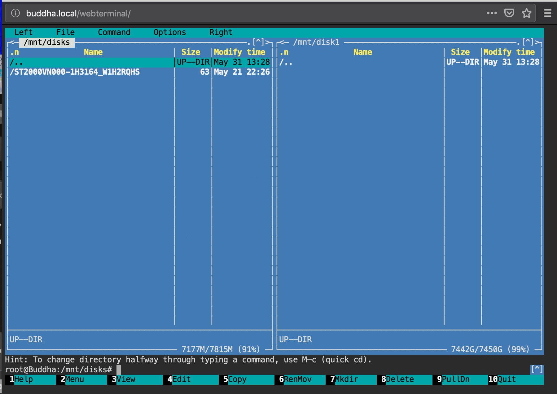

so i loaded up MC navigated to the disks directory and the disk1 directory .... and went to copy by using F5 but it doesn't seem to do anything. I tested in another directory using F8 to delete and that worked like a chanp... what am i doing wrong?26823376_ScreenShot2019-05-31at1_37_30PM.thumb.png.1fc459e8f7611500fffb33e1dd71e52e.png
You need to open the ST2000XXXXX folder, but in some cases the function keys don't work correctly when using the built-in terminal, if that's the case use Putty.
So I SSH'd in and copied the directories ... when i came back to it finished the directory sizes don't match.... the drive on the left is the 2TB and ther drive on the right is the 8TB.
Should I just delete the music and videos off the 8tb and try to recopy them? or is this good enough that when i put back in the parity drive and start the array that unraid will figure out what's missing from where?

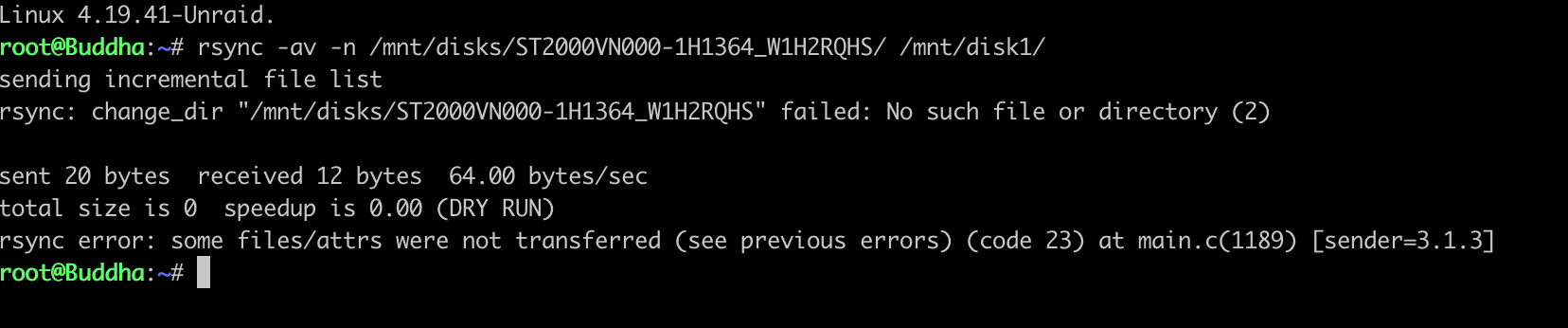

Looks like i got some error ....
1214232285_ScreenShot2019-06-01at12_59_22PM.thumb.png.db54b2cfb593649ace5a02c3bfe4a26a.png
Could you type " ls /mnt/disks/ "
1H3164, not 1H1364 ...
ha - that would make a difference.... here is the end of the list.....

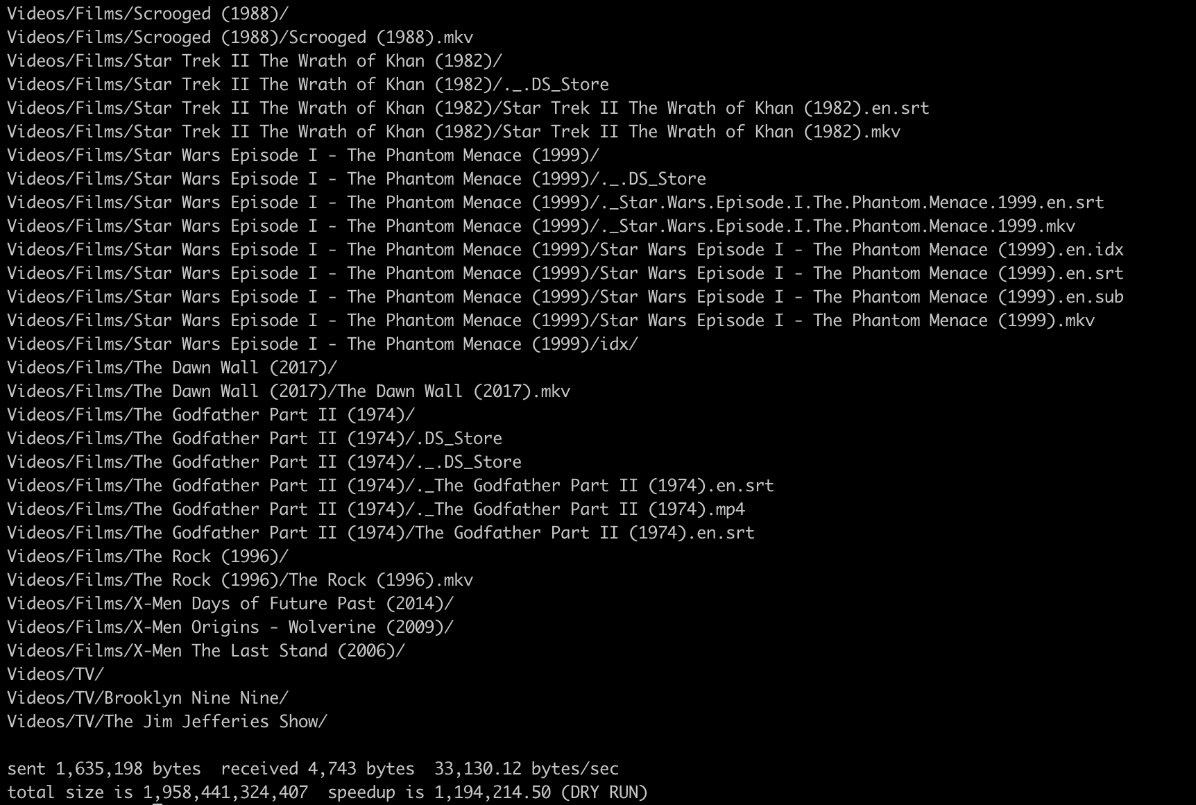

Wait a min
Pls type " rsync -ah --stats --max-delete=100 --delete-before --force -n /mnt/disks/ST2000....RQHS/ /mnt/disk1/ "
Paste text would fine ( not photo )
Edited by Benson

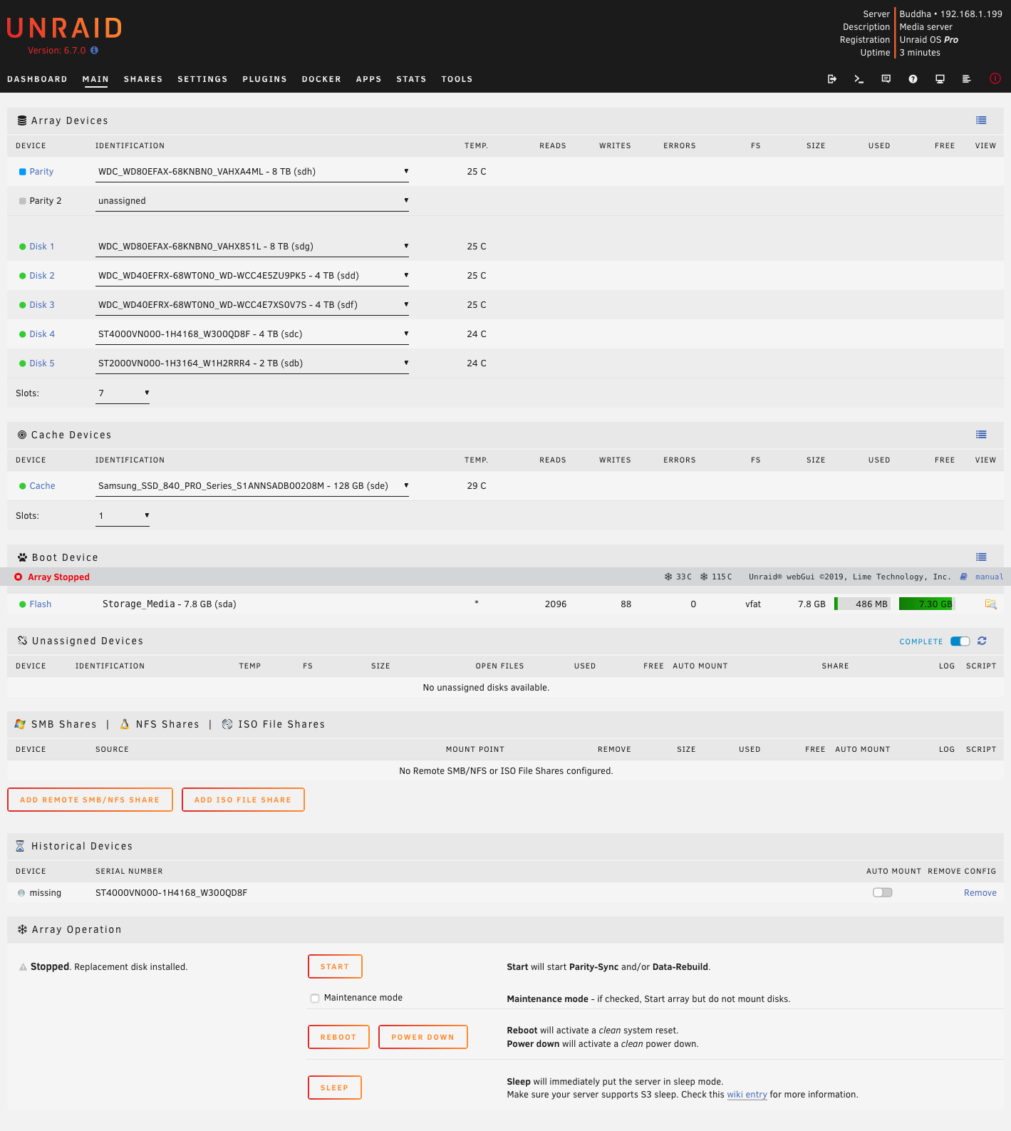

okay guys - thanks so much for your help up until this point. Soooo ... i think i'm ready to fireup the server ... here's the status page...
2105965060_Screenshot_2019-06-10BuddhaMain.thumb.png.ffad9a797c17073da3e32ac9e0f8d596.png

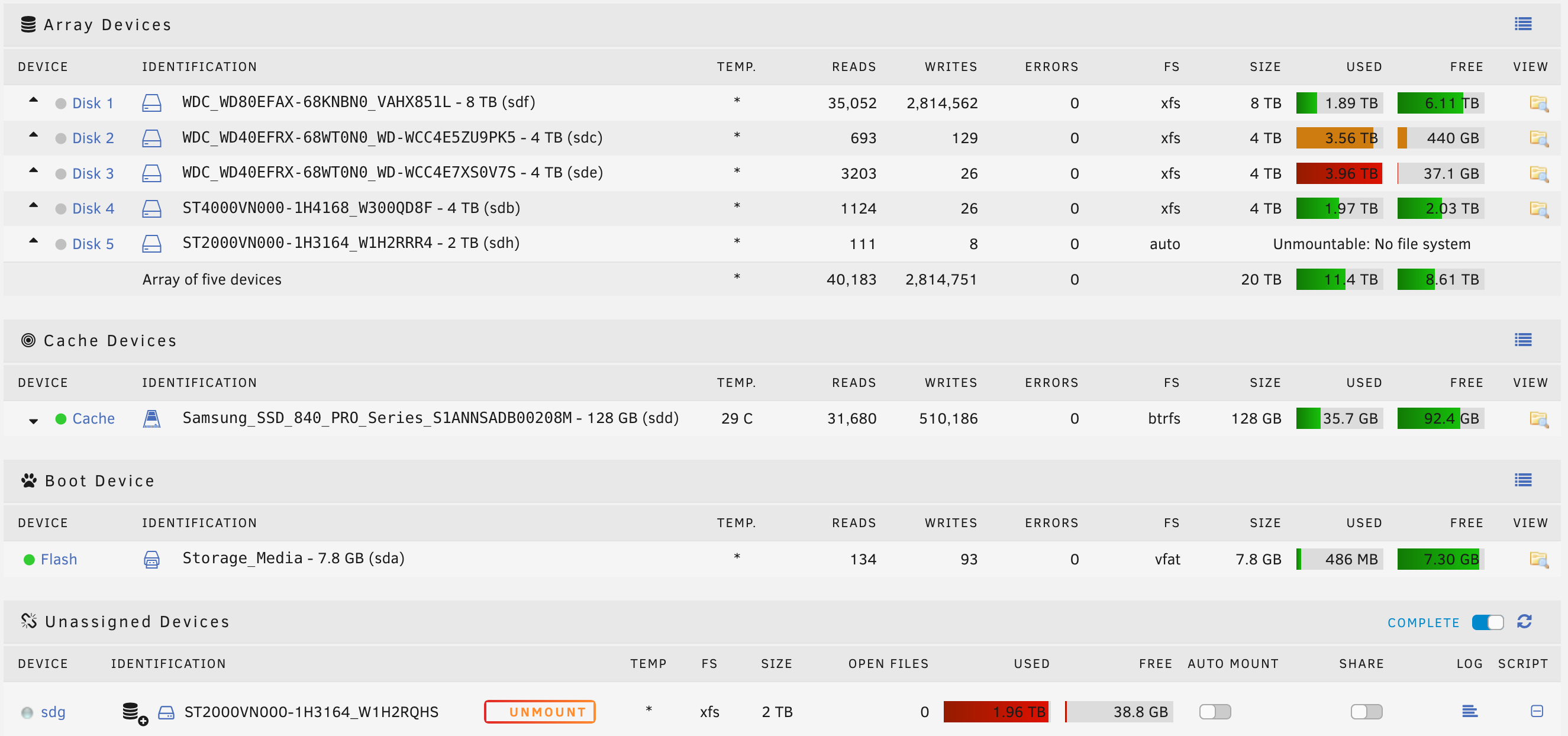

2 minutes ago, helpermonkey said:
roger! and we're off.
and disk 5 didn't mount - it's connected via the card I just replaced.... not sure if that would make a difference. Attached are the diagnostics.
buddha-diagnostics-20190611-1842.zip
it's not 100% out of the question that i put back in the wrong 2 TB drive BTW 🙂
