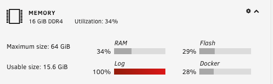

Log shows 100% FUll, Docker Froze, Docker Restart gives 403
Hi All,
I noticed a Docker was not working, so I tried to restart it, and it gave a 403 error.  I thought that was strange enough, so I went to Dashboard to find the Log at 100%.  I can't seem to get the docker to restart, and was going to reboot the whole system but I pulled the diagnostics first.  Is it something where I need to increase the log size on a specific docker parameter?  Or is this a system wide thing?
That is what caught my eye.   Here are Diagnostics.

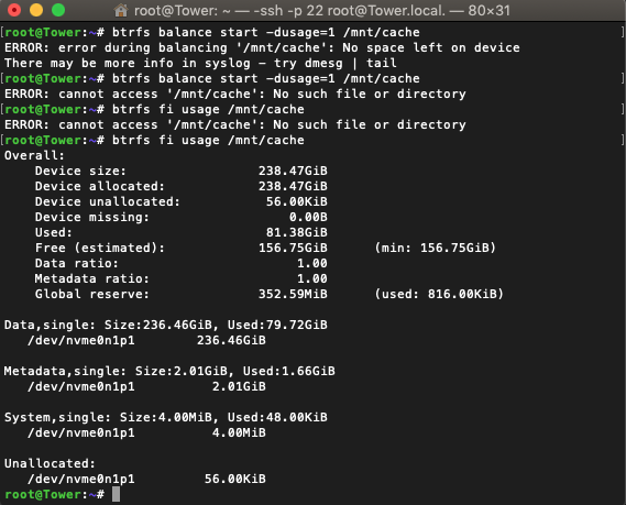

Ok running that now, so this has nothing to do with cache being btrfs instead of xfs?   I read about doing the balance on cache:
btrfs balance start -dusage=75 /mnt/cache
It just came out of nowhere because it was relatively stable past 13 days.  I had some issues few weeks ago but then it stabilized.

The actual problem though is
May 29 18:19:38 Tower rc.diskinfo[5089]: PHP Warning: file_put_contents(): Only 4096 of 7851 bytes written, possibly out of free disk space in /etc/rc.d/rc.diskinfo on line 266
Which is the Preclear plugin going haywire.  Not in a position to look at the plugin, so can't say where it's trying to write to

I can't get that balance command to work either.

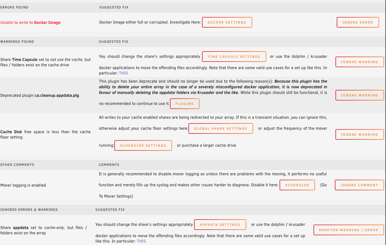

Not sure what is going on, if my docker img is got corrupt because of all of this?
170985696_ScreenShot2019-06-10at1_10_06PM.thumb.png.585a17dce38abeece6c4769b56216ea0.png

It is possible that that there is something wrong with the cache, although I did not spot anything saying so.   There definitely seems to be something wrong with the docker.img file.   The normal way to handle that is:
  • Stop the docker service
  • Delete the existing docker.img file
  • Restart the docker service to create a new empty docker.img file
  • Restore your docker containers using the Previous Apps section on the Apps tab.    This will restore your docker containers with their settings intact.

After it is back, do I need to do that brtfs balance command I have seen when others have 403 errors?

It would not do any harm to do a file system check first on the cache drive as if it reports any errors you want to get that fixed first before trying to fix the docker image.
As to the BTRFS balance I am not sure - I use exclusively XFS so have no experience of this.    My guess is that it cannot really do any harm but may be superflous.
