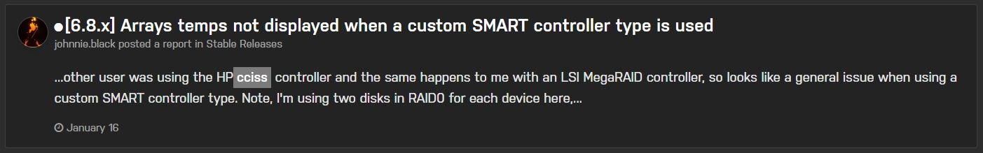

I'm currently facing the same problem, also found another topic in the search results, which seems to be no more existant.
So, this seems to be true for all custom controller types...
And this is really bad, if you use some control mechs, like hdd temp dependant functions to be executed...
If there's no other topic about this problem, do we need to push it to bugs?
