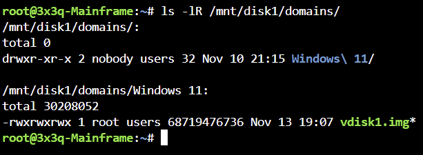

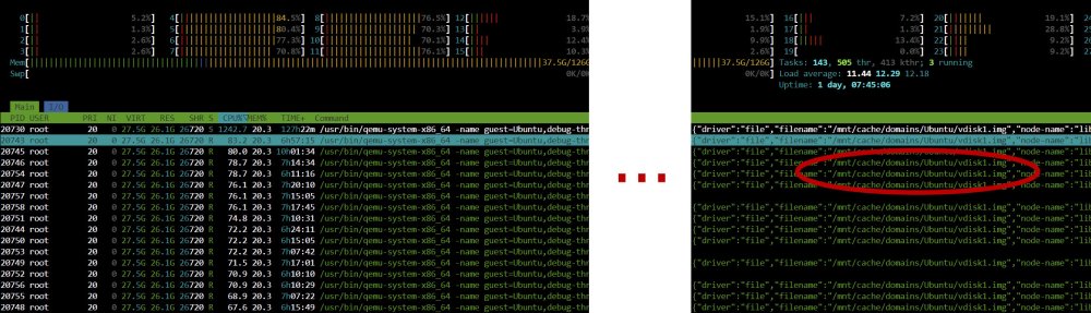

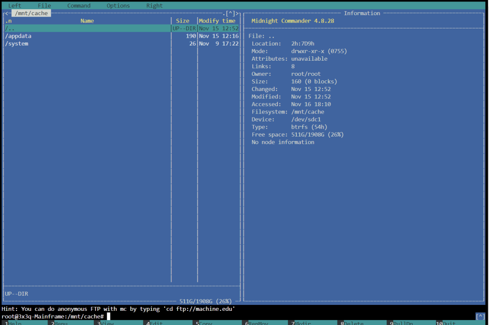

Is it possible that the Mover may have (for some reason) tried to move it from cache to disk and, because VM was running, it messed up the moving process? The vdisk data does not seem corrupted, since it's still booted and running perfectly.
It's almost as if the path to the vdisk .img file has been forgotten by Unraid, and the phantom .img file isn't being overwritten/corrupted by new data because it's still in use.

Right, that's my point. The .img data still appears to be on the cache disk as it should be, but the path reference to that data is gone.
Unless the Mover utility is a flawless piece of code, my suspicion is that Mover for some reason thought it had successfully moved the .img from cache to array and removed the original reference to it.

My VM .img file did not re-appear and the 1.5T space reservation for the .img file on cache cleared immediately as I shut down the VM, just as I feared it would.
I'm sure a file recovery application would have been able to help in my case, since only the path to the file was removed, but the 1.5T size was just too for me to deal with.

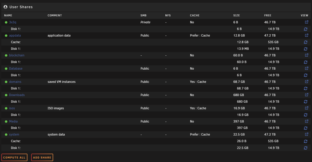

Also a question, why is the mover trying to move a vdisk? By default the domains share is set to cache=prefer, the user would need to manually change to cache=yes, and why would the user do that? Just asking because I don't see the use case, you usually want vdisks to remain on cache, not be moved to the array.
It is interesting that you say this because if you download the diagnostics of the reddit users post I posted earlier on the domains.cfg file it states:
shareUseCache="yes"
I imagine as opposed to "prefer"
Unsure why.
