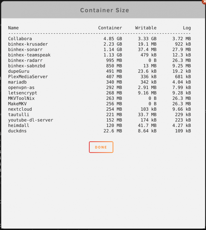

I am trying to pinpoint which of my docker containers is missbehaving, as my docker image seems to grow constantly.
I understand from reading thrue the forum that for most users a 20 GB docker image is plenty.
My docker image is now on 71% utilisation and I got a warnig in the dashboard.
As I do not consider myself special in this regard, I guess something is not working as expected.
I checked the container sizes, and that was the output I got:
2077288734_Screenshot_2019-07-09MorpheusDocker.thumb.png.08dd6134a8a3830c91e978831537b9e8.png
What is the typical size of a container within the docker image?
Collabora and the binhex containers all use way more space than all the other containers.
Expecially the Collabora container seems unreasonable as it is nearly 10 times the size of e.g. the Plex container.
I only use collabora within nextcloud (both setup with the help of @SpaceInvaderOne's youtube video) to have the possibility to write a document in the browser, but the events we really use it are very rare.
Has anyone had a similar issue?
Can anyone give me a hint on the root cause for the dockerimage growing?
What would be the best approach to correct this issue.

The image size depends on which base OS and how big the application and its dependencies are.
You can check the image size on the dockerhub and compare it to the list you have to see if there is a configuration error or something else that makes the image grow.

Thanks @saarg for the tip with the dockerhub.
when I compare the containersizes in my list above with the latest build tags listed on the respective dockerhub pages, than none of my top 6 containers in the list should be bigger than 500 M
I checked my templates of the containers affected and everything that should point out of the containers to the array seems to be configured that way.
What makes me especially curious is what the reason for the teamspeak container being 1 G bigger than expected might be, as there is nothing to missconfigure in the templates (No paths to be linked to the array e.g.)
Also I checked the log file of the collabora container via the GUI and there are a lot of entries (mostly white, some yellow when I open a file via nextcloud), but honestly speaking, I do not understand what most of them mean.
The container itself works as expected.
What could be my next steps to resolve this?
One more question on interpreting the Container Size listing above. What does Writeable mean in that table and do you know why this could be 3.3 GB in the case of the collabora container?

edit: I just realized that the Collabora Container is the only one (besides the duckdns docker) that has no '/config' mapping to the array (the template just does not contain any drive mappings). Is this expected behaviour? Maybe I missed something in configuration and thats the reason why Collabora is exploding!?
Edited by Kevek79
Additional Info
So I deleted the collabora container incl. its image file and reinstalled via template.
Docker image size has shrunk accordingly.
Thanks to @jonathanm & @BRiT for your help in understanding the docker image file a littke better.
