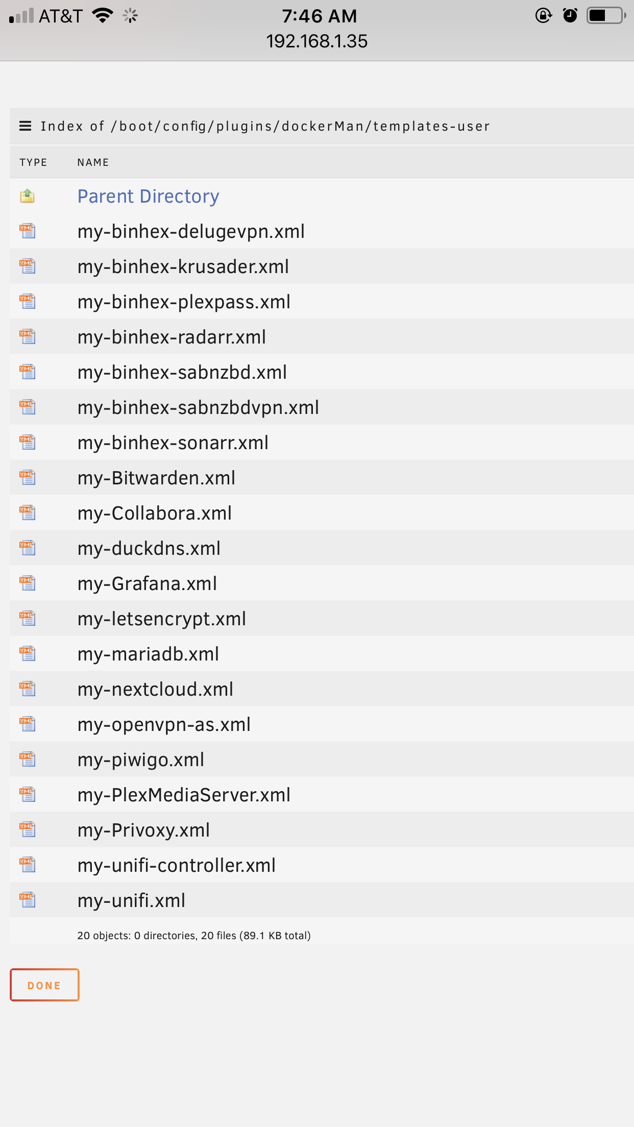

Are there another xml in the folder named identically, but having a (1) at the end?
Sent from my NSA monitored device
thanks for your reply... no, nothing in that directory has a (1) at its end. see the screenshot.

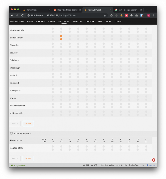

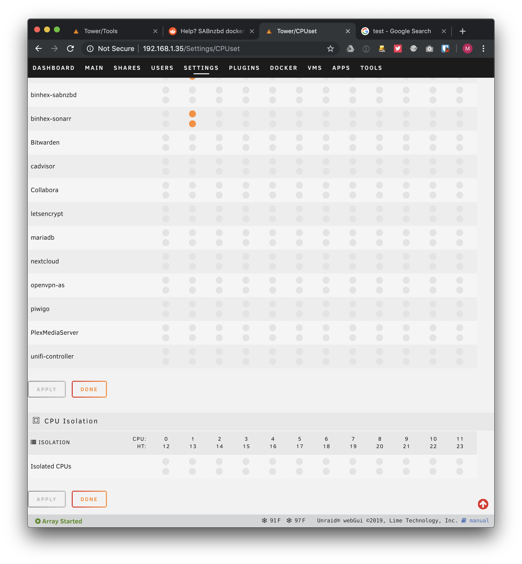

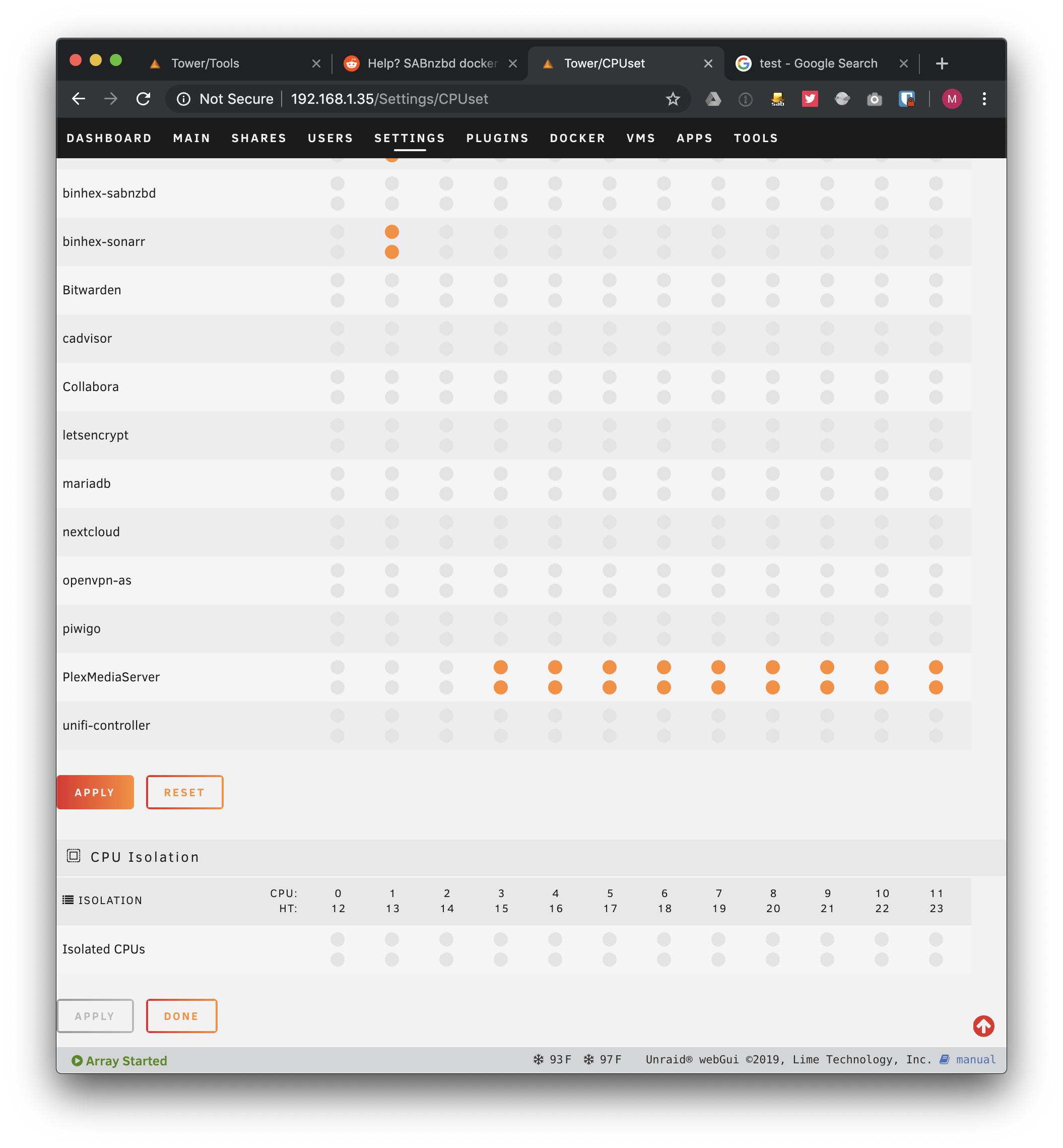

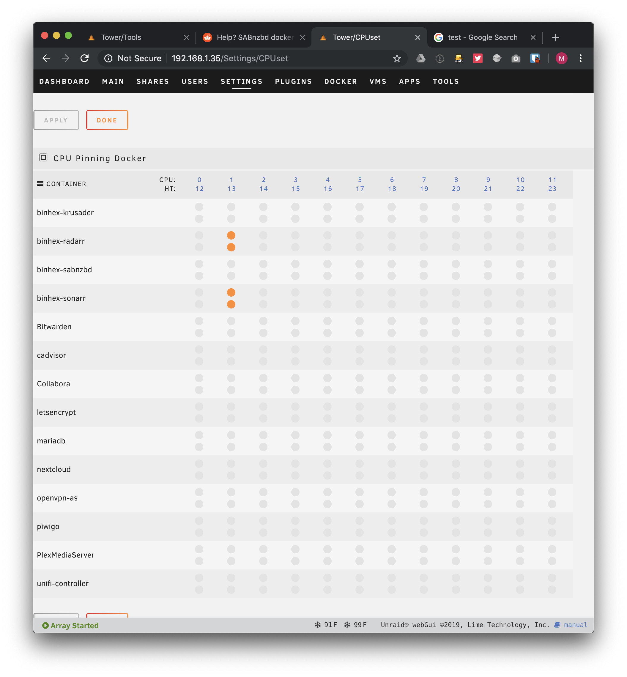

here's my process:Settings > CPU Pinning >
CPU Pinning Docker: Plex (I then select all the cores/threads I want)
Click Apply, then Done.
Reload CPU Pinning, settings aren't saved.
FYI: VM pinning does work correctly.
(I have NOT messed with the CPU Isolation tick boxes yet.)
Thanks again for your time
Edited by lordmarqui
The second last screenshot shows you have set up the cpu pinning selections but have not yet hit the Apply button to commit them.   Are you sure you are not omitting that step?
i'm definitely hitting the Apply button after selecting them. Then I hit Done. Then it exits me out of the CPU pinning window and takes me back to the settings  window. then i click back into CPU pinning and it's as if i never changed any of the selections
Fair enough - just thought it was worth checking in case you were having a blindspot for a simple error.  I do no use that feature so I have no other ideas for what might be causing your problems.

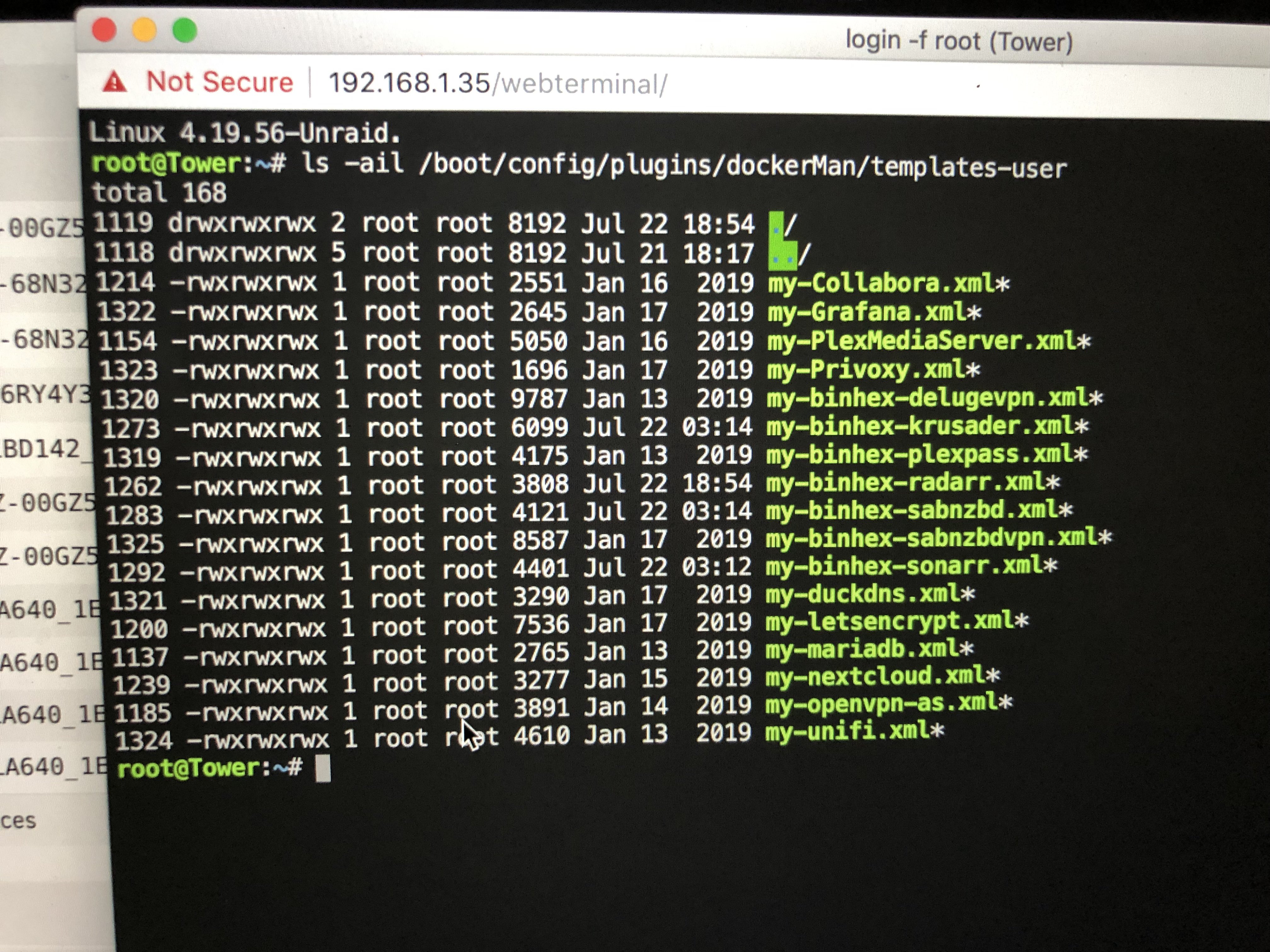

But, since you're running an Mac, can you post the output of this.  I have a thought (and yes I know that is a rare thing ;) )
ls -ail /boot/config/plugins/dockerMan/templates-user
See the attached

I was hoping there were some hidden files in there created by the Mac.  Have you tried pinning the CPUs from when you edit the App?  Switch to advanced view
that worked! ... i am able to pin dockers to specific CPUs using the advanced view of each container but still not via the CPU Pinning feature in Settings...  Not sure why but i don't care at this point!
