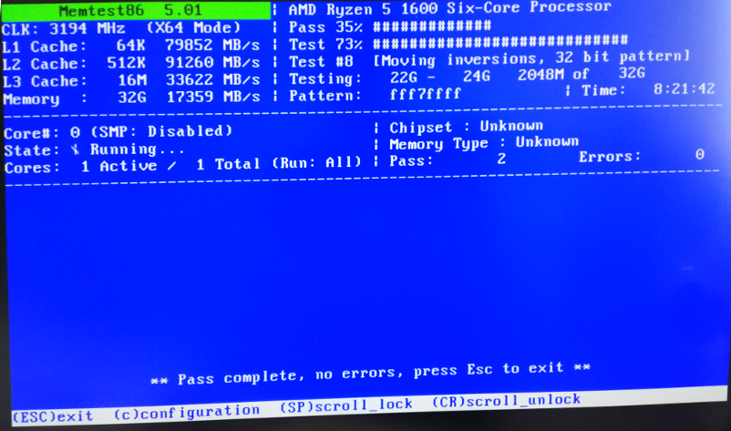

Hello! I'm having a bit of difficulty with a fresh install of Unraid. I have only enabled a Time Machine backup share, the Fix Common Issues plugin and installed docker. No containers running, no additional plugins installed. After about 22 hours my webconsole hangs and I am unable to SSH or ping the device.

  • Memory Test (no errors)
  • New memory (and tested, see screenshot)
