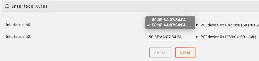

Hello Johnnie, Benson,
@johnnie.black I did that and still have the same look on the UI.
@Benson I don't undestand what you mean. If you are talking about the Interface Rules section, then I can't because all Nics have the same MAC
Edited by PerniciousDuck
Yes, this setion, wried all same MAC and only 2 NIC. Also the 3rd and 4th NIC was eth115 eth116 not usual eth3 eth4.

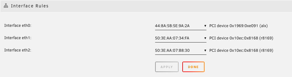

Hello Guys !
Thank you all for your help. I was able to bring the configuration back online.
If anybody stumbles on this post, this is what I did :
  1. Reset the mobo CMOS
  2. Delete the network.cfg and network-rules.cfg
Now the UI shows everything as expected :
If anybody know how to mark a topic solved, am up for some tips :)
