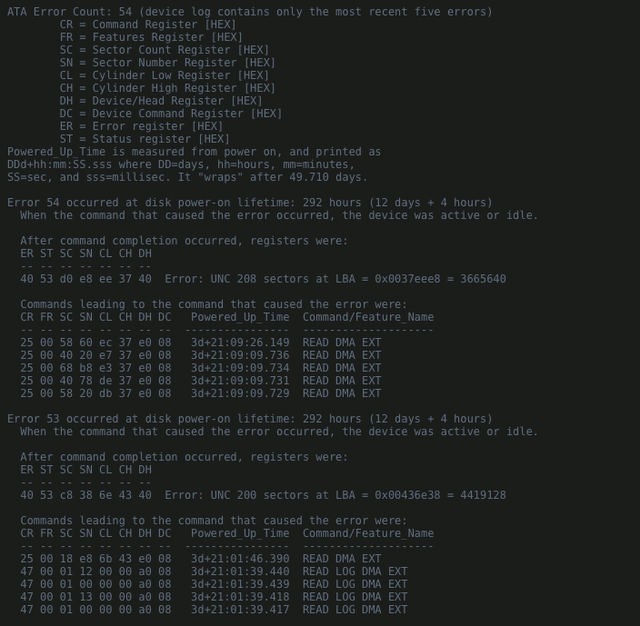

These errors are occurring during parity check:

Looks like a disk problem, you can run an extended test though these type of read errors can sometimes be intermittent.

No, UNC @ LBA are media errors.

SMART test failed:
Num  Test_Description    Status                  Remaining  LifeTime(hours)  LBA_of_first_error
# 1  Extended offline    Completed: read failure       10%       329
You should replace it now.
