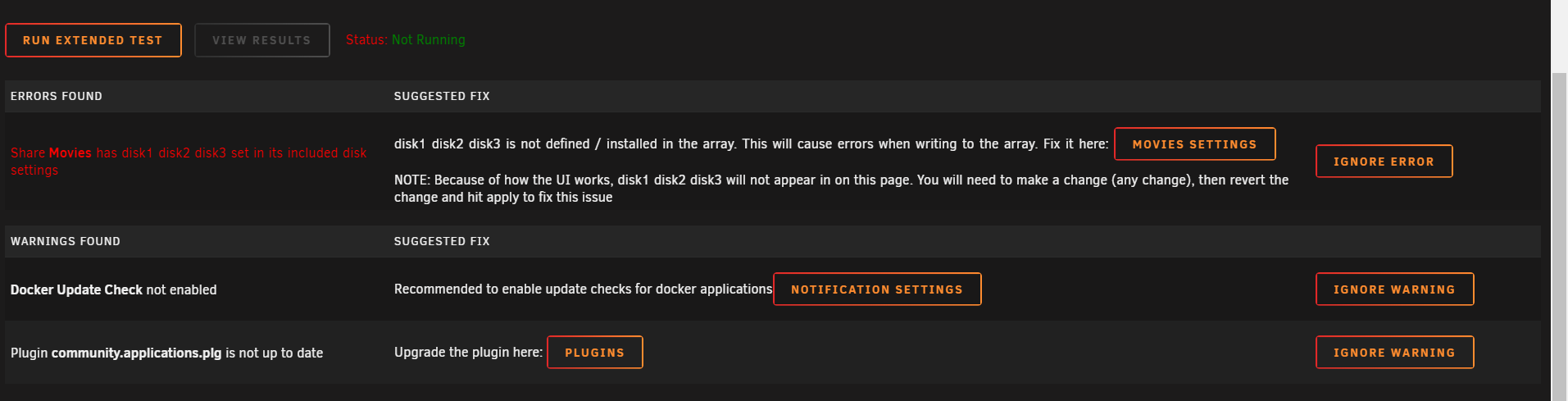

I am getting an error that says 'disk1 disk2 disk3 is not defined / installed in the array. This will cause errors when writing to the array. Fix it here: Movies Settings'.
When I click 'Movies Settings' I see that the included disks are 2,3,4 ( I set disk 1 to exclude in the global share settings).
Should I be concerned about this? My data from Disk1 is now sitting on Disk4 so I am not too worried but I don't want parity to erase anything if it tries to fix anything.
Thanks!
Post a screenshot of the error and of the main tab

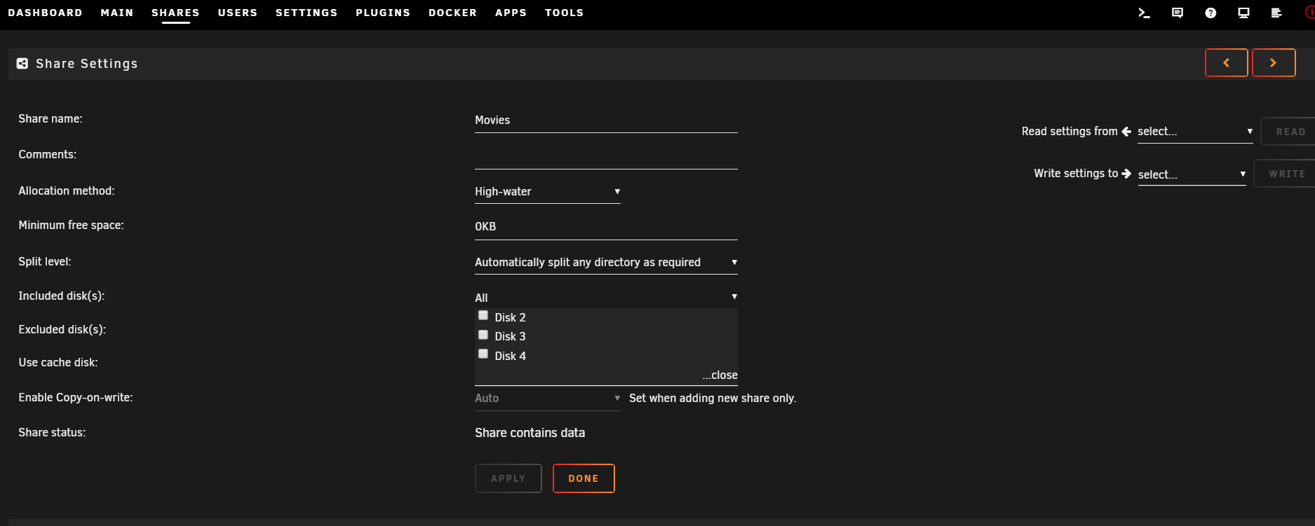

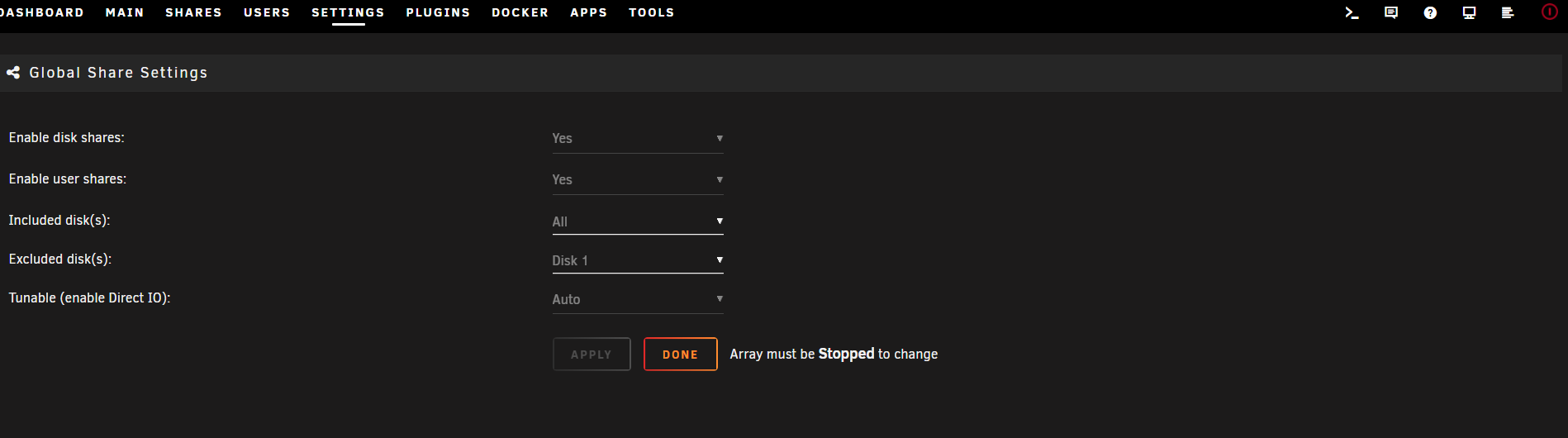

I have posted the error, Global Share settings and the Movies Share settings showing that Disk1 is not in the included.
Why?
3 minutes ago, Frank1940 said:
Why?
I thought I was supposed to. The instructions say to put the swap disk in the excluded list.
Is this not correct anymore?

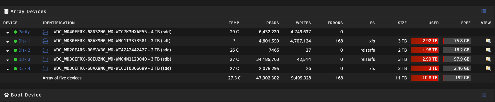

The transfer from Disk 3 to Disk 1 has finished but I noticed there are errors on Disk 1. I have tested multiple files and everything looks good and works. Should I be concerned? I clicked on Disk 1 and can't see anything out of the normal.
If everything is working as designed, then what happened was a read error. The data that was supposed to be there was reconstructed from parity, and written back into place, and the write succeeded.
If you haven't rebooted since then, the diagnostics might show exactly what happened. In any case, it wouldn't be the worst idea to run a full smart test on that disk.
