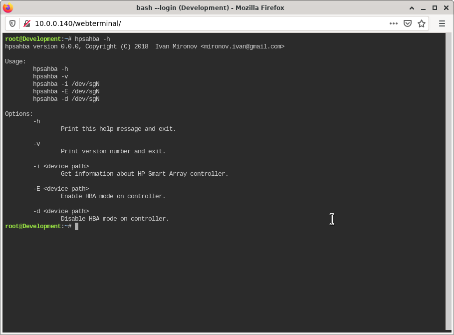

Tested "hpsahba" to see if I could get my P410i controller into "HBA"-mode, and it worked on a stock DL380 G7 at least.ย
To be able to use the drives in unraid, the hpsa module needs a little patch which would be nifty to have as standard on unraid. ๐Ÿ™‚
Checkย https://github.com/im-0/hpsahbaย for the patch.

  • Can you doย  find / -name hpsahba and post results please ?
  • Ok, I make it work. Sadly, I had to pop out one of the drives and use a drive-to-usbย adapter and create the array to use docker. After read how that pugin/docker works, it was quite easy.
  • Yes. Repo is quite good documented as well.ย  I don't think it would be necessary to install theย hpsahba tool (maybe in a separated docker?).ย  Patchs are for kernels 4.x and 5.x

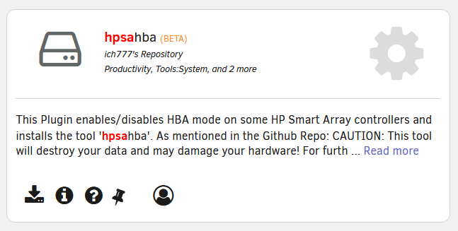

You can integrate every patch, simple as possible, with the Unraid-Kernel-Helper into for lets say Unraid 6.9.0RC2 but please keep in mind that this patch has to be compatible with Kernel 5.x
(You have to turn on User Patches)

The problem with that approach is that you need docker, and because the driver is not patch, the array is not started due to no disksย listed. Am I wrong @ich777?

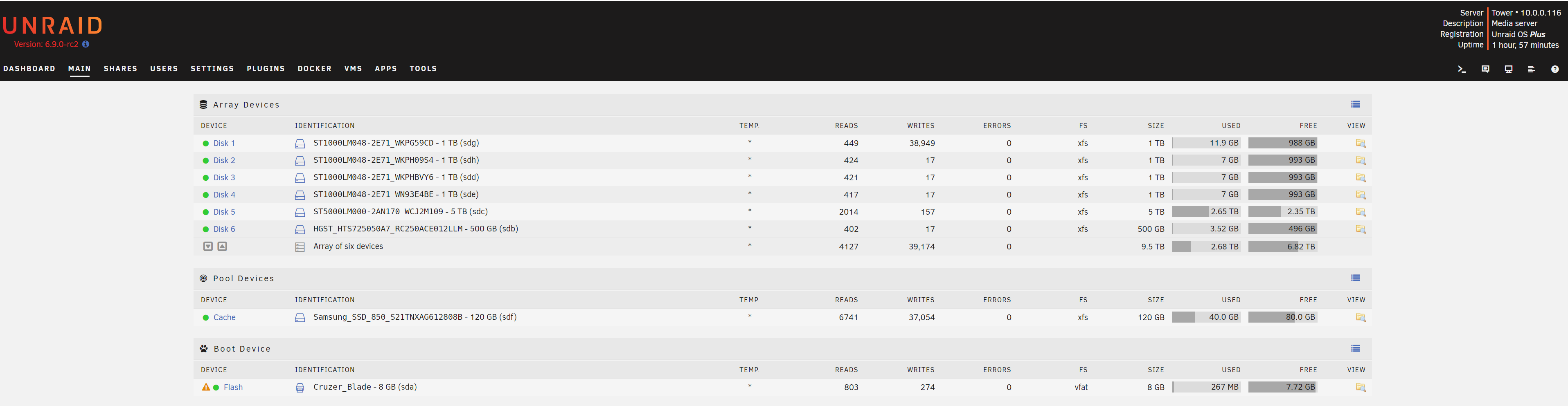

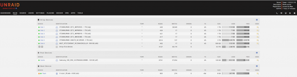

Ok, I make it work.
Once you have it working, create a file in /etc/modprobe.d/ called hpsa.conf and place the following
options hpsa hpsa_use_nvram_hba_flag=1
With that it will load the parameter on load.ย
So, after that,ย
modprobe -r hpsa
modprobe hpsa
and you should see the drives.

Thanks a lot @ich777!

I'm not sure what do you mean with "dump" of /dev/disk/by-id, so I'm gonna post some info, before and after reload the module. That was the before, now the after
ย
root@Tower:~# modprobe -r hpsa
root@Tower:~# modprobe hpsa hpsa_use_nvram_hba_flag=1
root@Tower:~# lsblk
NAME   MAJ:MIN RM   SIZE RO TYPE MOUNTPOINT
loop0    7:0    0  11.1M  1 loop /lib/modules
loop1    7:1    0  21.4M  1 loop /lib/firmware
sda      8:0    1   7.5G  0 disk
โ””โ”€sda1   8:1    1   7.5G  0 part /boot
sdb      8:16   0 465.8G  0 disk
โ””โ”€sdb1   8:17   0 465.8G  0 part
sdc      8:32   0   4.5T  0 disk
โ””โ”€sdc1   8:33   0   4.5T  0 part
sdd      8:48   0 931.5G  0 disk
โ””โ”€sdd1   8:49   0 931.5G  0 part
sde      8:64   0 931.5G  0 disk
โ””โ”€sde1   8:65   0 931.5G  0 part
sdf      8:80   0 111.8G  0 disk
โ””โ”€sdf1   8:81   0 111.8G  0 part
sdg      8:96   0 931.5G  0 disk
โ””โ”€sdg1   8:97   0 931.5G  0 part
sdh      8:112  0 931.5G  0 disk
โ””โ”€sdh1   8:113  0 931.5G  0 part
root@Tower:~# lsscsi
[0:0:0:0]    disk    SanDisk  Cruzer Blade     1.00  /dev/sda
[1:0:0:0]    storage HP       P410i            6.64  -
[1:0:1:0]    disk    ATA      HGST HTS725050A7 A340  /dev/sdb
[1:0:2:0]    disk    ATA      ST5000LM000-2AN1 0001  /dev/sdc
[1:0:3:0]    disk    ATA      ST1000LM048-2E71 0001  /dev/sdd
[1:0:4:0]    disk    ATA      ST1000LM048-2E71 0001  /dev/sde
[1:0:5:0]    disk    ATA      Samsung SSD 850  1B6Q  /dev/sdf
[1:0:6:0]    disk    ATA      ST1000LM048-2E71 0001  /dev/sdg
[1:0:7:0]    disk    ATA      ST1000LM048-2E71 0001  /dev/sdh

@grugo So only the kernel module is needed, but what if someone needs to change the mode of the disk itself?
Can this also be done somewhere in ILO?
ย
I don't think a plugin would be the correct way since a few kernel modules needs to be replaced but I will look into it...

Are you sure? The description says that it is possible but you have to pass an argument at boot, in our case for Unraid to syslinux.cfg: 'hpsa.hpsa_use_nvram_hba_flag=1' or do I understand the following wrong:
ย
hpsahba itself is able to work on any modern Linux system.
However, to get system actually see and use disks in HBA mode, few kernel patches required: https://github.com/im-0/hpsahba/tree/master/kernel.
This functionality is disabled by default. To enable, load module hpsa with parameter hpsa_use_nvram_hba_flag set to "1". Or set it in the kernel command line: "hpsa.hpsa_use_nvram_hba_flag=1".
  • hpsahba -h
    Show help message and exit.
  • hpsahba -v
    Show version and exit.
  • hpsahba -i DEVICE_PATH
    Show some information about device. This Includes HBA mode support bit (supported/not supported) and current state of HBA mode (enabled/disabled). It is recommended to run this before trying to enable or disable HBA mode.
  • hpsahba -E DEVICE_PATH
    Enable HBA mode.
  • hpsahba -d DEVICE_PATH
    Disable HBA mode.
