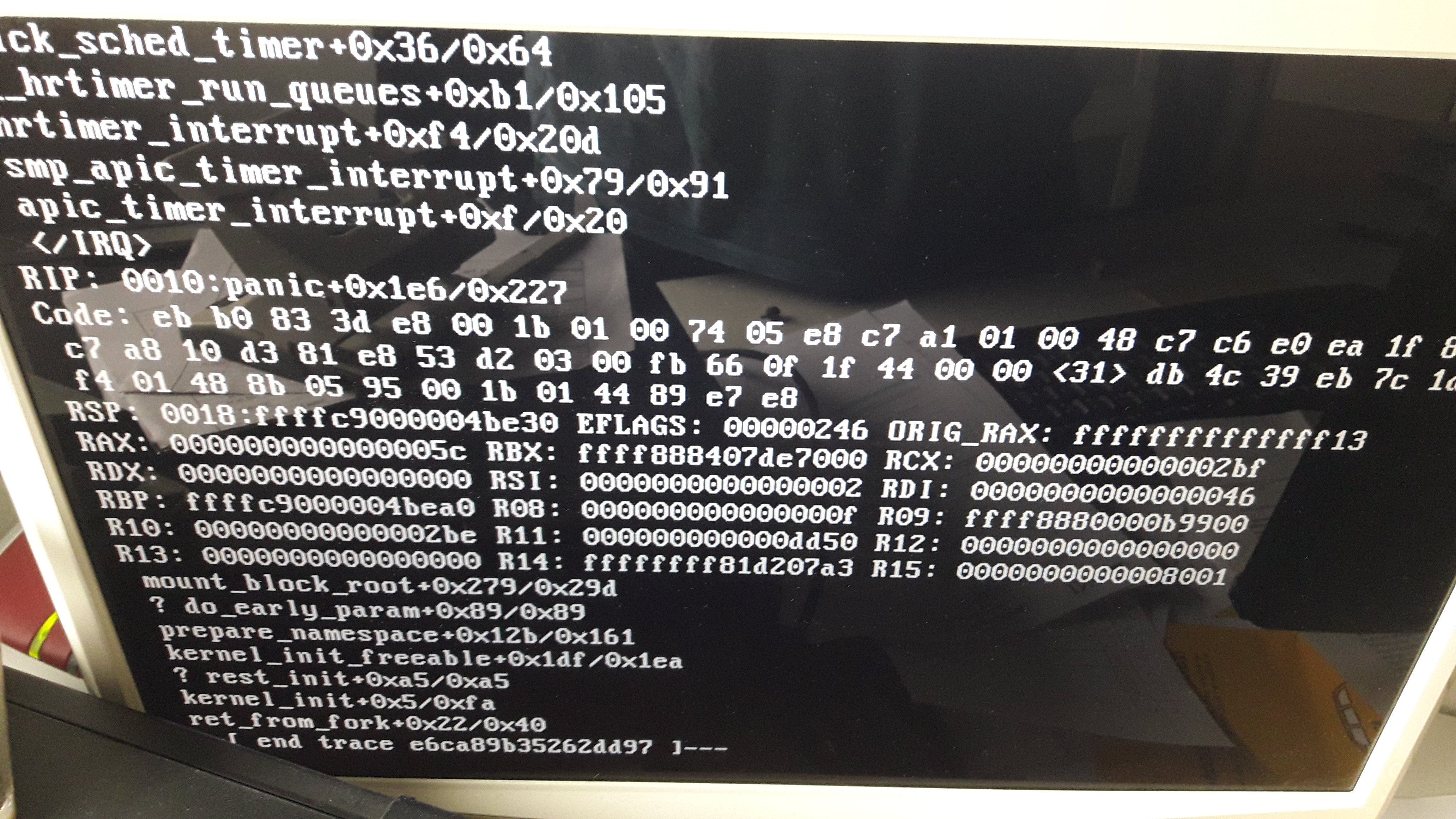

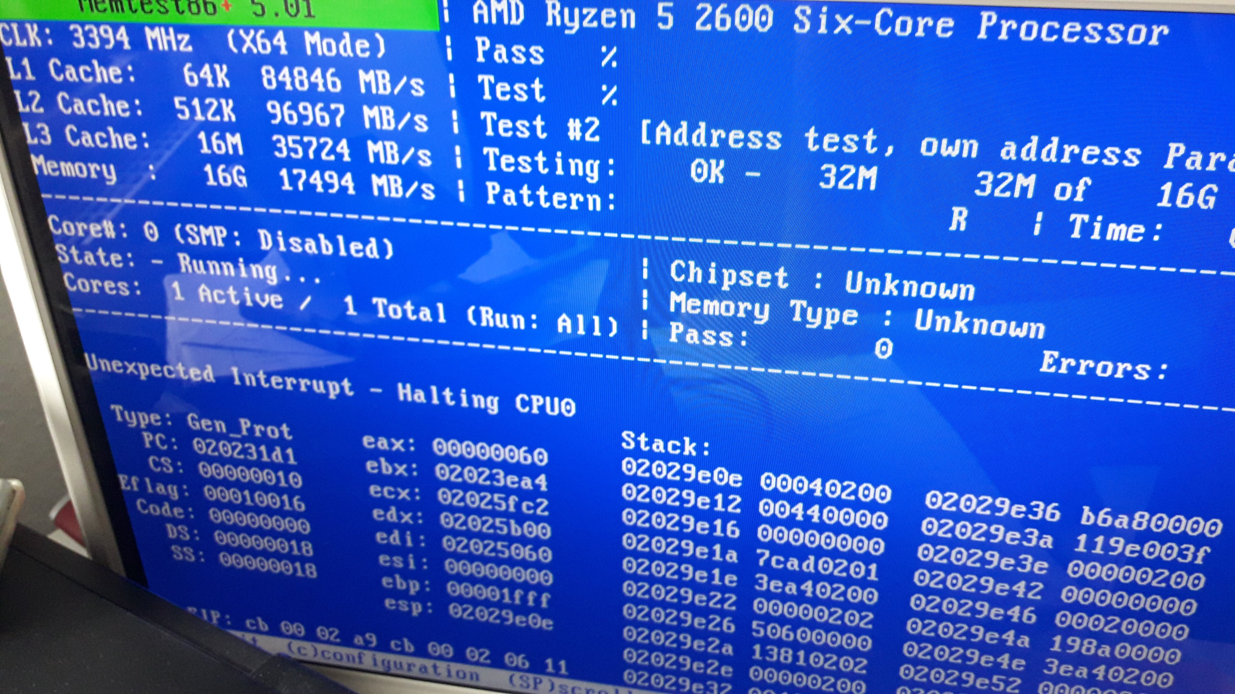

I have a problem with my Unraid server. After a restart it doesn't boot anymore and gets stuck at a certain place. I have attached the error and the memtest as an image.
Hallo,
Ich habe ein Problem mit meinem Unraid Server. Nach einem Neustart Bootet dieser nicht mehr und bleibt an einer BEstimmten Stelle hängen. Ich habe den Fehler und den Memtest als Bild angehängt.

Time is not running out and never more than 32M are tested. Even after several minutes (30) nothing changes.
I tested both modules individually with the same result:
Edited by Tobiasp
You means error halt immediately ? Then I suspect it is BIOS ver not update. What version currently ?

So I have now run Memtest alone from a USB stick. The test resulted in zero errors. So it must be Unraid's fault?
Memtest come from Unraid ?
How about booting in safe mode or a new create USB stick ( no need licence ) ?
