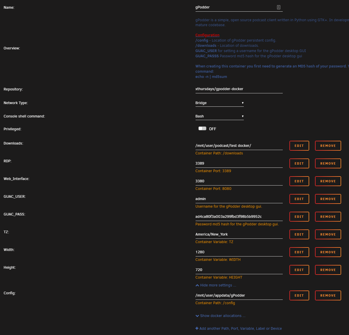

Hello,
First of all, thank for this docker. I try in the past to make a gPodder docker but couldn't make it work. I have a Ubuntu VM for this and always wanted to move it to docker.
That being said, I have some strange behavior with this Docker.

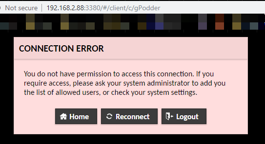

1:
when I try to connect to the guacamole login screen it give me a connection error. When I click home it forward me to gPodder but not under IP/#/client/gPodder

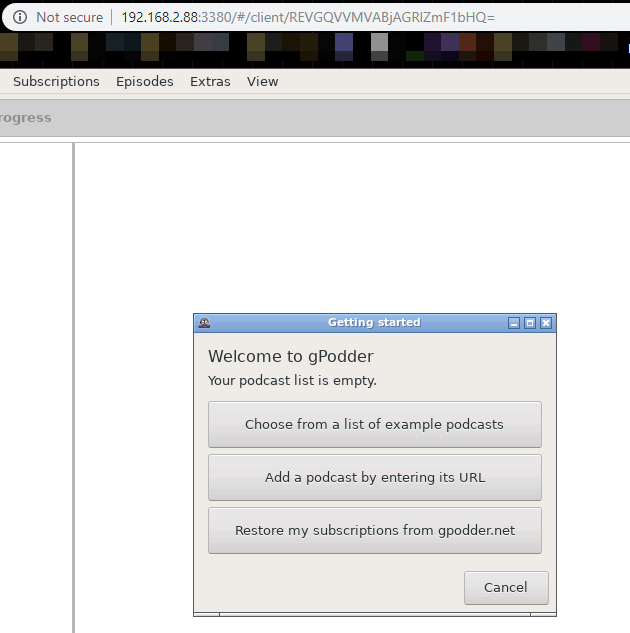

Everything seem to work but not under your GUI web browser address
Is this a normal behavior?
2:
Some of my french podcast seem to have character that are not recognize in this docker and cannot be added to the docker. I do not have this problem in my VM. Is there something I can do to add those character?
The name of the podcast is Ça s'explique "Ç" seem to be character \xc7
If you want to test, the feed french podcast is: http://feeds.feedburner.com/CaSExplique
Regards,
Settings:
My md5 is ad4ca80f3a003a299fbd3f98b5b9952c which is md5 for "gpodder"
Thanks for the feedback @tacomaster27 . Let me see if I can address your issues.
43 minutes ago, tacomaster27 said:
1: when I try to connect to the guacamole login screen it give me a connection error. When I click home it forward me to gPodder but not under IP/#/client/gPodder
The exact thing happens to me as well, this seems to be an issue with how the base image handles the gPodder login. Since it has been easy to work around this (by just clicking "home") I haven't worried about it too much, however, I'll look into it some more to see if I  can figure out what is causing the problem.

@tacomaster27 apologies that it took me a while to get back to this; work has been busy. I believe that both of your issues should now be resolved in the most recent version of this docker image.
I fixed the first issue by updating the unRAID template and changing the WebUI location. In terms of the second issue, I found out that this was being caused because most docker containers start with the ENV variable LANG=C set, which is a problem for UTF-8 characters. I've updated the container with LANG=C.UTF-8.
Please delete your gPodder folder, container and image and then install the newest version with the updated template from CA. Let me know if you're still having issues with podcasts that have non-ASCII characters.
