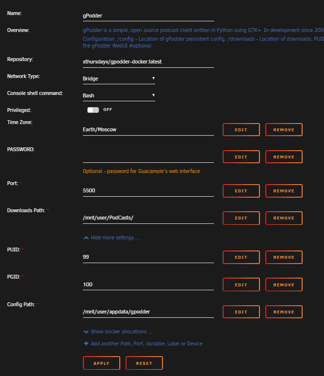

Hi guys.
There have been changes for some time now and we only see this during installation:
What should be added?
And I tried to set a password but the login is not stipulated: which one to set to make it work ?
