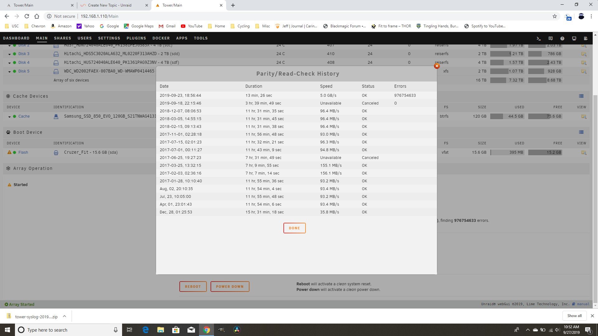

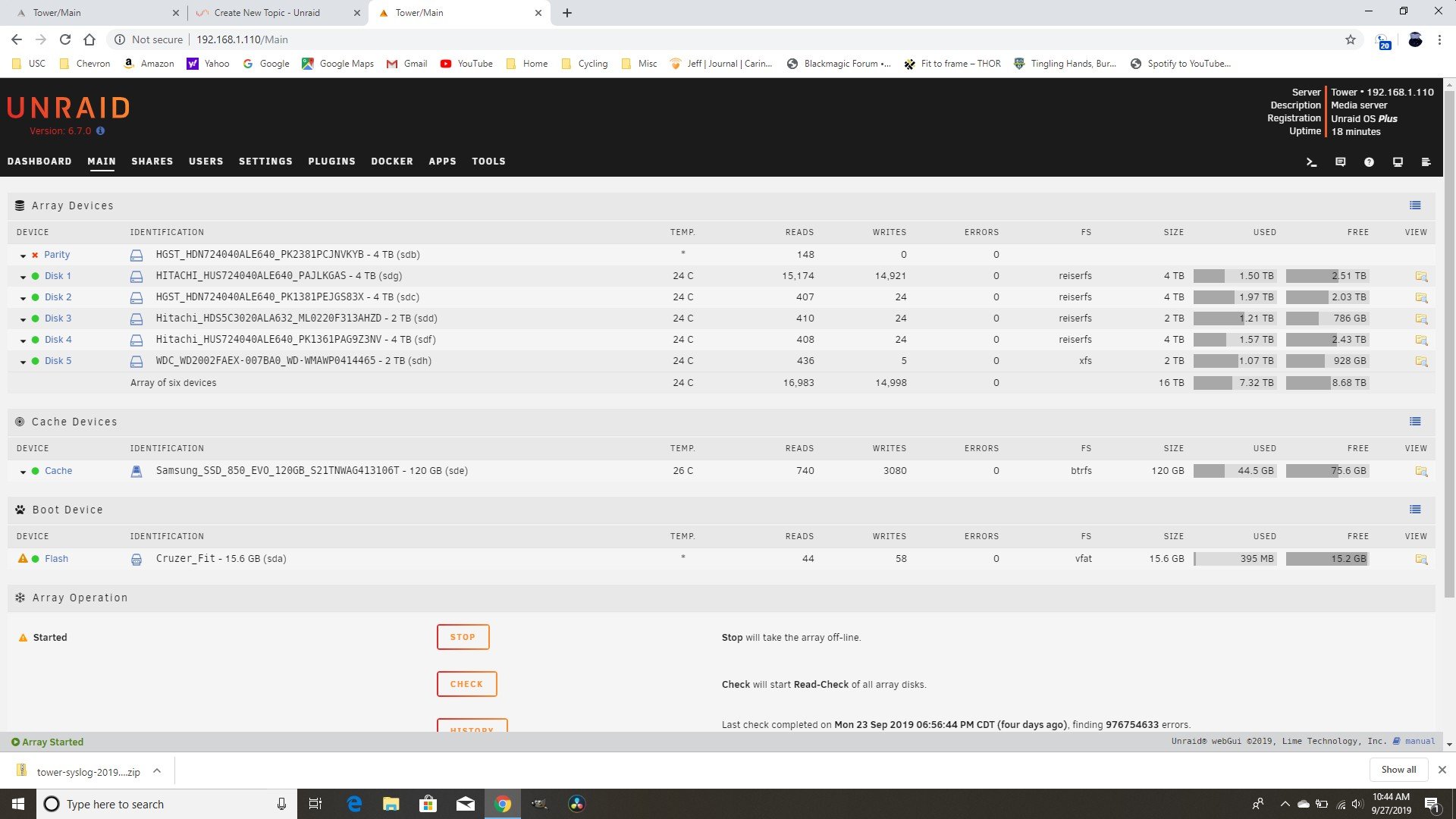

September 27, 20197 yr I'm not sure what happened here because I have replaced failed drives before without any problem, but something odd happened here. I had an old 2 GB data that was either failing or completely failed. I still do have it. I purchased a new 4 GB drive to replace it and had to wait for it to come. unRAID was just shutdown while I waited. Once the new drive arrived I took out the old drive and put the new one in, started up the server, did a pre-clear (passed just fine) and for some reason after the pre-clear the mounting of the disks was very slow and then I couldn't even reach it. It appears to have just frozen. I had to force a reboot. Once I rebooted I think I started the array expecting the drive to be rebuilt, but instead it did a parity check and since the new drive didn't have any data on it, it looks to have resulted in a huge number of errors. So I'm left with an invalid parity drive and a new data disk that doesn't have any data rebuilt on it. I'm not exactly sure what the safest thing is to do from here. Should I try re-inserting the old data drive and see if I can possibly rebuild the parity drive and start over? Any guidance is appreciated. tower-diagnostics-20190927-1554.zip Edited September 27, 20197 yr by JP Adding diagnostics
September 27, 20197 yr Community Expert Something is missing in your description: 16 minutes ago, JP said: but instead it did a parity check and since the new drive didn't have any data on it - the diags are after this, ideally we'd want those - what disk failed and doesn't have any data? all your disks show some data, though disk1 has fs corruption. - if there was a parity check after the unclean shutdown it would be non correct, i.e., parity wouldn't be touched. - parity is now disabled, did this happened before or after that?
September 27, 20197 yr Author 1 hour ago, johnnie.black said: Something is missing in your description: - the diags are after this, ideally we'd want those - what disk failed and doesn't have any data? all your disks show some data, though disk1 has fs corruption. - if there was a parity check after the unclean shutdown it would be non correct, i.e., parity wouldn't be touched. - parity is now disabled, did this happened before or after that? Thank you and very sorry. I don't always know exactly what information is needed. I attached the diags right after posting so you should see them now. DISK1 failed or at least was showing signs of failure (can't remember exactly). I have no idea why DISK1 is showing that there is data on it because there is clearly nothing there. I go look at it from FILE EXPLORER and it shows the MOVIES folder in it, but no files. Every other data disk shows files I would expect. Something tells me that maybe the parity tried to rebuild is, but failed in doing so. The parity becoming disabled seemed to take place after all this. This is pretty much when I stopped things and sought advice.

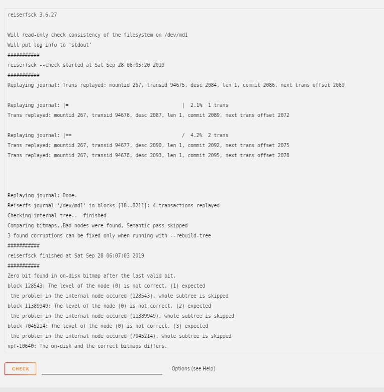

September 28, 20197 yr Community Expert Diags don't show nothing of what you describe, only that there is filesystem corruption on disk1, but I have no idea if it was correctly rebuilt or not, but since parity state is unknown not many options now, run a filesystem check on disk1.
September 28, 20197 yr Author Thanks johnnie.black. I did that. Attached are the results. I'm assuming I should start the array again (without maintenance mode)...correct? tower-diagnostics-20190928-1940.zip Edited September 28, 20197 yr by JP Adding diagnostics
September 29, 20197 yr Community Expert 21 hours ago, JP said: I'm assuming I should start the array again (without maintenance mode)...correct? No, you need to run it again with --rebuild-tree
September 29, 20197 yr Author Thanks. Just finished. Diags attached in case that is what is needed to see the results. tower-diagnostics-20190929-1537.zip

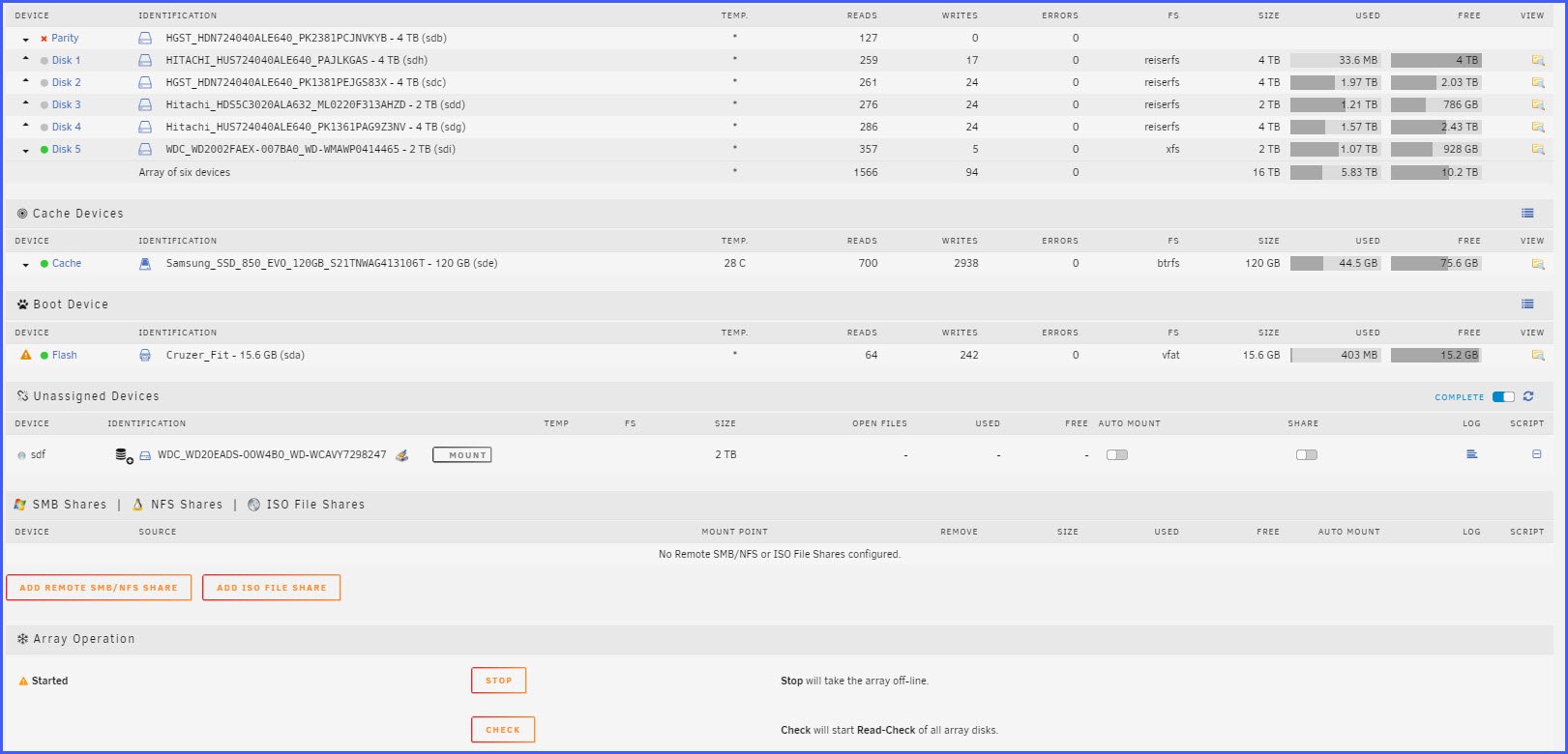

October 4, 20197 yr Author 18 minutes ago, itimpi said: If parity is showing as disabled then a write to it failed for some reason! Have you confirmed that you can mount the old drive as an Unassigned device? If so then, yes, I would recommend getting the array back into an error free protected state before copying the data back from the UD mounted drive. . The drive does show as unassigned, but isn't healthy. Is it possible to make an attempt to access the data on an unassigned drive outside of the array? I'm not sure how you would access data on an unassigned drive outside of the array. Edited October 4, 20197 yr by JP update
October 4, 20197 yr Community Expert 1 minute ago, JP said: The drive does show as unassigned, but isn't healthy. Is it possible to make an attempt to access the data on an unassigned drive outside of the array? I'm not sure how you would access data on an unassigned drive outside of the array. Do you have the Unassigned Devices plugin installed? If so does the ‘mount’ option work for the drive?
October 4, 20197 yr Author I just now installed the plugin. I see MOUNT reflected next to the drive, but hovering over it does nothing. I can't click on it. Does that mean the data on it is unrecoverable?
October 4, 20197 yr Community Expert 9 minutes ago, JP said: I just now installed the plugin. I see MOUNT reflected next to the drive, but hovering over it does nothing. I can't click on it. Does that mean the data on it is unrecoverable? Quite possibly unfortunately. Mount not being offered means that the plugin is not recognising the disk format. The other possibility is that the disk is not faulty but that there is file system level corruption that is stopping the disk being mounted. In that case running the appropriate file system recovery tool may make the disk usable. What format is the drive meant to be in?

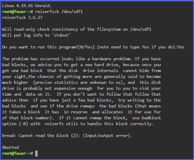

October 4, 20197 yr Author 1 minute ago, itimpi said: Quite possibly unfortunately. Mount not being offered means that the plugin is not recognising the disk format. The other possibility is that the disk is not faulty but that there is file system level corruption that is stopping the disk being mounted. In that case running the appropriate file system recovery tool may make the disk usable. What format is the drive meant to be in? reiserfs I believe. Is that what you are asking for?
October 4, 20197 yr Community Expert Just now, JP said: reiserfs I believe. Is that what you are asking for? If that is the case then you want to try from the Unraid command line running reiserfsck /dev/sdX1 where 'X' is the value for the drive in question. If reiserfsck now suggests to use --rebuild-tree rerun reiserfsck with the --rebuild-tree option added to the command go ahead and do that. Note that the reiserfack command can take some time to run so do not close the console window while it is running. If reiserfack completes without a fatal error the drive should then be mountable. If you get some other response from reiserfsck then post what happens for further ideas.
October 4, 20197 yr Community Expert That unfortunately looks like you really have a hardware failure on the drive. If that is the case getting any data off it is unlikely unless you are prepared to pay for professional data recovery services (which are not cheap_.
