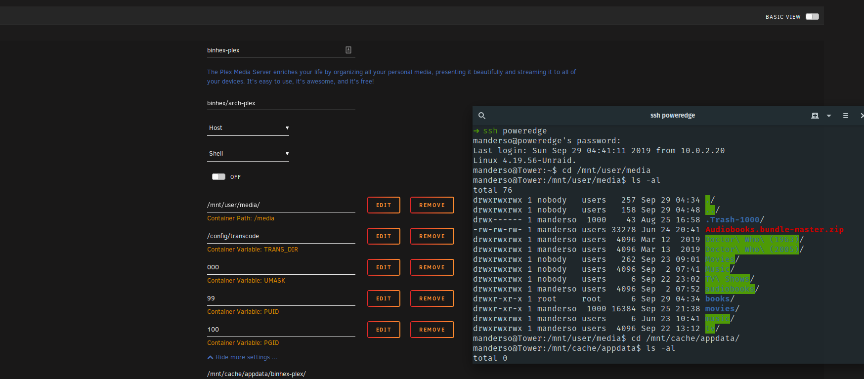

October 1, 20197 yr Author 7 hours ago, trurl said: No. Parity contains no actual data. It only contains parity bits that can be combined with corresponding bits on ALL remaining disks to calculate the contents of a missing or disabled disk. There are two different things that might be described as "settings". There are the settings for the container, such as volume mappings, that appear on the add/edit container page when you configure a docker. These settings are stored on flash and tell Unraid how to run the docker. And there are the settings for the application running within the container, such as plex libraries. These are stored in the appdata for the container. Your docker image is fuller than I usually see in diagnostics. It might be OK or it might mean you have a misconfigured application. Have you ever filled up docker image? I've been close to filling the docker image, and got a warning about it. So I removed some docker containers, and it went below the warning threshold (75%) I think. Currently I'm at 64%. The appdata dir for Plex still has metadata and media information according to an ls of mnt/user/appdata/binhex-plex/Plex Media Server/Media/localhost/ manderso@Tower:/mnt/user/appdata/binhex-plex/Plex Media Server$ ls -al Media/localhost/ total 156 drwxrwxrwx 1 nobody users 153 Aug 7 21:02 ./ drwxrwxrwx 1 nobody users 31 Aug 7 03:38 ../ drwxrwxrwx 1 nobody users 8192 Aug 7 05:08 0/ drwxrwxrwx 1 nobody users 8192 Aug 7 05:08 1/ drwxrwxrwx 1 nobody users 12288 Aug 7 05:08 3/ drwxrwxrwx 1 nobody users 8192 Aug 7 06:05 4/ drwxrwxrwx 1 nobody users 12288 Aug 7 05:08 6/ drwxrwxrwx 1 nobody users 8192 Aug 7 05:08 7/ drwxrwxrwx 1 nobody users 12288 Aug 7 05:08 8/ drwxrwxrwx 1 nobody users 12288 Aug 7 05:08 9/ drwxrwxrwx 1 nobody users 12288 Aug 7 05:08 b/ drwxrwxrwx 1 nobody users 8192 Aug 7 05:08 e/ drwxrwxrwx 1 nobody users 12288 Aug 7 21:02 f/ But the Plex webui doesn't see the server I had setup prior to this issue.

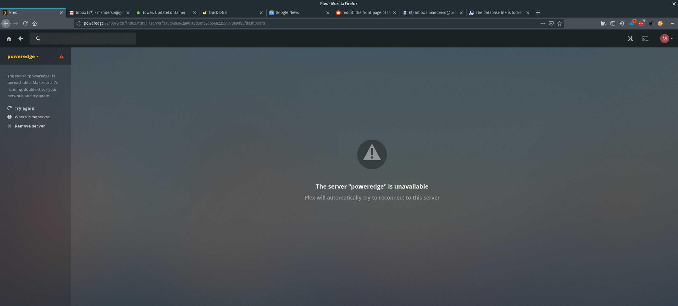

October 1, 20197 yr Community Expert 3 hours ago, manderso said: But the Plex webui doesn't see the server I had setup prior to this issue. Have you tried logging out of plex from that plex webui and then logging in again?
October 1, 20197 yr Author 4 hours ago, trurl said: Have you tried logging out of plex from that plex webui and then logging in again? I restarted the container, but that didn't help. I've now logged out and back in (in the webui), but Plex doesn't still doesn't see my server.
October 1, 20197 yr Community Expert 8 hours ago, manderso said: the Plex webui doesn't see the server I had setup Do you have a screenshot just to make sure you are having the problem I think and not some other?
October 1, 20197 yr Author 1 hour ago, trurl said: Do you have a screenshot just to make sure you are having the problem I think and not some other? I hope these explain what I'm going through. Thanks again for your help. Obv, poweredge is the name of the plex server that was working until recently.
October 2, 20197 yr Author I've restarted the docker engine, and now it's trying to create a new plex server when I go to the site. Here's the logs from the plex server: ErrorWarningSystemArrayLogin Created by... ___. .__ .__ \_ |__ |__| ____ | |__ ____ ___ ___ | __ \| |/ \| | \_/ __ \\ \/ / | \_\ \ | | \ Y \ ___/ > < |___ /__|___| /___| /\___ >__/\_ \ \/ \/ \/ \/ \/ https://hub.docker.com/u/binhex/ 2019-09-27 07:23:53.725205 [info] System information Linux Tower 4.19.56-Unraid #1 SMP Tue Jun 25 10:19:34 PDT 2019 x86_64 GNU/Linux 2019-09-27 07:23:53.761052 [info] PUID defined as '99' 2019-09-27 07:23:54.260036 [info] PGID defined as '100' 2019-09-27 07:24:14.005461 [info] UMASK defined as '000' 2019-09-27 07:24:14.045224 [info] Permissions already set for volume mappings 2019-09-27 07:24:14.074088 [info] TRANS_DIR defined as '/config/transcode' 2019-09-27 07:24:14.180959 [info] Starting Supervisor... 2019-09-27 07:24:14,486 INFO Included extra file "/etc/supervisor/conf.d/plexmediaserver.conf" during parsing 2019-09-27 07:24:14,487 INFO Set uid to user 0 succeeded 2019-09-27 07:24:14,489 INFO supervisord started with pid 6 2019-09-27 07:24:15,491 INFO spawned: 'plexmediaserver' with pid 57 2019-09-27 07:24:15,492 INFO reaped unknown pid 7 2019-09-27 07:24:16,493 INFO success: plexmediaserver entered RUNNING state, process has stayed up for > than 1 seconds (startsecs) 2019-09-27 19:01:20,523 DEBG 'plexmediaserver' stderr output: Connection to 45.79.215.15 closed by remote host. 2019-09-27 19:06:50,102 DEBG 'plexmediaserver' stderr output: Connection to 45.79.200.142 closed by remote host. 2019-09-28 04:19:49,089 DEBG 'plexmediaserver' stderr output: GUI: Matching 'Codename Villanelle Killing Eve Book 1' 2019-09-28 19:32:25,311 WARN received SIGTERM indicating exit request 2019-09-28 19:32:25,311 DEBG killing plexmediaserver (pid 57) with signal SIGTERM 2019-09-28 19:32:25,311 INFO waiting for plexmediaserver to die 2019-09-28 19:32:26,573 DEBG 'plexmediaserver' stdout output: Critical: libusb_init failed 2019-09-28 19:32:26,731 DEBG fd 8 closed, stopped monitoring <POutputDispatcher at 22385873961488 for <Subprocess at 22385874019088 with name plexmediaserver in state STOPPING> (stdout)> 2019-09-28 19:32:26,731 DEBG fd 10 closed, stopped monitoring <POutputDispatcher at 22385874075344 for <Subprocess at 22385874019088 with name plexmediaserver in state STOPPING> (stderr)> 2019-09-28 19:32:26,731 INFO stopped: plexmediaserver (exit status 0) 2019-09-28 19:32:26,731 DEBG received SIGCHLD indicating a child quit Created by... ___. .__ .__ \_ |__ |__| ____ | |__ ____ ___ ___ | __ \| |/ \| | \_/ __ \\ \/ / | \_\ \ | | \ Y \ ___/ > < |___ /__|___| /___| /\___ >__/\_ \ \/ \/ \/ \/ \/ https://hub.docker.com/u/binhex/ 2019-09-28 19:38:35.695360 [info] System information Linux Tower 4.19.56-Unraid #1 SMP Tue Jun 25 10:19:34 PDT 2019 x86_64 GNU/Linux 2019-09-28 19:38:36.207299 [info] PUID defined as '99' 2019-09-28 19:38:36.700117 [info] PGID defined as '100' 2019-09-28 19:38:39.360322 [info] UMASK defined as '000' 2019-09-28 19:38:39.391194 [info] Setting permissions recursively on volume mappings... 2019-09-28 19:38:39.715424 [info] TRANS_DIR defined as '/config/transcode' 2019-09-28 19:38:39.917566 [info] Starting Supervisor... 2019-09-28 19:39:05,708 INFO Included extra file "/etc/supervisor/conf.d/plexmediaserver.conf" during parsing 2019-09-28 19:39:05,709 INFO Set uid to user 0 succeeded 2019-09-28 19:39:05,922 INFO supervisord started with pid 6 2019-09-28 19:39:06,923 INFO spawned: 'plexmediaserver' with pid 52 2019-09-28 19:39:06,924 INFO reaped unknown pid 7 2019-09-28 19:39:07,924 INFO success: plexmediaserver entered RUNNING state, process has stayed up for > than 1 seconds (startsecs) 2019-09-28 19:40:16,741 DEBG 'plexmediaserver' stderr output: Exception AttributeError: "'ZipArchive' object has no attribute '_zip'" in <bound method ZipArchive.__del__ of <Framework.components.data.ZipArchive object at 0x154dac243a10>> ignored 2019-09-29 03:39:28,168 DEBG 'plexmediaserver' stderr output: Exception AttributeError: "'ZipArchive' object has no attribute '_zip'" in <bound method ZipArchive.__del__ of <Framework.components.data.ZipArchive object at 0x154dafdf8a90>> ignored 2019-09-29 04:24:24,939 WARN received SIGTERM indicating exit request 2019-09-29 04:24:24,940 DEBG killing plexmediaserver (pid 52) with signal SIGTERM 2019-09-29 04:24:24,940 INFO waiting for plexmediaserver to die 2019-09-29 04:24:25,196 DEBG 'plexmediaserver' stdout output: Critical: libusb_init failed 2019-09-29 04:24:25,206 DEBG fd 8 closed, stopped monitoring <POutputDispatcher at 22875389960080 for <Subprocess at 22875390034320 with name plexmediaserver in state STOPPING> (stdout)> 2019-09-29 04:24:25,206 DEBG fd 10 closed, stopped monitoring <POutputDispatcher at 22875390070160 for <Subprocess at 22875390034320 with name plexmediaserver in state STOPPING> (stderr)> 2019-09-29 04:24:25,206 INFO stopped: plexmediaserver (exit status 0) 2019-09-29 04:24:25,206 DEBG received SIGCHLD indicating a child quit Created by... ___. .__ .__ \_ |__ |__| ____ | |__ ____ ___ ___ | __ \| |/ \| | \_/ __ \\ \/ / | \_\ \ | | \ Y \ ___/ > < |___ /__|___| /___| /\___ >__/\_ \ \/ \/ \/ \/ \/ https://hub.docker.com/u/binhex/ 2019-09-29 04:25:50.577945 [info] System information Linux Tower 4.19.56-Unraid #1 SMP Tue Jun 25 10:19:34 PDT 2019 x86_64 GNU/Linux 2019-09-29 04:25:51.358377 [info] PUID defined as '99' 2019-09-29 04:25:51.876233 [info] PGID defined as '100' 2019-09-29 04:25:54.325726 [info] UMASK defined as '000' 2019-09-29 04:25:54.354808 [info] Permissions already set for volume mappings 2019-09-29 04:25:54.393369 [info] TRANS_DIR defined as '/config/transcode' 2019-09-29 04:25:54.676707 [info] Starting Supervisor... Created by... ___. .__ .__ \_ |__ |__| ____ | |__ ____ ___ ___ | __ \| |/ \| | \_/ __ \\ \/ / | \_\ \ | | \ Y \ ___/ > < |___ /__|___| /___| /\___ >__/\_ \ \/ \/ \/ \/ \/ https://hub.docker.com/u/binhex/ 2019-09-29 04:27:41.333013 [info] System information Linux Tower 4.19.56-Unraid #1 SMP Tue Jun 25 10:19:34 PDT 2019 x86_64 GNU/Linux 2019-09-29 04:27:43.407617 [info] PUID defined as '99' 2019-09-29 04:27:45.135029 [info] PGID defined as '100' 2019-09-29 04:27:51.914105 [info] UMASK defined as '000' 2019-09-29 04:27:51.943200 [info] Permissions already set for volume mappings 2019-09-29 04:27:51.972399 [info] TRANS_DIR defined as '/config/transcode' 2019-09-29 04:27:52.239811 [info] Starting Supervisor... 2019-09-29 04:29:03,400 INFO Included extra file "/etc/supervisor/conf.d/plexmediaserver.conf" during parsing 2019-09-29 04:29:03,400 INFO Set uid to user 0 succeeded 2019-09-29 04:29:03,592 INFO supervisord started with pid 6 2019-09-29 04:29:04,593 INFO spawned: 'plexmediaserver' with pid 50 2019-09-29 04:29:04,594 INFO reaped unknown pid 7 2019-09-29 04:29:05,595 INFO success: plexmediaserver entered RUNNING state, process has stayed up for > than 1 seconds (startsecs) 2019-09-29 04:30:28,739 DEBG 'plexmediaserver' stderr output: Exception AttributeError: "'ZipArchive' object has no attribute '_zip'" in <bound method ZipArchive.__del__ of <Framework.components.data.ZipArchive object at 0x1483d8449290>> ignored 2019-09-29 12:29:47,917 DEBG 'plexmediaserver' stderr output: Exception AttributeError: "'ZipArchive' object has no attribute '_zip'" in <bound method ZipArchive.__del__ of <Framework.components.data.ZipArchive object at 0x1483abde4e90>> ignored 2019-09-29 18:41:59,147 DEBG 'plexmediaserver' stderr output: Exception AttributeError: "'ZipArchive' object has no attribute '_zip'" in <bound method ZipArchive.__del__ of <Framework.components.data.ZipArchive object at 0x1483abd82fd0>> ignored 2019-09-30 02:30:54,586 DEBG 'plexmediaserver' stderr output: Exception AttributeError: "'ZipArchive' object has no attribute '_zip'" in <bound method ZipArchive.__del__ of <Framework.components.data.ZipArchive object at 0x1483d8147c10>> ignored 2019-09-30 09:00:47,786 DEBG 'plexmediaserver' stderr output: Exception AttributeError: "'ZipArchive' object has no attribute '_zip'" in <bound method ZipArchive.__del__ of <Framework.components.data.ZipArchive object at 0x1483abd82850>> ignored 2019-09-30 15:43:48,042 DEBG 'plexmediaserver' stderr output: Exception AttributeError: "'ZipArchive' object has no attribute '_zip'" in <bound method ZipArchive.__del__ of <Framework.components.data.ZipArchive object at 0x1483abd827d0>> ignored 2019-09-30 17:59:59,258 WARN received SIGTERM indicating exit request 2019-09-30 17:59:59,259 DEBG killing plexmediaserver (pid 50) with signal SIGTERM 2019-09-30 17:59:59,259 INFO waiting for plexmediaserver to die 2019-09-30 17:59:59,528 DEBG fd 8 closed, stopped monitoring <POutputDispatcher at 23162416535888 for <Subprocess at 23162397749584 with name plexmediaserver in state STOPPING> (stdout)> 2019-09-30 17:59:59,529 DEBG fd 10 closed, stopped monitoring <POutputDispatcher at 23162397769232 for <Subprocess at 23162397749584 with name plexmediaserver in state STOPPING> (stderr)> 2019-09-30 17:59:59,529 INFO stopped: plexmediaserver (exit status 0) 2019-09-30 17:59:59,529 DEBG received SIGCHLD indicating a child quit Created by... ___. .__ .__ \_ |__ |__| ____ | |__ ____ ___ ___ | __ \| |/ \| | \_/ __ \\ \/ / | \_\ \ | | \ Y \ ___/ > < |___ /__|___| /___| /\___ >__/\_ \ \/ \/ \/ \/ \/ https://hub.docker.com/u/binhex/ 2019-09-30 18:01:09.476310 [info] System information Linux Tower 4.19.56-Unraid #1 SMP Tue Jun 25 10:19:34 PDT 2019 x86_64 GNU/Linux 2019-09-30 18:01:09.505964 [info] PUID defined as '99' 2019-09-30 18:01:09.538395 [info] PGID defined as '100' 2019-09-30 18:01:13.773960 [info] UMASK defined as '000' 2019-09-30 18:01:13.802657 [info] Permissions already set for volume mappings 2019-09-30 18:01:13.831339 [info] TRANS_DIR defined as '/config/transcode' 2019-09-30 18:01:13.861083 [info] Starting Supervisor... 2019-09-30 18:01:14,037 INFO Included extra file "/etc/supervisor/conf.d/plexmediaserver.conf" during parsing 2019-09-30 18:01:14,038 INFO Set uid to user 0 succeeded 2019-09-30 18:01:14,040 INFO supervisord started with pid 11 2019-09-30 18:01:15,042 INFO spawned: 'plexmediaserver' with pid 55 2019-09-30 18:01:15,042 INFO reaped unknown pid 12 2019-09-30 18:01:16,044 INFO success: plexmediaserver entered RUNNING state, process has stayed up for > than 1 seconds (startsecs) 2019-09-30 18:02:17,484 DEBG 'plexmediaserver' stderr output: Exception AttributeError: "'ZipArchive' object has no attribute '_zip'" in <bound method ZipArchive.__del__ of <Framework.components.data.ZipArchive object at 0x15137ac2e5d0>> ignored 2019-09-30 23:36:14,695 DEBG 'plexmediaserver' stderr output: Exception AttributeError: "'ZipArchive' object has no attribute '_zip'" in <bound method ZipArchive.__del__ of <Framework.components.data.ZipArchive object at 0x15137af93950>> ignored 2019-10-01 04:25:05,157 DEBG 'plexmediaserver' stderr output: Exception AttributeError: "'ZipArchive' object has no attribute '_zip'" in <bound method ZipArchive.__del__ of <Framework.components.data.ZipArchive object at 0x15137af936d0>> ignored 2019-10-01 10:10:01,460 DEBG 'plexmediaserver' stderr output: Exception AttributeError: "'ZipArchive' object has no attribute '_zip'" in <bound method ZipArchive.__del__ of <Framework.components.data.ZipArchive object at 0x15137aef0090>> ignored 2019-10-01 13:38:30,876 WARN received SIGTERM indicating exit request 2019-10-01 13:38:30,876 DEBG killing plexmediaserver (pid 55) with signal SIGTERM 2019-10-01 13:38:30,876 INFO waiting for plexmediaserver to die 2019-10-01 13:38:31,135 DEBG 'plexmediaserver' stdout output: Critical: libusb_init failed 2019-10-01 13:38:31,141 DEBG fd 8 closed, stopped monitoring <POutputDispatcher at 23394796210832 for <Subprocess at 23394796265936 with name plexmediaserver in state STOPPING> (stdout)> 2019-10-01 13:38:31,141 DEBG fd 10 closed, stopped monitoring <POutputDispatcher at 23394796341072 for <Subprocess at 23394796265936 with name plexmediaserver in state STOPPING> (stderr)> 2019-10-01 13:38:31,141 INFO stopped: plexmediaserver (exit status 0) 2019-10-01 13:38:31,141 DEBG received SIGCHLD indicating a child quit Created by... ___. .__ .__ \_ |__ |__| ____ | |__ ____ ___ ___ | __ \| |/ \| | \_/ __ \\ \/ / | \_\ \ | | \ Y \ ___/ > < |___ /__|___| /___| /\___ >__/\_ \ \/ \/ \/ \/ \/ https://hub.docker.com/u/binhex/ 2019-10-01 13:38:35.387279 [info] System information Linux Tower 4.19.56-Unraid #1 SMP Tue Jun 25 10:19:34 PDT 2019 x86_64 GNU/Linux 2019-10-01 13:38:35.416102 [info] PUID defined as '99' 2019-10-01 13:38:35.447223 [info] PGID defined as '100' 2019-10-01 13:38:36.170118 [info] UMASK defined as '000' 2019-10-01 13:38:36.198375 [info] Permissions already set for volume mappings 2019-10-01 13:38:36.227354 [info] TRANS_DIR defined as '/config/transcode' 2019-10-01 13:38:36.256357 [info] Starting Supervisor... 2019-10-01 13:38:36,424 INFO Included extra file "/etc/supervisor/conf.d/plexmediaserver.conf" during parsing 2019-10-01 13:38:36,424 INFO Set uid to user 0 succeeded 2019-10-01 13:38:36,426 INFO supervisord started with pid 6 2019-10-01 13:38:37,428 INFO spawned: 'plexmediaserver' with pid 50 2019-10-01 13:38:37,428 INFO reaped unknown pid 7 2019-10-01 13:38:38,430 INFO success: plexmediaserver entered RUNNING state, process has stayed up for > than 1 seconds (startsecs) 2019-10-01 13:39:39,733 DEBG 'plexmediaserver' stderr output: Exception AttributeError: "'ZipArchive' object has no attribute '_zip'" in <bound method ZipArchive.__del__ of <Framework.components.data.ZipArchive object at 0x151f439e5a90>> ignored 2019-10-01 21:04:34,980 DEBG 'plexmediaserver' stderr output: Exception AttributeError: "'ZipArchive' object has no attribute '_zip'" in <bound method ZipArchive.__del__ of <Framework.components.data.ZipArchive object at 0x151f43c40690>> ignored 2019-10-02 02:27:51,162 DEBG 'plexmediaserver' stderr output: Exception AttributeError: "'ZipArchive' object has no attribute '_zip'" in <bound method ZipArchive.__del__ of <Framework.components.data.ZipArchive object at 0x151f439e5990>> ignored 2019-10-02 07:34:08,838 DEBG 'plexmediaserver' stderr output: Exception AttributeError: "'ZipArchive' object has no attribute '_zi 2019-10-02 07:34:08,838 DEBG 'plexmediaserver' stderr output: p'" in <bound method ZipArchive.__del__ of <Framework.components.data.ZipArchive object at 0x151f43cd6290>> ignored 2019-10-02 11:43:18,209 DEBG 'plexmediaserver' stderr output: Exception AttributeError: "'ZipArchive' object has no attribute '_zip'" in <bound method ZipArchive.__del__ of <Framework.components.data.ZipArchive object at 0x151f43eaed10>> ignored 2019-10-02 14:17:00,097 WARN received SIGTERM indicating exit request 2019-10-02 14:17:00,097 DEBG killing plexmediaserver (pid 50) with signal SIGTERM 2019-10-02 14:17:00,097 INFO waiting for plexmediaserver to die 2019-10-02 14:17:00,407 DEBG 'plexmediaserver' stdout output: Critical: libusb_init failed 2019-10-02 14:17:00,413 DEBG fd 8 closed, stopped monitoring <POutputDispatcher at 23218982805776 for <Subprocess at 23218982715344 with name plexmediaserver in state STOPPING> (stdout)> 2019-10-02 14:17:00,413 DEBG fd 10 closed, stopped monitoring <POutputDispatcher at 23218982843792 for <Subprocess at 23218982715344 with name plexmediaserver in state STOPPING> (stderr)> 2019-10-02 14:17:00,413 INFO stopped: plexmediaserver (exit status 0) 2019-10-02 14:17:00,413 DEBG received SIGCHLD indicating a child quit Created by... ___. .__ .__ \_ |__ |__| ____ | |__ ____ ___ ___ | __ \| |/ \| | \_/ __ \\ \/ / | \_\ \ | | \ Y \ ___/ > < |___ /__|___| /___| /\___ >__/\_ \ \/ \/ \/ \/ \/ https://hub.docker.com/u/binhex/ 2019-10-02 14:17:44.699443 [info] System information Linux Tower 4.19.56-Unraid #1 SMP Tue Jun 25 10:19:34 PDT 2019 x86_64 GNU/Linux 2019-10-02 14:17:44.734799 [info] PUID defined as '99' 2019-10-02 14:17:44.769668 [info] PGID defined as '100' 2019-10-02 14:17:45.334166 [info] UMASK defined as '000' 2019-10-02 14:17:45.363329 [info] Permissions already set for volume mappings 2019-10-02 14:17:45.391219 [info] TRANS_DIR defined as '/config/transcode' 2019-10-02 14:17:45.567893 [info] Starting Supervisor... 2019-10-02 14:17:48,189 INFO Included extra file "/etc/supervisor/conf.d/plexmediaserver.conf" during parsing 2019-10-02 14:17:48,189 INFO Set uid to user 0 succeeded 2019-10-02 14:17:48,621 INFO supervisord started with pid 6 2019-10-02 14:17:49,623 INFO spawned: 'plexmediaserver' with pid 50 2019-10-02 14:17:49,623 INFO reaped unknown pid 7 2019-10-02 14:17:50,625 INFO success: plexmediaserver entered RUNNING state, process has stayed up for > than 1 seconds (startsecs) 2019-10-02 14:18:36,311 DEBG 'plexmediaserver' stderr output: Exception AttributeError: "'ZipArchive' object has no attribute '_zip'" in <bound method ZipArchive.__del__ of <Framework.components.data.ZipArchive object at 0x14c8b9e4d150>> ignored 2019-10-02 14:19:05,855 DEBG 'plexmediaserver' stderr output: Exception AttributeError: "'ZipArchive' object has no attribute '_zip'" in <bound method ZipArchive.__del__ of <Framework.components.data.ZipArchive object at 0x14c8ba3c7450>> ignored
