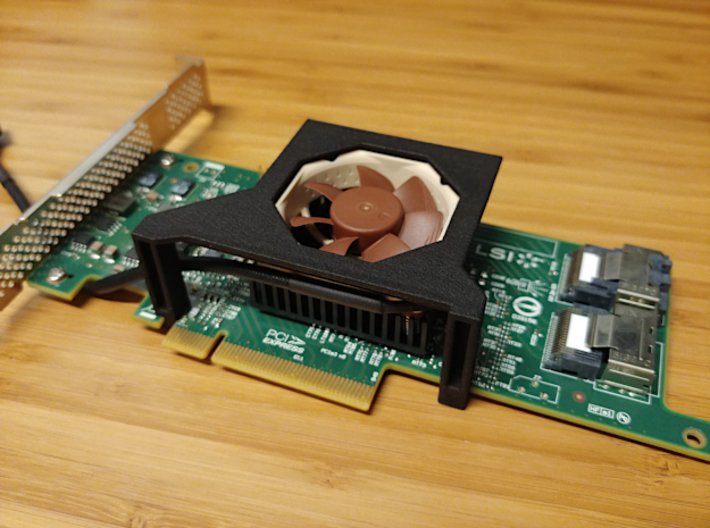

October 12, 20197 yr 19 hours ago, davidst95 said: Hi, I have a motherboard with a open PCIE x16 running at PCIe 3.0 x4 speed. I'm not sure what if I should get the LSI 9205-8i or the LSI 9207-8i controller. The LSI 9205-8i runs at PCIe 2.0 x8 and the LSI 9207-8i x8. Both have the x8 slot. I would like to get the 9207-8i to be future proof but I'm not sure if I would have a better chance of the 9205-8i working. Any advice would be greatly appreciated. Thanks! David I also recommend the 9207-8i - bought mine for only € 109.- A very good price for an 8-port controller and fully compatible with unraid 😉 But be carefull: In a normal PC-Case this controller needs active cooling because its designed for a server-case with strong airflow. The minimum airflow must be 200lfm (max. operating Temp 55° / Power consumption ~9,8W). I am using this 3D-printed braket for the Noctua NF-A4x10 FLX from ShapeWays: https://www.shapeways.com/product/NET3LH5QP/fan-bracket-for-lsi-9207-8i?productConfiguration=104311341&etId=192375185&utm_source=automated-contact&utm_medium=email&utm_campaign=order-shipped&utm_content=5 Edited October 12, 20197 yr by Zonediver
October 16, 20197 yr Author On 10/12/2019 at 6:54 AM, Zonediver said: I also recommend the 9207-8i - bought mine for only € 109.- A very good price for an 8-port controller and fully compatible with unraid 😉 But be carefull: In a normal PC-Case this controller needs active cooling because its designed for a server-case with strong airflow. The minimum airflow must be 200lfm (max. operating Temp 55° / Power consumption ~9,8W). I am using this 3D-printed braket for the Noctua NF-A4x10 FLX from ShapeWays: https://www.shapeways.com/product/NET3LH5QP/fan-bracket-for-lsi-9207-8i?productConfiguration=104311341&etId=192375185&utm_source=automated-contact&utm_medium=email&utm_campaign=order-shipped&utm_content=5 Thanks for the reply. That's good to know about the heat. Is there the same heat issue with LSI 9205-8i? Also, I would put the controller on the last pcie slot. Could I put a 120mm fan on the bottom of the case and blow up on to it? Thanks again! David
October 16, 20197 yr All these cards are designed to be in a high air flow server chasis, so they all need some kind of active cooling added in a standard case. Any kind of fan blowing air on or across the heatsink should be sufficient enough.
October 16, 20197 yr Author Thanks for the reply! I have a slim Noctua NF-A12x15 fan that I think can fit right under it.
