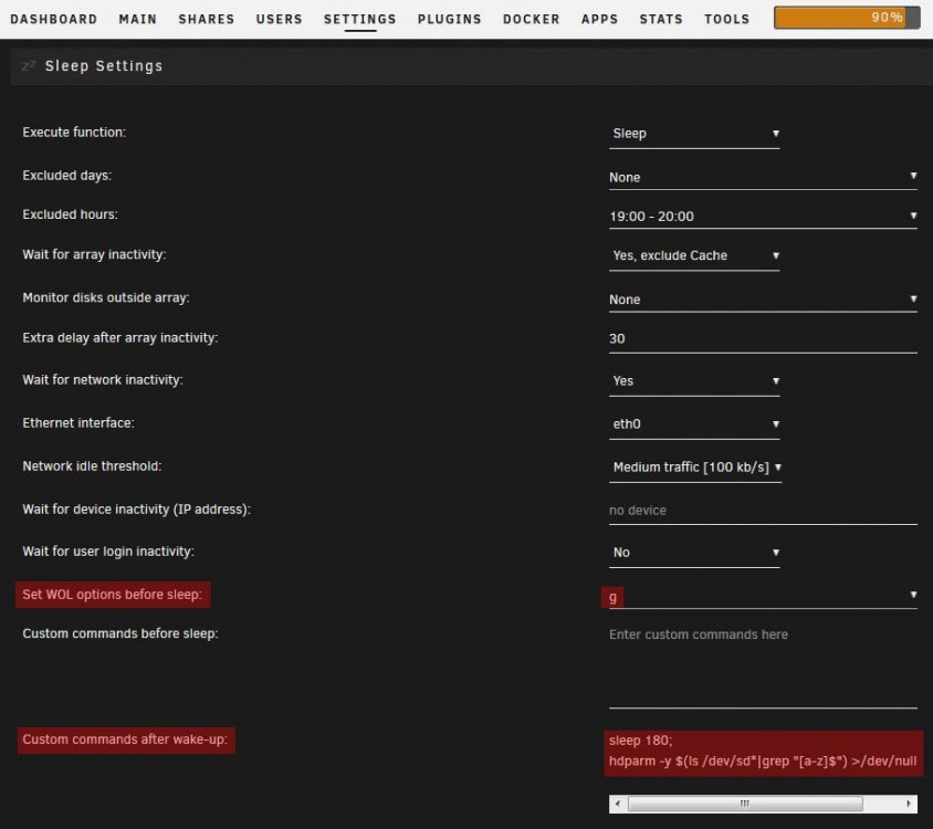

What you need are "proper" sleep settings.
I mentioned it, that the HDDs are not always go into the standby-state - they are often in active/idle-state that prevents the server going to sleep.
What you have to do is this:
This ensures that the disks go into standby after waking up the server so the server can go to sleep properly next time.
The time delay of 180 seconds prevents errormous messages in the log if the initialization of a controller is aborted - in my case the SAS 9207-8i.
To check if every disk is at standby-state, open a terminal and put in:
hdparm -C /dev/sd[a-z]
Edited by Zonediver

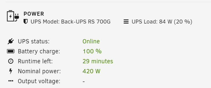

You can see it if you use a UPS that has a status connection.
4 hours ago, mjeshurun said:
Hi Chris, sorry if I'm reawakening an old thread, but where in the webui dashboard can we see the power consumption of the UnRAID server?
I cannot see such data in UnRAID 6.10.3.
Hope you can help.
Unraid (by itself) can not provide such data - what you need is an external Watt-Meter at the socket of the server 👍
...or a UPS
