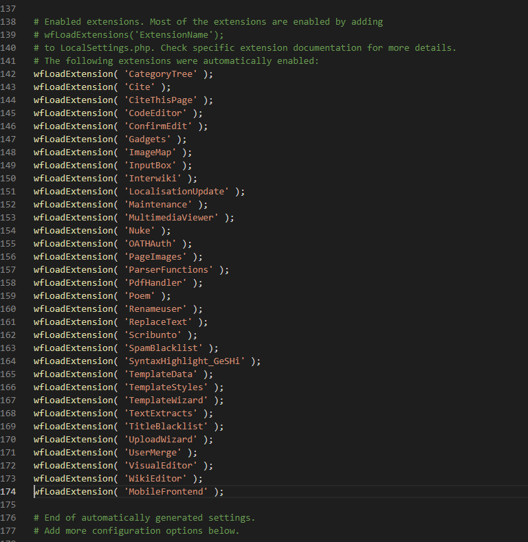

I tried installing the MobileFrontend extension, and Minerva Neue skin on the Edge package and got errors about not supporting version 1.33.4.
2021/01/03 13:15:00 [error] 469#469: *176 FastCGI sent in stderr: "PHP message: PHP Fatal error:  Uncaught ExtensionDependencyError: MinervaNeue is not compatible with the current MediaWiki core (version 1.33.4), it requires: >= 1.36.0.
MobileFrontend is not compatible with the current MediaWiki core (version 1.33.4), it requires: >= 1.36.0.
Despite mentioning that most skins have backwards compatibility neither the Master or 1.35 (latest stable MW release) support 1.33.4.

I tried manually installing both the 1.35 and 'latest' versions for both skin and extension, including modifying the LocalSettings.php to include the wfLoadSkin/Extension lines.
When i tried accessing the wiki using the local IP, or via a reverse proxy (which otherwise works when i comment out the wfLoad lines) i get a 500 error in chrome and firefox.
LocalSettings.php looks like:

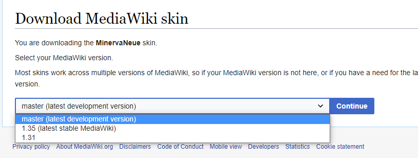

Now for the hard part, the skin.
(It's on my todo list to make scripts to automate managing skins, but at the time that I write all of the scripts for the MediaWiki Maintenance utility I didn't care about skins, just extensions.)
So the MinervaNeue skin version that you need can be found here https://gerrit.wikimedia.org/r/plugins/gitiles/mediawiki/skins/MinervaNeue/+/refs/heads/REL1_33
1) Go to the folder for the MinervaNeue e.g. appdata/mediawiki/www/mediawiki/skins/MinervaNeue
2) Delete all of the folders contents
3) Download this: https://gerrit.wikimedia.org/r/plugins/gitiles/mediawiki/skins/MinervaNeue/+archive/refs/heads/REL1_33.tar.gz
4) Extract the tar to the MinervaNeue folder
5) Configure the skin according to the extension's instructions (you can probably skip this since that should have previously be done and should still be there)
Hopefully I didn't leave anything out.

Hello, trying to install the PortableInfobox extension, anybody has experience with that?
Adding the files+line to load it in the LocalSettings_Extensions.php either doesn't seem to import the extension or causes a 500 HTTP error as the docker fails to start correctly.
Did you you download the extension files and put them in the correct file path? Mediawiki doesn't import an extension, it just loads it.
I try it manually but putting the files from the github in the extension folder (appdata/mediawiki/www/mediawiki/extensions/PortableInfobox) and wfLoadExtension('PortableInfobox'); at the end of both LocalSettings.php/LocalSettings_Extensions.php (appdata/mediawiki/www/mediawiki)
If I add either nothing, a single "#", dual "##" or a "$" before end, doesn't help. (not that it should really for half of these)
I also tried the Extension Manager after removing the files+resetting the .php but it failed at finding the extension and downloading the file, it just added "wfLoadExtension('PortableInfobox');" in the LocalSetting.php.
@Eddyall I looked at the extension, from what I can tell it is for MediaWiki version 1.37.0 and above. So unless you've updated the MediaWiki version that is packaged in the docker container then it's probably not compatible.
