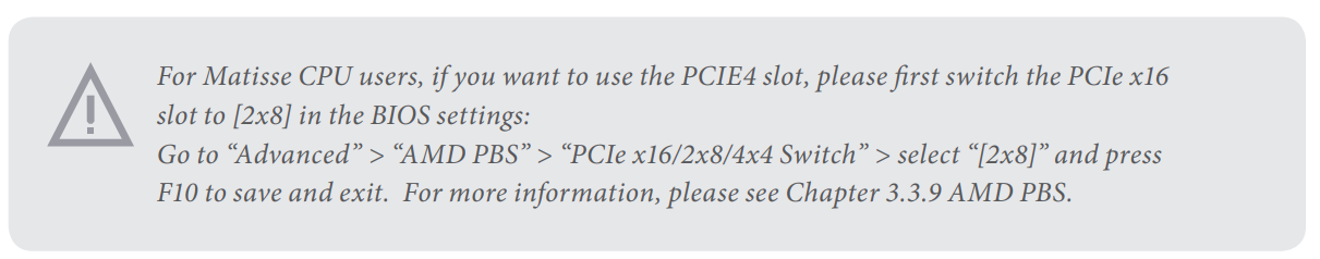

On 6/6/2021 at 6:38 AM, k0vw said:
I've recently gone from a 2600 to 3900x and neither of my graphics card show up. When I take either one out the other will show up but can't get both to show at the same time. Works fine with the 2600 though.
Any thoughts?
There's this really understated warning in the motherboard manual which has caught me out before and might be your problem too:
The setting isn't called exactly the same thing as the manual says either (so that's helpful), but you need to manually switch the slots into 2x8 mode for either to work properly with two GPUs installed on a Ryzen 3000 series CPU.
Edited by Alexstrasza
On 6/8/2021 at 5:50 AM, Alexstrasza said:
There was a bug with older versions of QEMU where the host-passthrough CPU mode would not work. This is fixed in later versions of UnRaid.
Perfect! That sorted my GPU issue but still having an issue with my USB controller passthrough now. More searching...
