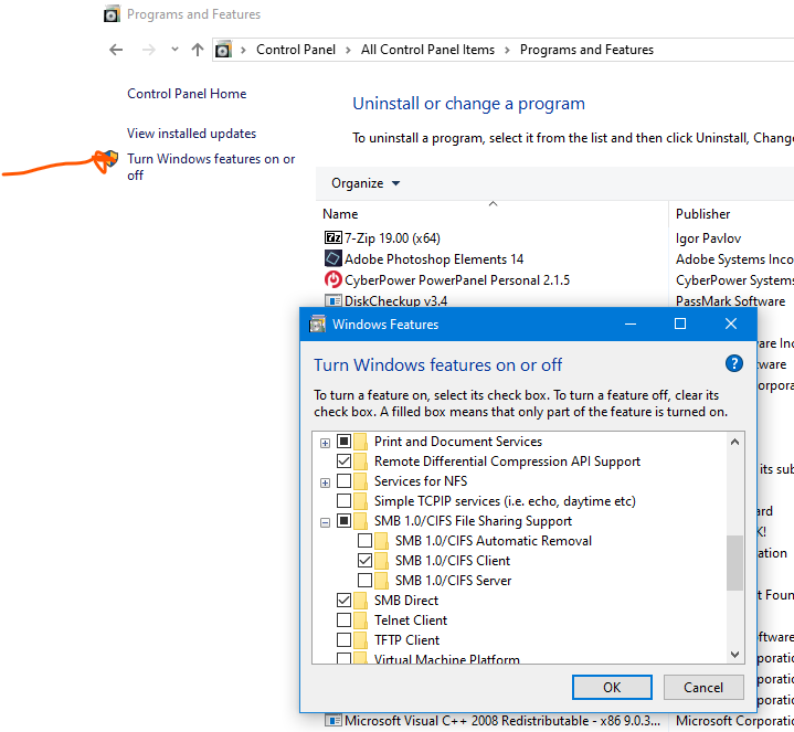

i activated the smb 1.0 and in windows edited the user groups, made a local account on windows added the server ip to the host file but to no success

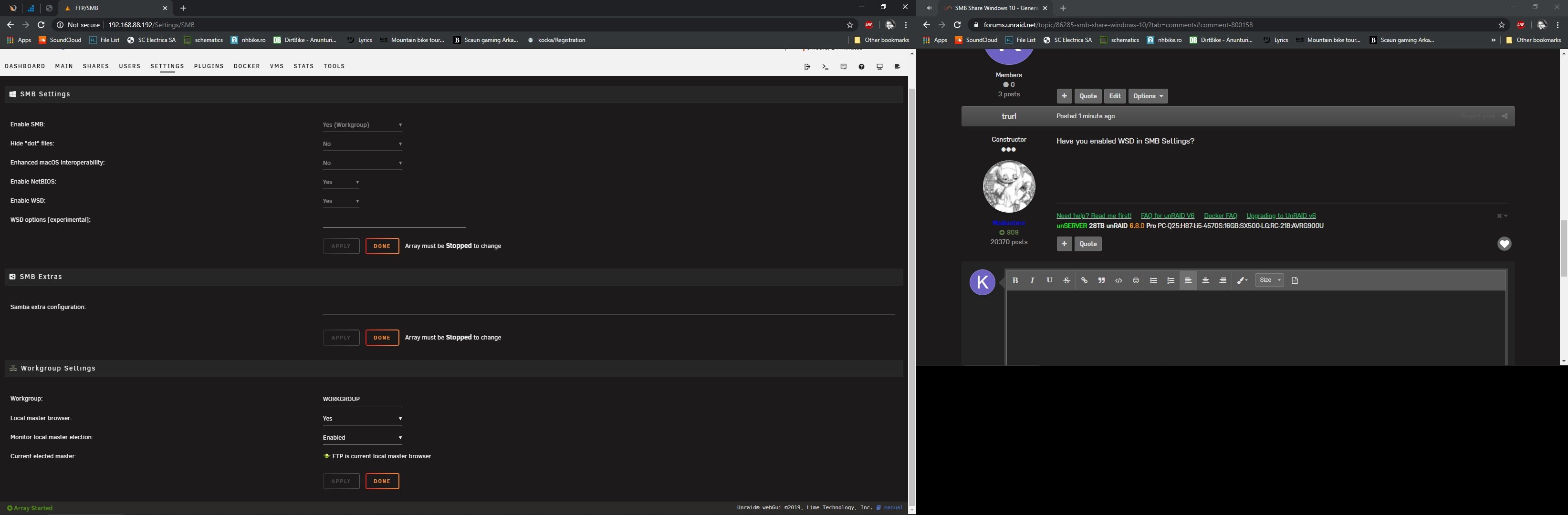

Have you enabled WSD in SMB Settings?
yes

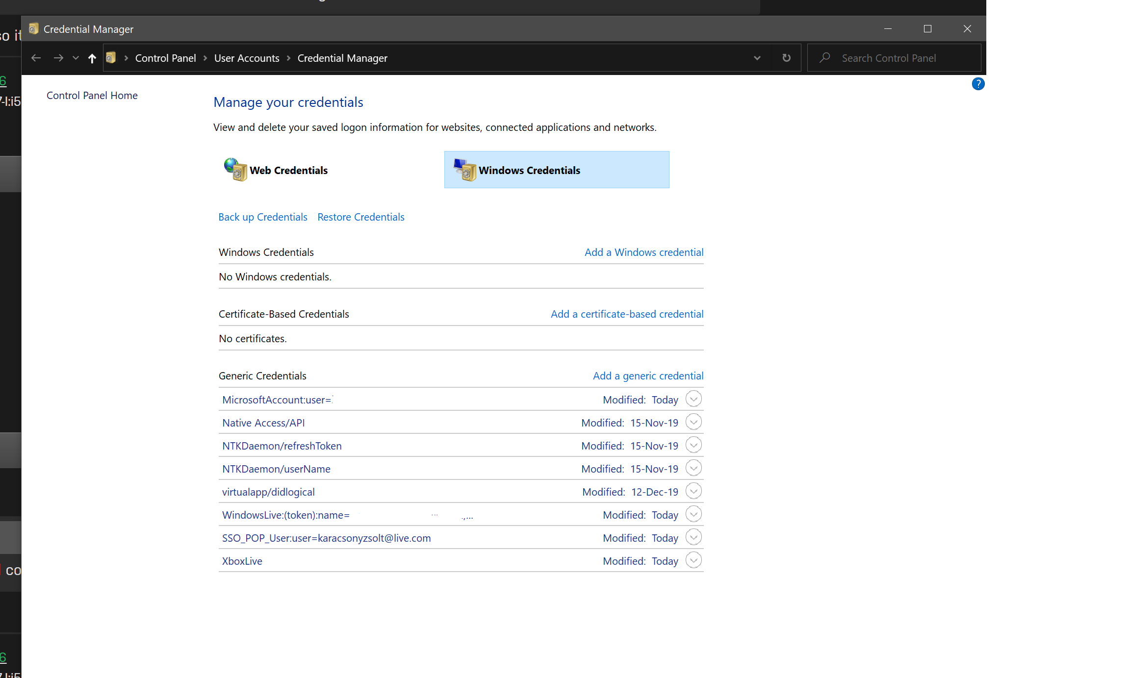

Go into Windows Control Panel - Credential Manager and delete any credentials for Unraid so they can be renegotiated.
did not find any pertaining to unraid i did create one whit the server IP and correct login credentials but same error
You don't need to create one. Delete it so it can be renegotiated when you try to access.
i did not find any for unraid
Then what did you mean by
these are the ones that i can see i made one windows and one generic one same results
You don't need to make any. They will be made for you when you first try to access the share.
In any case, it shouldn't matter for a public share. Are you still trying it as a public share?

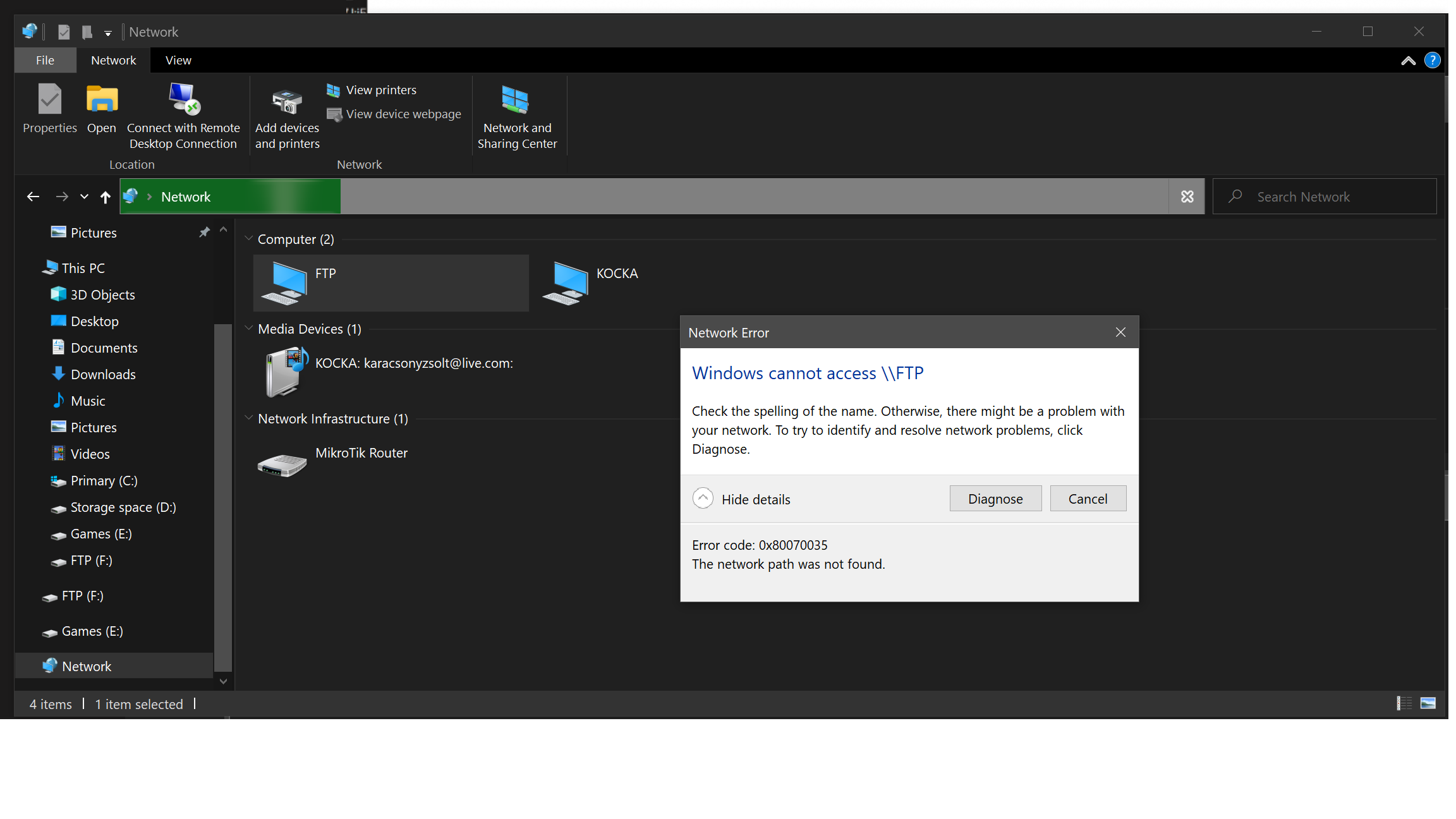

Can you post a screenshot of this "same result" you keep getting?

Did you do this:
no it`s my test rig.
it was the firs thing that i found and tried

same :(
