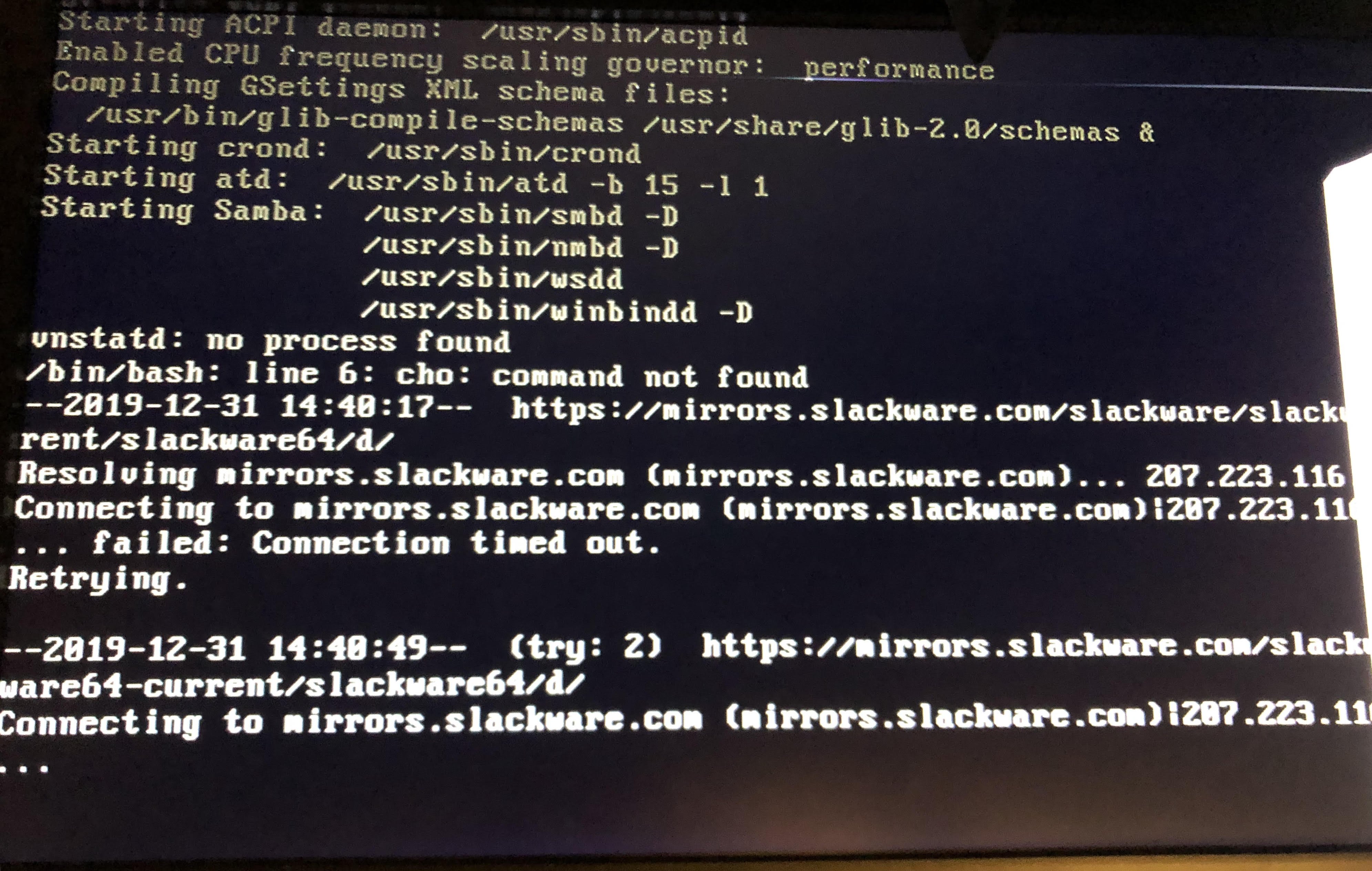

My server failing to boot during a reboot today. Im not sure.
I installed several dockers and a plugin before this happened
nextcloud
mariadb
networkstats
I suspect its networkstats that has caused this, the last thing I see is vnstatd: no process found. then it tries to connect to a slackware mirror.
Any help would be huge. Im not sure where to start. Does the usbdrive have a log I can pull off from another computer?
network stats is a plugin i suspect
you can shut down the server move the USB to a computer and go to /config/plugins
remove the netstats plg file and its folder then move USB back to the server and try and boot
that worked, thank you!
