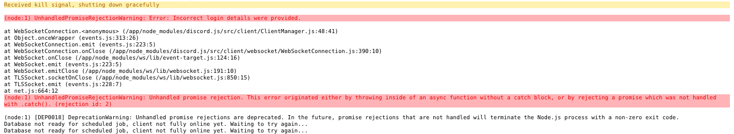

I keep getting the following after starting the container:
(node:1) UnhandledPromiseRejectionWarning: Error: Incorrect login details were provided.
at WebSocketConnection.<anonymous> (/app/node_modules/discord.js/src/client/ClientManager.js:48:41)
at Object.onceWrapper (events.js:313:26)
at WebSocketConnection.emit (events.js:223:5)
at WebSocketConnection.onClose (/app/node_modules/discord.js/src/client/websocket/WebSocketConnection.js:390:10)
at WebSocket.onClose (/app/node_modules/ws/lib/event-target.js:124:16)
at WebSocket.emit (events.js:223:5)
at WebSocket.emitClose (/app/node_modules/ws/lib/websocket.js:191:10)
at TLSSocket.socketOnClose (/app/node_modules/ws/lib/websocket.js:850:15)
at TLSSocket.emit (events.js:228:7)
at net.js:664:12
(node:1) UnhandledPromiseRejectionWarning: Unhandled promise rejection. This error originated either by throwing inside of an async function without a catch block, or by rejecting a promise which was not handled with .catch(). (rejection id: 2)
(node:1) [DEP0018] DeprecationWarning: Unhandled promise rejections are deprecated. In the future, promise rejections that are not handled will terminate the Node.js process with a non-zero exit code.
Database not ready for scheduled job, client not fully online yet. Waiting to try again...
501956243_ScreenShot2020-01-21at8_58_28PM.thumb.png.329d36150f4fc090cdb27046b8681b61.png
Any idea on how to resolve?
I have tested and confirmed that that error is the result of an invalid Discord Bot Token. Make sure you have a valid Token in the template and try again.
Go to https://discordapp.com/developers/applications/ Click on your Bot application or make a new one. On that application click the bot tab and copy the Token and use it in your template.image.thumb.png.b94c4c3b6f9a7956d2127979d832439c.png
Resolved. Thanks.

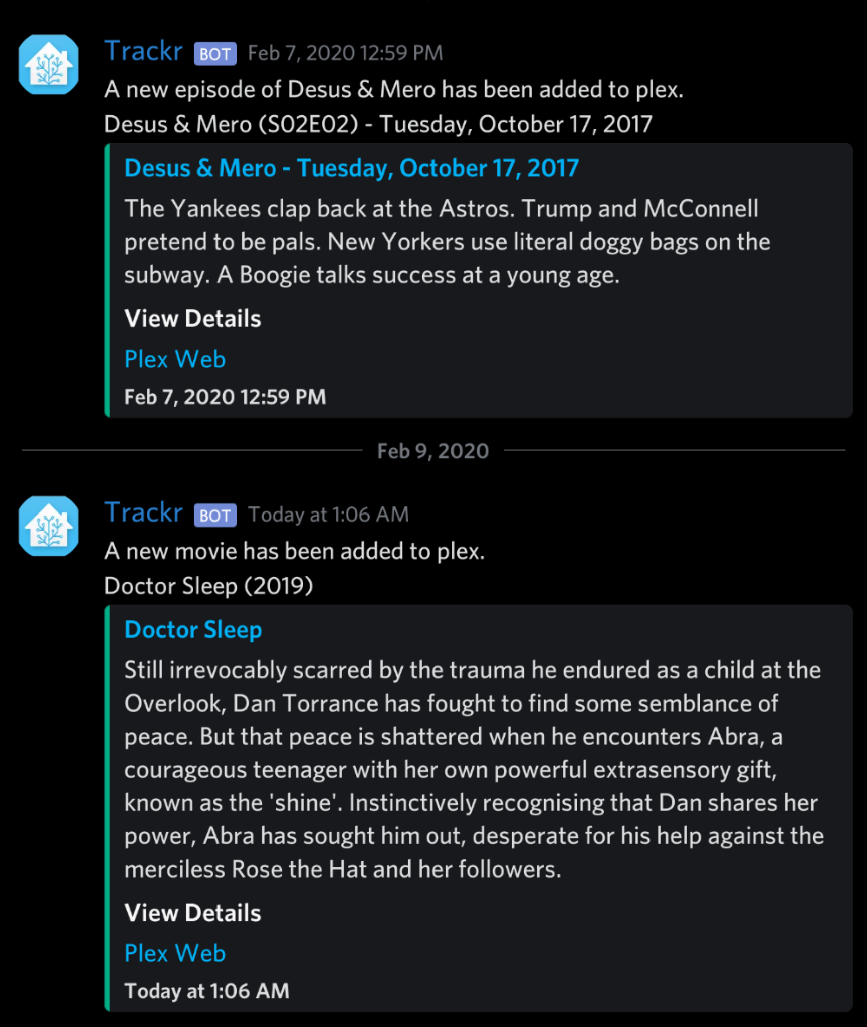

Would this work for Radarr? I'd like to be notified via Discord of movies added
Edited by Fiservedpi
@Fiservedpi
As of right now it doesn't connect to Radarr. You can have 2 types of movie based notifications though, triggered by the self-generated Tautulli recently added webhook. There is an All Movies react role and a New Movies react role (set if the movie was released within the last 9 months). These can be enabled with `!notifications edit`.
I have a few cool ideas brewing that may need a Radarr connection, so that may be a thing in the future.
Even if you don't select the movie react roles with `!notifications edit`, the #notifications channel you set up will still receive recently added movie notifications, just with no roles if none are enabled.
Sweet thank
EDIT: well look at that!! It seems to just work! For movies too. Must be the way I have my mapping set
@CyaOnDaNet how are you getting images? Associated with the notification, is the .jpg inside the file with the .mkv?
@Fiservedpi You don't need to worry about generating images in the sub-folders or anything, Tautulli can provide image URL's. The image URL has to be publicly accessible and is automatically grabbed from Tautulli when the notification is pushed. To use this, enable image hosting in Tautulli. Go to Settings > 3rd Party APIs and select an option from the Image Host drop down. I self host my Tautulli now but in the past I have used Imgur with no problems.
Cool ty
