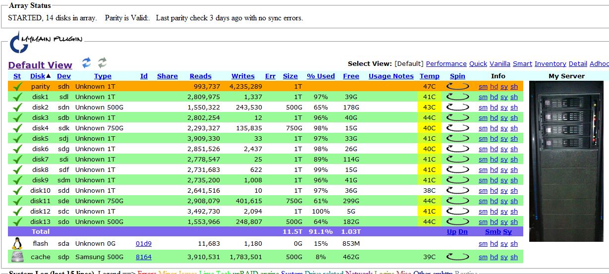

upgraded mymain
still some fields wrong or missing
see screenshot
type is wrong - ID not there for disks in array
I do not think that Joe L has deployed the update yet.  The reason the IDs were not showing is because unRaid 5.0b6a (and earlier 5.0 betas too I think) stopped returning the serial number as a separate field. Instead the serial number is part of the ID field and must be computed. This was definitely one of the fixes I made.

I'm about ready to upload the changes to myMain, but wanted to show what it is doing on my server.
I have NO HPAs, but I do have an assortment of older IDE drives in the array, apparently with sizes that do not fit the current rule embedded in myMain.
Perhaps the logic can be simplified to only look at the last two digits of the size instead of the last three?  That still won't fix the bottom two disks... They are an old 250 Gig disk and a very old 8 Gig disk I use for testing.

BGP99 asked me to test it before you uploaded it Joe L.
and i have same issue with my Cache drive :)
see screenshot
Uploaded with ImageShack.us
