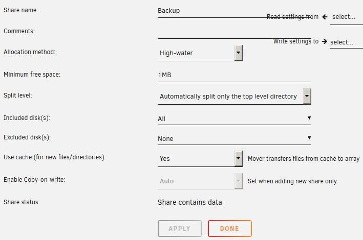

Ive got the same issue,  but with a 120G SSD cache. Checked all the share settings Ok. Cache disk has the appdata and system folders. the Domain and ISOs shares are not used as the box cant run VMs. The only share is "Backup" .
Writing files to the Backup share never uses cache!  Share is set to High-water, 1MB min,  Cache: Yes.
What should I look for to troubleshoot this?

Go to Tools - Diagnostics and attach the complete diagnostics zip file to your NEXT post.
Post a screenshot of Settings - Global Share Settings - Cache Settings

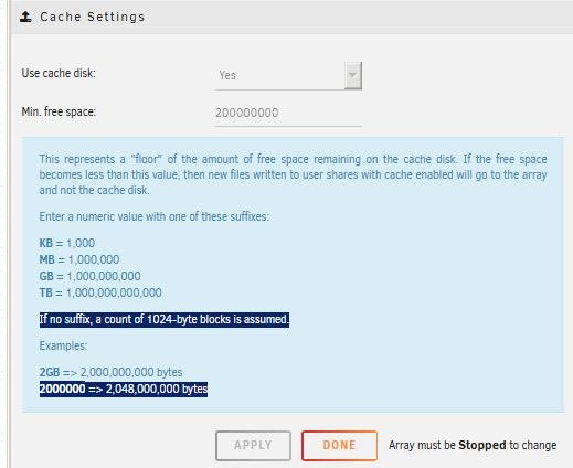

Hi,  Global Cache set to YES, Min. free space: 200,000,000, which I incorrectly assume as Bytes,  but apparently its 1024byte blocks (confusing)!  So that means the global floor is set to >200GB!
I don't recall ever looking at this setting so it must be the default.
Q1 - Is 200000000 the default upon installation, if so why so high ?
Q2 - Why do global settings override local settings,  isn't that the wrong way around ?
I've set the Global Share Settings - Cache Settings - Min. free space: 100MB
Now fixed.
Thanks for the very fast assistance.
Edited by lemoncurry
That was definitely not the default. I think that was 3 zeros too many.
The Minimum Free for cache is similar but different from Minimum for each user share.
Each user share has a Minimum Free. If an array disk has less than Minimum when Unraid decides which disk to write a file to, it will choose a different array disk. You should set Minimum Free for each user share to larger than the largest file you expect to write to that user share. Once Unraid has chosen a disk to write the file it will try to write the whole file to that disk even if it runs out of space.
For Cache Minimum Free, if a user share is cache-yes or cache-prefer, then if cache has less than minimum when Unraid decides which disk to write a file to, it will choose an array disk instead of cache. This is sometimes called "overflowing to the array". Note that a cache-only user share will not overflow (and a cache-no user share will not write to cache anyway).
Similarly, you should set Minimum Free for cache (in Global Share Settings) to larger than the largest file you expect to write to cache.
Ahh,  yes,  I got confused between Cache settings and Array share settings. Obvious now really. Maybe I did add the zeros back when I first set it up, assuming the setting is bytes. ie 200000000=200MB not 204GB!

If for any reason you need to edit that field it is much easier if you use one of the suffixes to specify the units being used.
