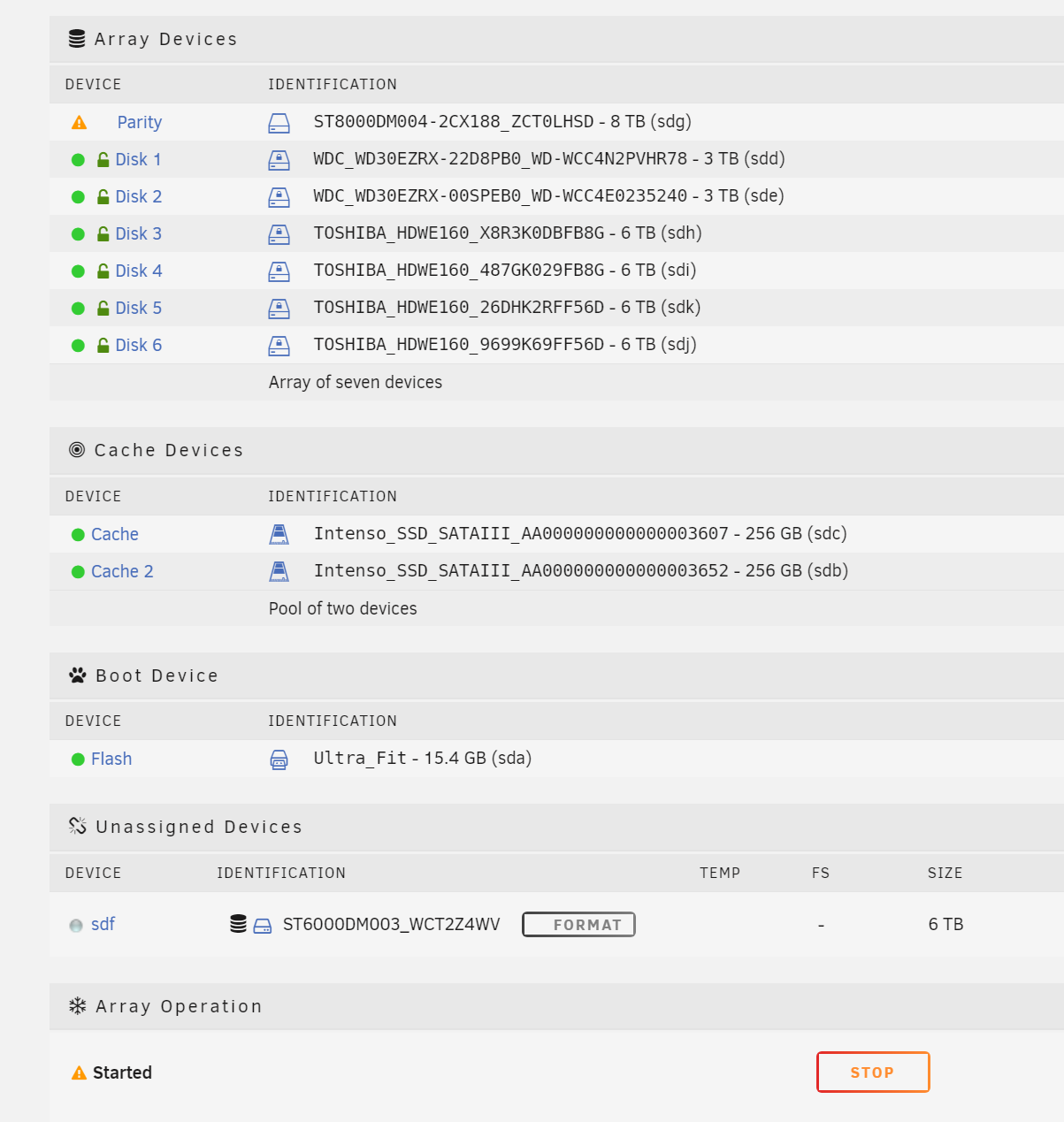

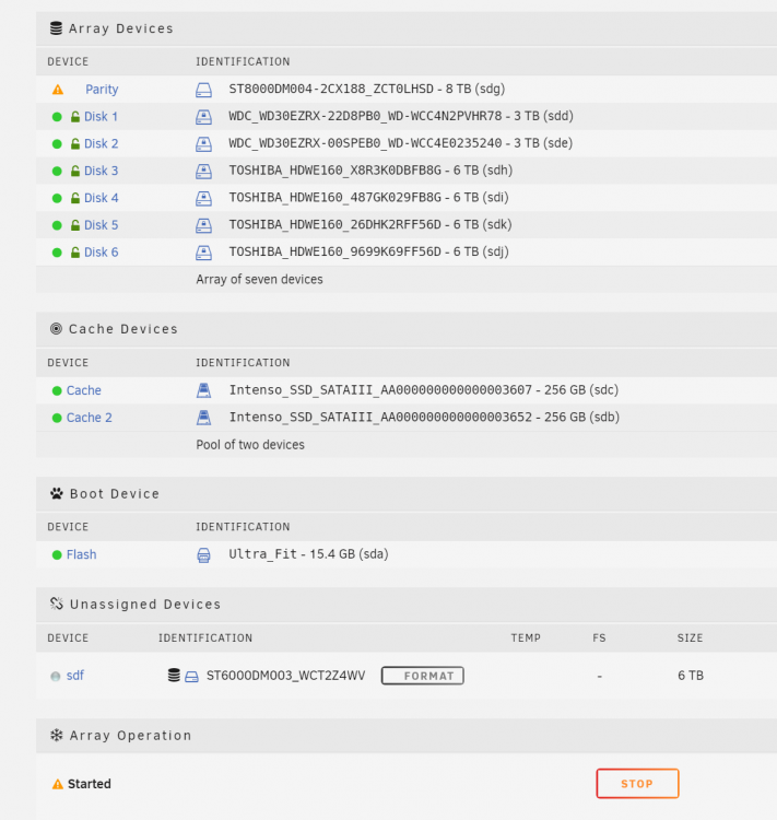

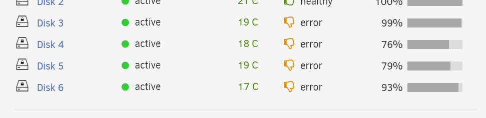

Now everything is available, but I can't mount the ddrescue-dest, although it was mountable before I changed the adapter, now the only option is to format.
The four Toshiba HDD still showing error state.
Which disk is that one? All array devices appear to be mounting correctly, though there are still ATA errors on at least two devices.
The unassigned device ST6000...
I can not mount it through UD
That's one of the disks having ATA errors (hardware problem):
