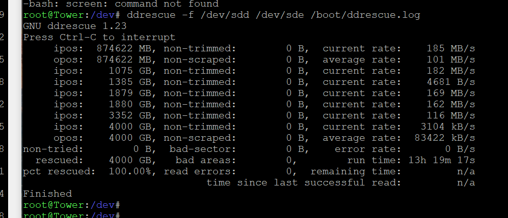

I hope ddrescue runs through now without problems, I will report at the end.

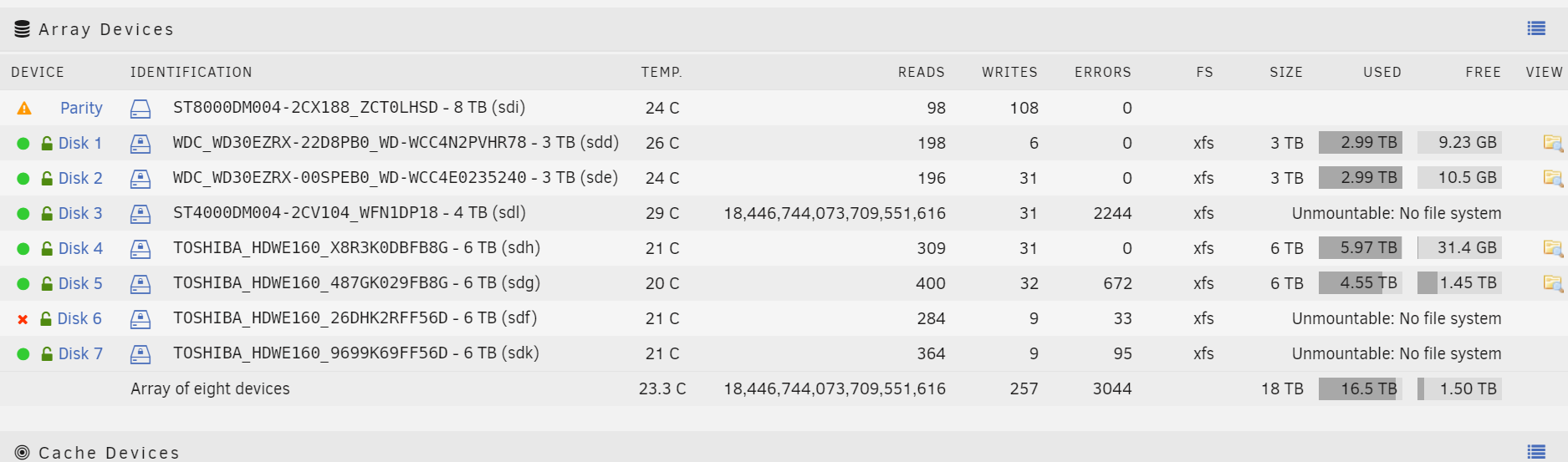

As seen attached, is it normal, thar there are no errors?
Disconnected any other disk than the "failing" 4TB disk and the new one (6TB).
Not that surprised since the disk problems didn't look like bad sectors, but that the disk sometimes was slow or not even initialized correctly.

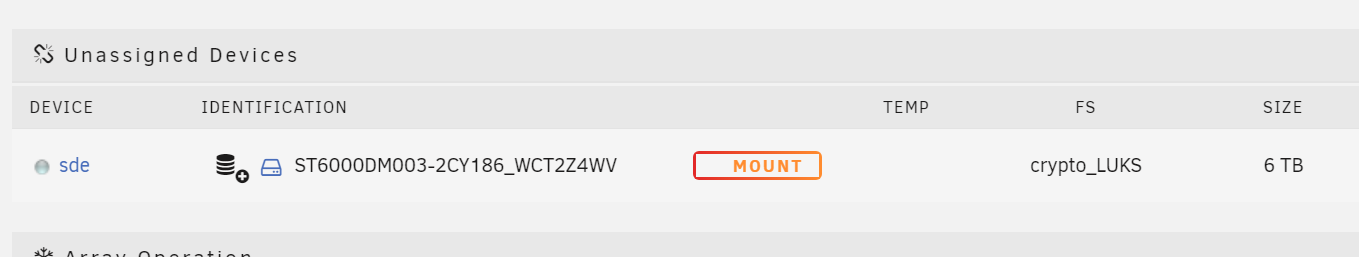

Should the disk be mountable right after disk clone?
Pushing "MOUNT" is showing "MOUNTING" for a few seconds and nothing happens.
Yes
Likely because of the encryption, UD uses the same key as the array, and since array is not started I suspect that's the problem, but would nee the syslog to confirm.

Like suspected there's no key and can't be get from the array.
Mar  4 11:48:49 Tower unassigned.devices: luksOpen: key file not found - using emcmd to open.
Mar  4 11:48:51 Tower unassigned.devices: Mount drive command: /sbin/mount -o rw,noatime,nodiratime '/dev/mapper/ST6000DM003-2CY186_WCT2Z4WV' '/mnt/disks/ST6000DM003-2CY186_WCT2Z4WV'
Mar  4 11:48:51 Tower unassigned.devices: Mount of '/dev/mapper/ST6000DM003-2CY186_WCT2Z4WV' failed. Error message: mount: /mnt/disks/ST6000DM003-2CY186_WCT2Z4WV: special device /dev/mapper/ST6000DM003-2CY186_WCT2Z4WV does not exist.
Mar  4 11:48:51 Tower unassigned.devices: Partition 'ST6000DM003-2CY186_WCT2Z4WV' could not be mounted.
If you start the array, even using a single encrypted disk, it should mount after that.

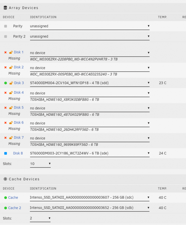

Too many wrong and/or missing disks!
Is there any "trick" or do I have to connect all drives again?
If you want you can do a new config to reset the array and assign a single drive, make sure you take note of current assignments, in case you want to keep them the same for later.

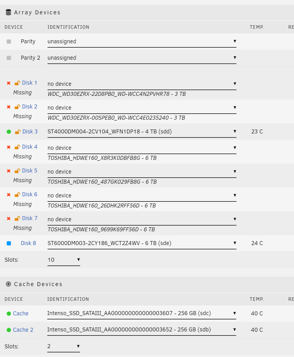

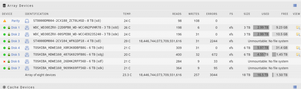

Wanted to try, but now the next problems when starting the array with all disks to mount via UD.
The ddrescue-dest also not available to mount.
tower-diagnostics-20200304-1355.zip
Edited by aurevo
There are errors on 4 disks, likely a connection issue.

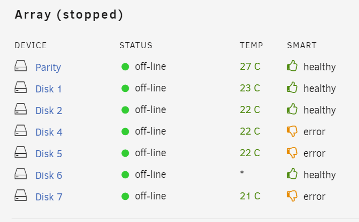

I disconnected the defective 4TB disk and now this is the state. One disk missing.
Parity, Disk 4, 5 and 6 are on Port 1 SAS-Controller.
Disk 7 and the ddrescue-dest are on Port 2 SAS-Controller.
SSDs and the both 3TB disks are on the mainboard onboard.
As I said before I changed the SAS-Cable yesterday so I do not think that it is the cable.
Also disk 4 and 5 seem to have errors which where yesterday without errors.
Why is disk 6 emulated or disabled but also shown as available in the disk slot 6?

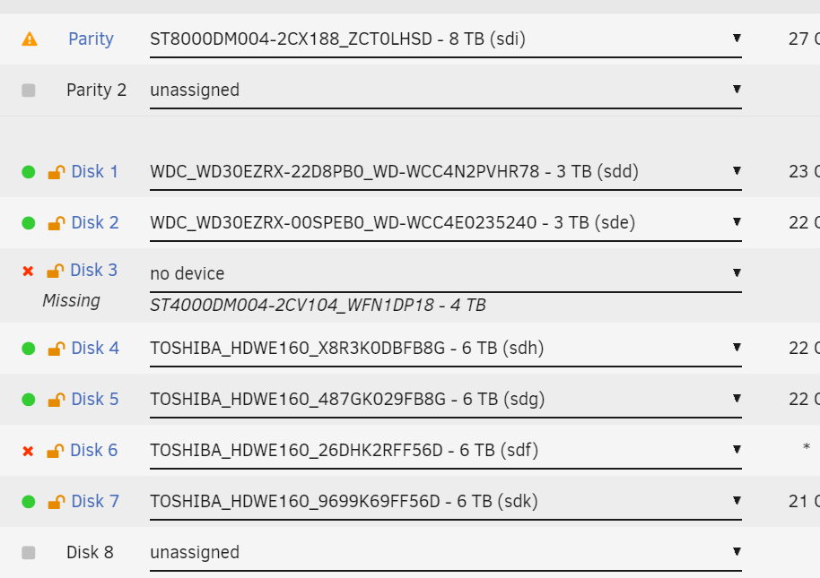

Can I do a new config without the defective disk3?
Or should I use Preserve current assignments?
4 minutes ago, johnnie.black said:
Without old disk3.

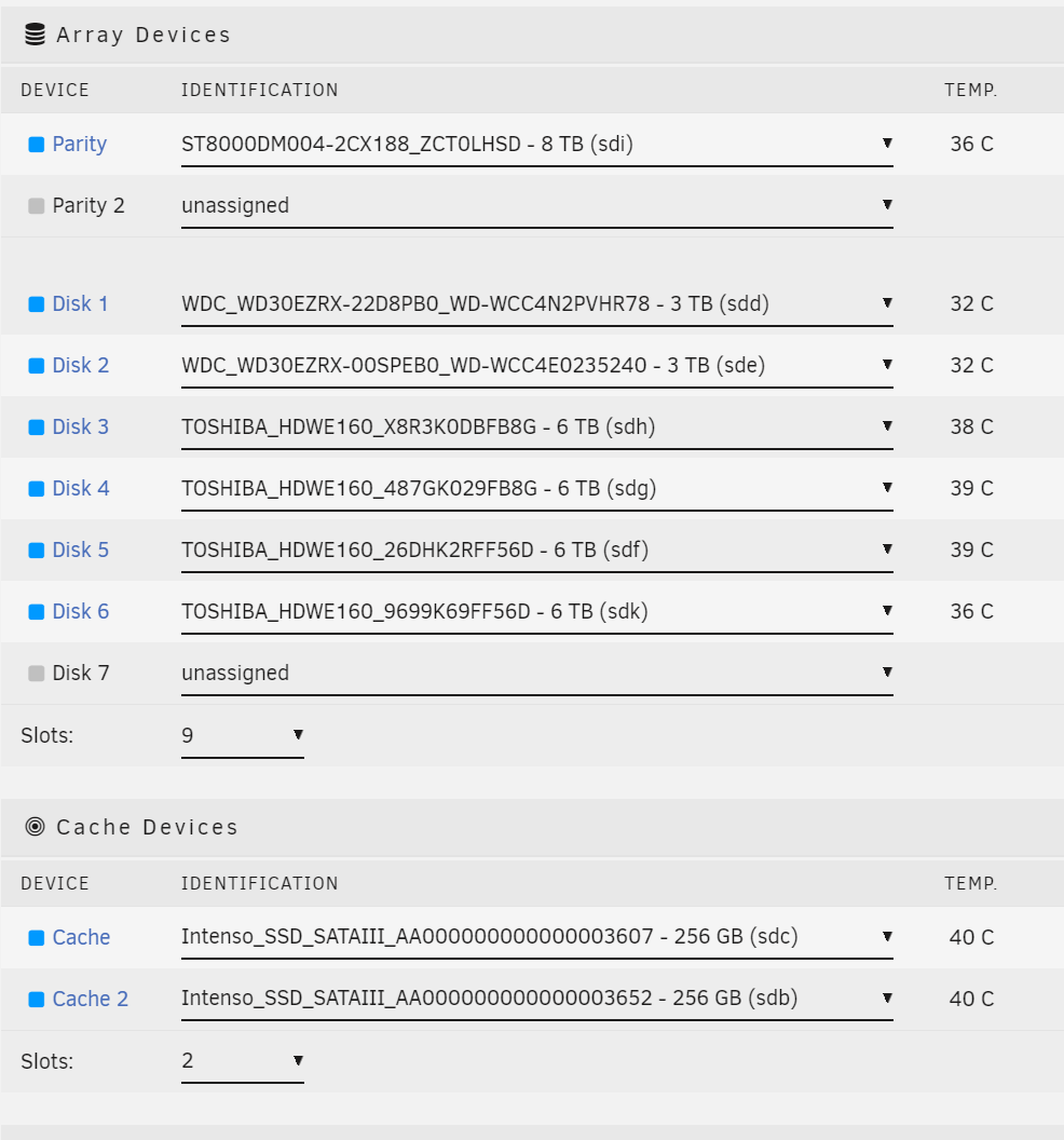

So I could start like this?
And is my Windows VM on the cache devices affected or deleted?
