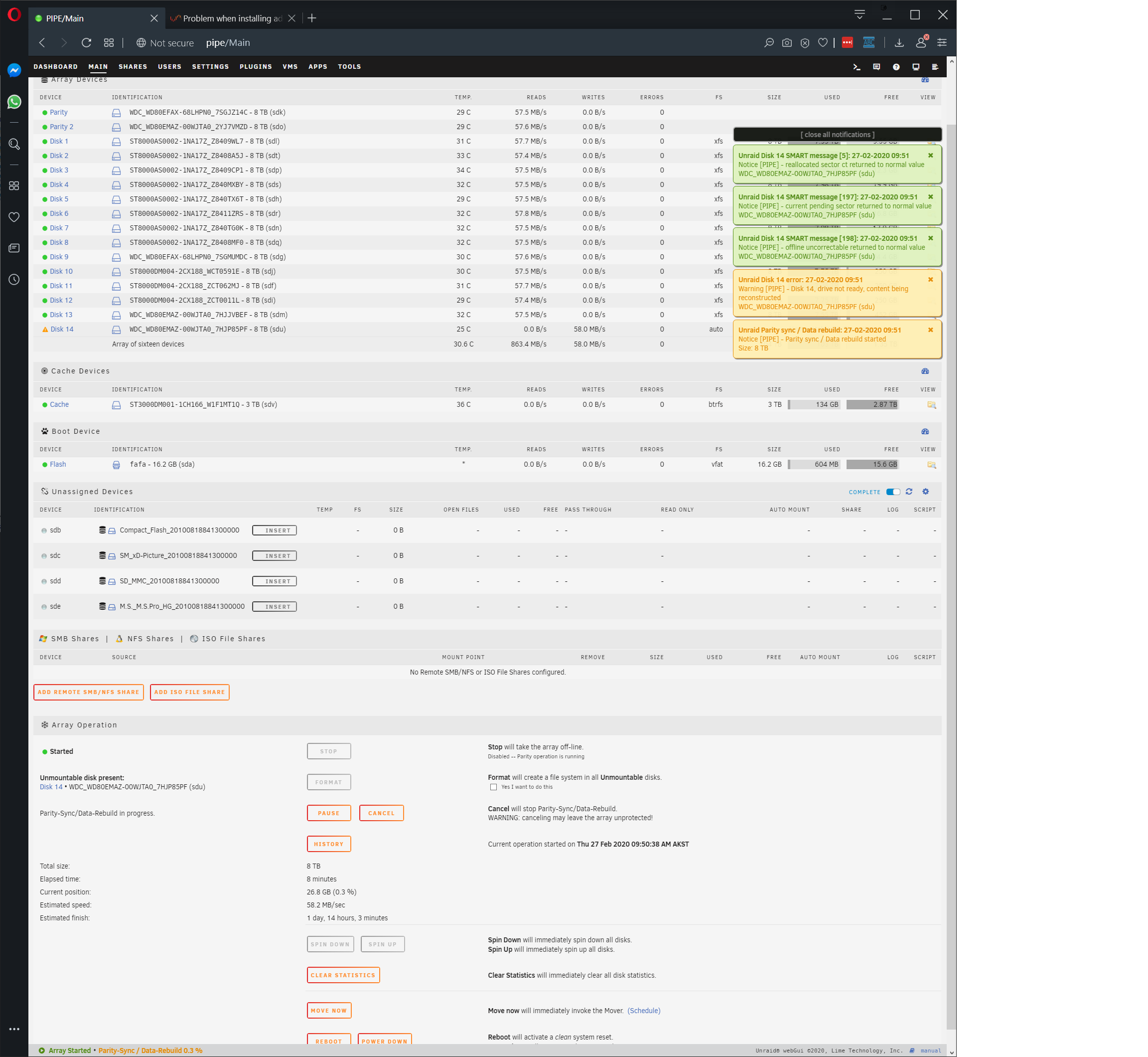

OK - so i have put another drive in slot 14- which was formatted xfs and pulled from the 2nd unraid system.  It was unmountable - so i formatted it, at this point it is formatting as far as i know, but in doing so it is reading from all drives which is more like a parity check right?  Is it normal in this case - see screenshot.  If so, i will mark this thread solved  I assumed that a format would not require reading of the rest of the drives, but to be just writing zeros to the new drive.

better screenshot - showing entire unraid screen
It is rebuilding the disk just like it would always do if you replaced a disk in the array.
