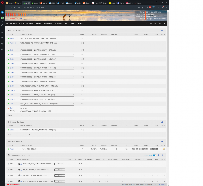

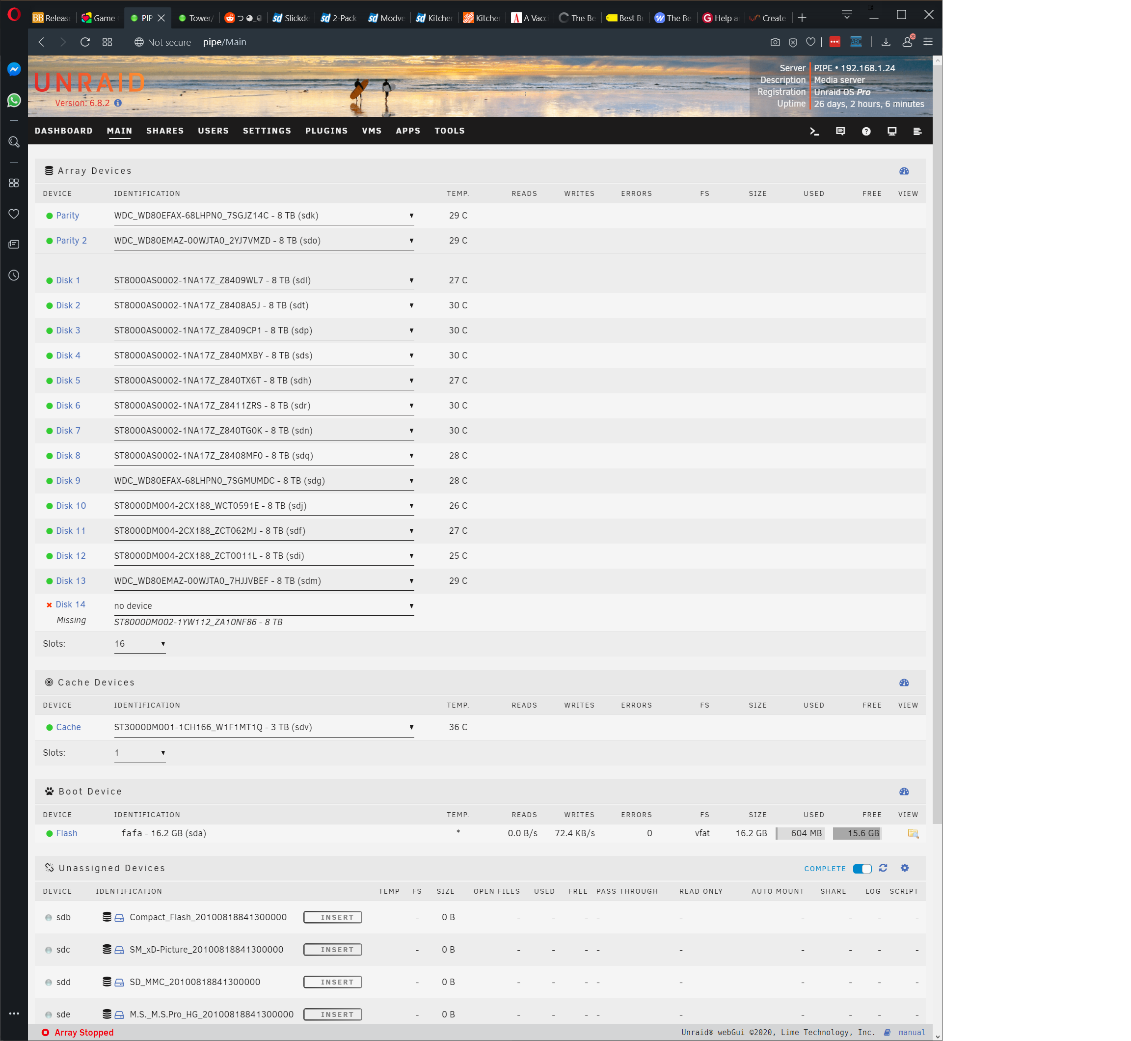

I shut down the array, added one slot (#14), then added a drive 8tb which was labeled as precleared.  Recieved smart errors right off the bat on the precleared drive - my assumption is that this drive is bad
So i stopped the array - now it treats new slot (#14) as if it were a missing disk.
Is this normal behavior because the drive was labeled precleared even if the array was only run for a few minutes?
Should i just run the array for as is for days or just remove disk 14 - i am assuming that will force a data rebuild?
Is there an easy way to just go back to the array as it was until i can free up an 8tb drive (probably will take 4 days to get)?
I have attached screenshot and diagnostics - look feb 25, 1100 am for problems to start.
Thanks in advance.

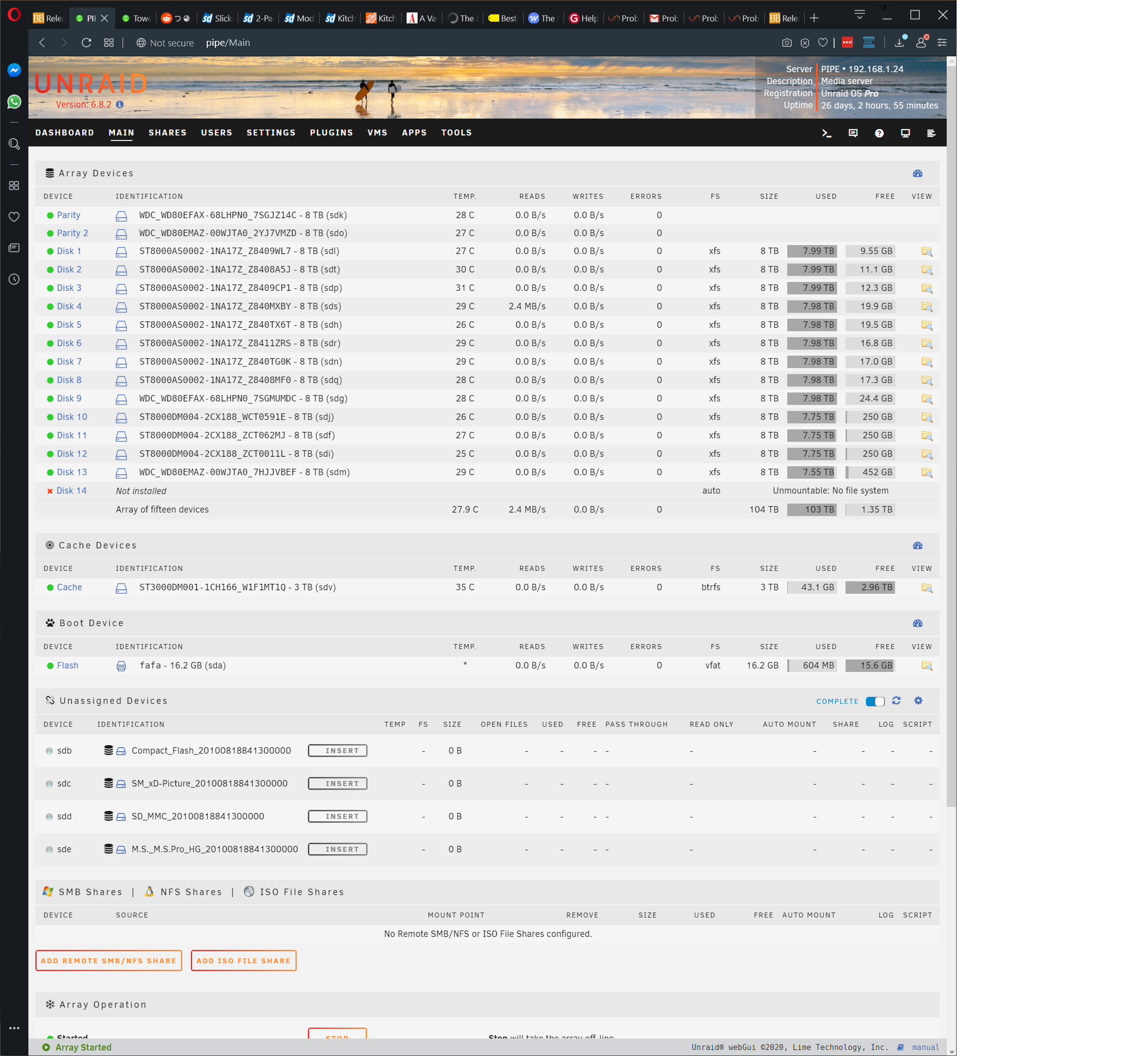

it appears to have parity  - see screenshot.
3 minutes ago, civic95man said:
That doesn't seem right... if a precleared disk was added to the array then parity would still be valid. Rebuilding parity with the missing disk would lose any data on that missing emulated disk. if in doubt, do a non-correcting check and see if you have any errors first. But any additional stress on the system with an already emulated disk may cause more to drop.
You might be correct, as the precleared disk would be all 0s, the parity would still be valid as no bits (bytes?) have changed.
non-correcting check would be the best way to go either way.
It's un-mountable. I would have though that preclear would put a file system on it for unraid to use. Was it un-mountable when you first put the disk in the array?

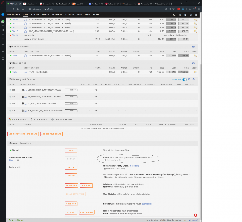

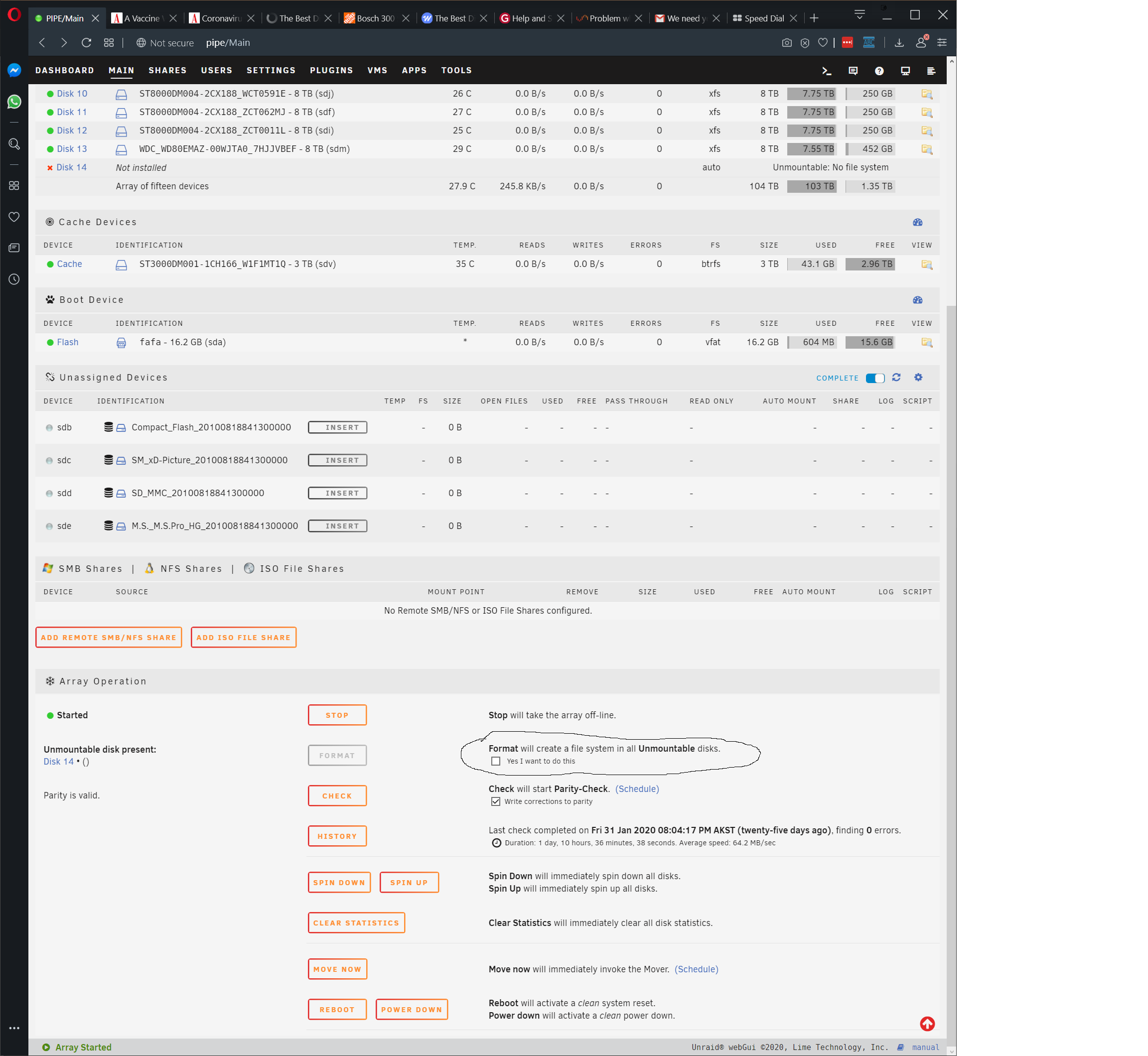

This screenshot (shows asking to format) would be in line with the theory that it would be ok to do the new config and say parity is valid? Being very cautious here, since i am not 100% sure i would be doing right thing.
Yes, if the new disk was precleared and never formatted then parity is valid without it, still you should run a parity check after the new config.
