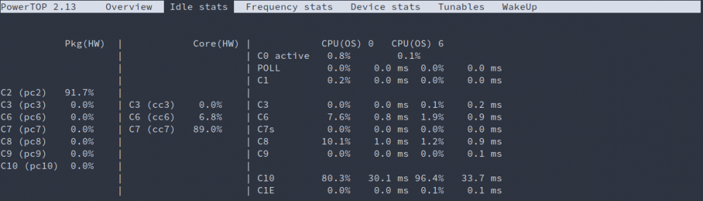

Introduction: The system contains all parts listed in 1 with 1.1 as an upgrade. The Samsung 860 EVO M.2 with its controller is marked as passthrough device. For the measurement there is also no device connected to the Inatek KT4006, no other USB devices attached to the host either and no display plugged-in. The iGPU is blacklisted hence it is used for VM passthrough too. I use VM's as my daily driver with an external display connected. I need the Inatek KT4006, because I couldn't get my audio interface Presonos AudioBox USB reliable working otherwise.
Bios Settings: The mainboard does not come with a lot of power saving settings in the BIOS. I have disabled audio, enabled Intel Speed Shift, enabled C-States and set C State Limit from AUTO to C10.
Boot parameter:
kernel /bzimage
append video=efifb:off,vesafb:off modprobe.blacklist=i2c_i801,i2c_smbus,snd_hda_intel,snd_hda_codec_hdmi,i915,drm,drm_kms_helper,i2c_algo_bit initrd=/bzroot
Measurement:
1. Unraid idle, all disks spin-up, powertop --auto-tune: 26W
2. Unraid idle, only cache spin-up, powertop --auto-tune: 19,6W

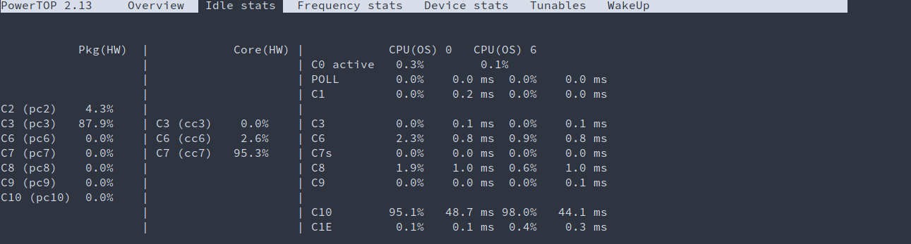

3. Unraid idle, only cache spin-up, powertop --auto-tune, Ubuntu VM idle: 19,9W to peaks 21W

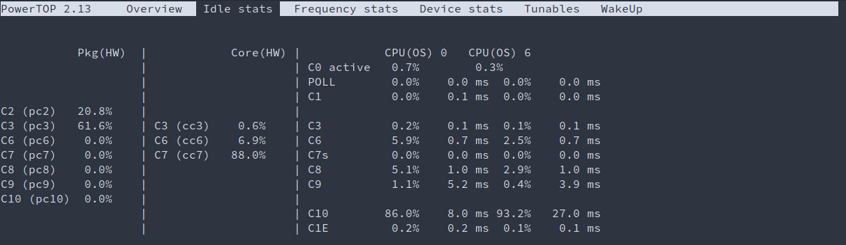

4. Unraid idle, only cache spin-up, powertop --auto-tune, Ubuntu VM shutdown: 18W
