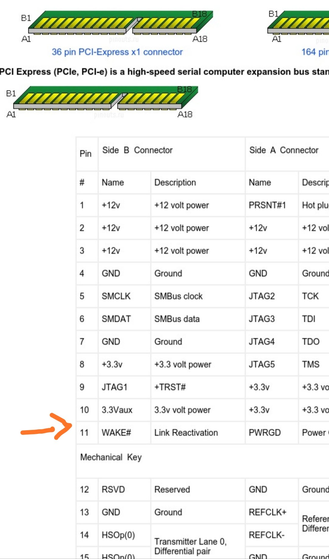

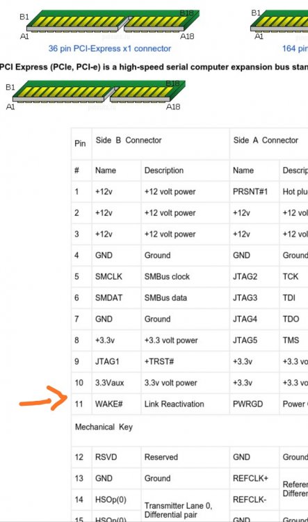

Then pls try tape (mask) the B11 pin. Components side is B side.

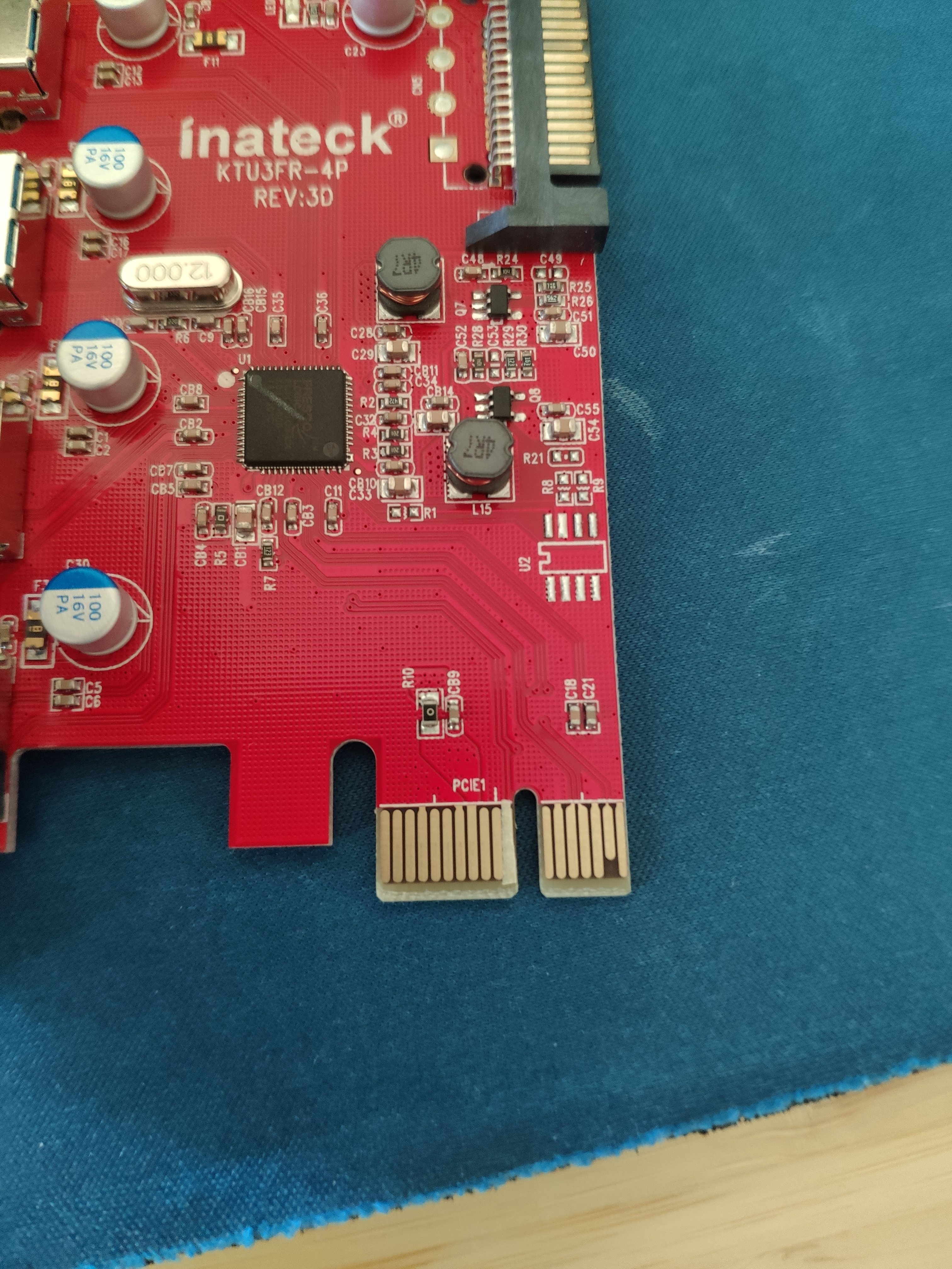

Sadly the tape trick didn't work.
It should my fault, I googling more deep and seems I oversimple PCIe and ASPM stuff.
