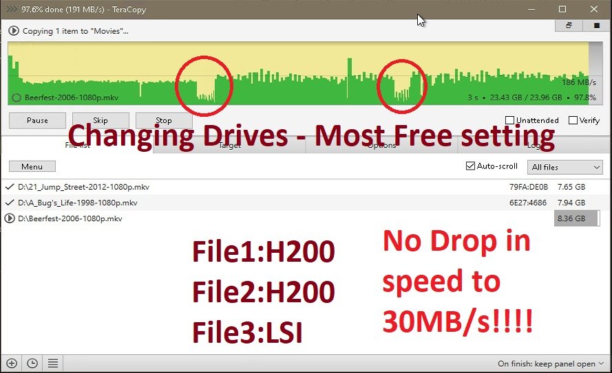

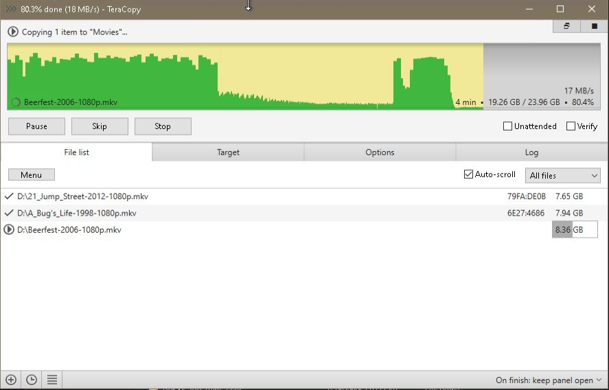

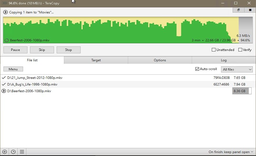

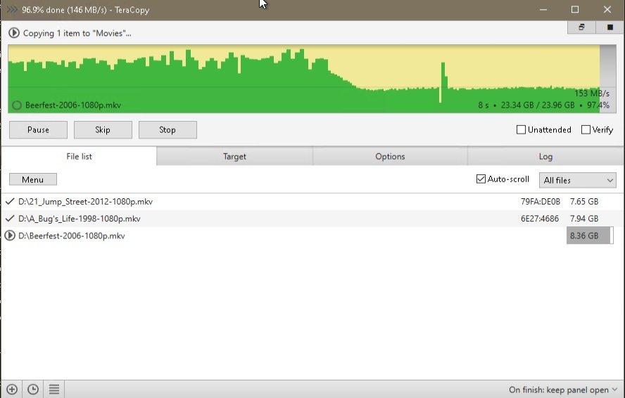

3.  This is all great stuff but it seems I have another issue that is slowing my transfers down when using the "Most Free" option.  So I'm not really sure what to do at this point. Has anyone confirmed this happens to them when using the same share options?
Attached are 2 screenshots.  I used TeraCopy to graph the transfers.
Comparing Most Free to Fill up Share settings:
NO other changes were made at all.
Same files from same source.
NOTES:
  • The first 8GB file didn't drop below 300MB/s using Most Free
  • The 2nd File transfered about 1GB of data before it slowed down to 50MB/s and then got lower to 30 MB/s using Most Free
  • Surge in 3rd file but then slowed down to 20-60MB/s using Most Free
  • The first and 3/4 of the 2nd file transferred at 300MB/s+ using Fill Up.  Just started to drop towards the end of file 2.
  • The entire transfer never slowed down under 130MB/s using Fill up and really stayed at around 150MB/s afterwards.
Anyone else???

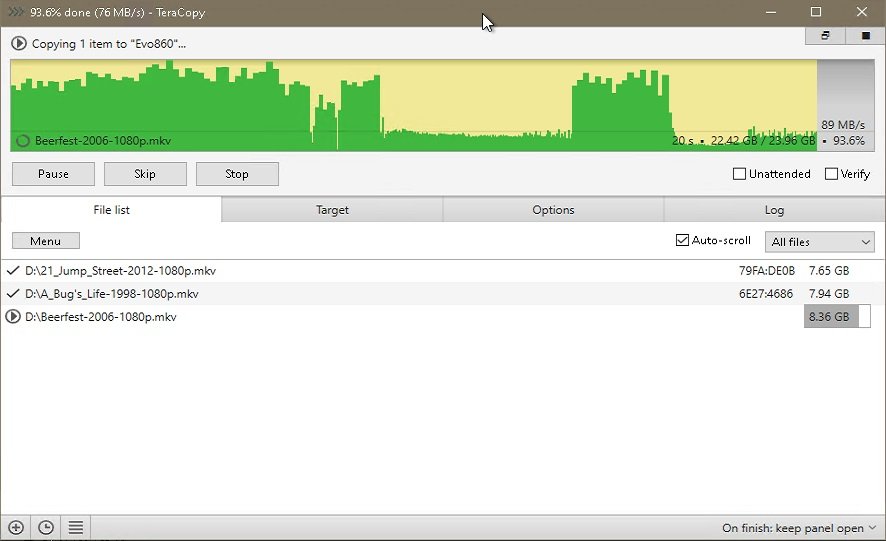

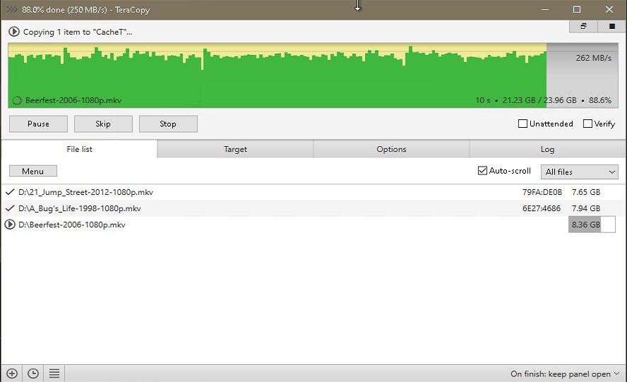

Tests:

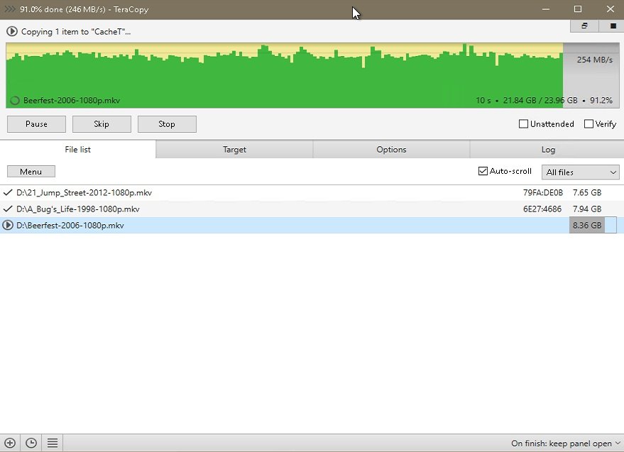

Test 1: Transfer to just Cache Drives (2x 1TB SSDs RAID1) (defaults) using Most Free, High Water and Fill Up

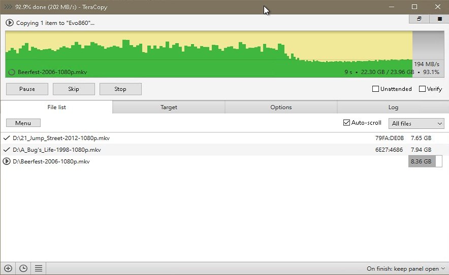

Test 2: Transfer to just SSD without parity (Evo 860 SSD) using Most Free, High Water and Fill Up
Attached are screenshots named with each operation.
Same 3 files from same source for each transfer (roughly 8GB each)
Share settings:
New share created for each drive test (total of 2 shares were created) and modified Most Free and Fill up settings.
Cache Setting: "Only" for Cache Test
Cache Setting: "No" for Evo 860 Test
Notes:
  • I tried Most Free, High Water and Fill up with no difference in results to the Cache Drives
  • SSDs easily capable of hitting 400MB/s locally consistent but I never saw above 260MB/s transfering to the Cache
  • When using the Mechanical drives I would get 350-400MB/s for the first 2 files
  • Really odd results from Test2...
  • Transferred to the 860 using High Water and it pretty much saturated the 350-400MB/s the entire time but then dropped to 200MB/s? (Same Results with Fill Up setting)
  • Transferred to the 860 using Most Free and.... WTF?  Its not doing parity nor changing drives here but for some reason it drops down to 20-80MB/s.  There is a surge at the start of FIle 2 and File 3, but drops down.  This is what I am seeing from my mechanical drives using the same Most Free option.
Conclusion:
Something is wrong with the Most Free Option!
Something is wrong with the Cache (there is no way there is that much overhead from a Raid 1 to drop it down 100MB/s)... or is there?
IDK wtf is going on with my 10G network link.  This is another issue outside of this topic but I can only get 3.5Gb/s peak.

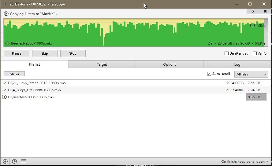

Well it isn't helpful in solving the problem, but I can confirm I experience the exact same behavior. I duplicated your set up, and using teracopy or file explorer in windows, I show the same results. I am disabling parity right now and I will confirm if that solves it or not.
Though, regardless of disk fill up setting, both transfers dropped off for me after about 8gb were written.
Edited by david11129
I disabled parity and it transfers the entire time at line speed. I suspect this is why they suggest disabling parity until your initial data transfer is finished.
Presently I am running a transfer to my cache drive and will update when it's finished.
Ok. my cache transfer ran at full line speed, regardless of share setting. Neither one ahd an impact on the transfer, but I am also only running gigabit. I have to wait for my parity to rebuild before I can run any other tests on this.

Just theorizing here, but it may be that when the second transfer occurs, the first is still being written from ram. Linux uses the ram as a cache for writes and lots of other things. So instead of being a synchronous write, the disk spindle is having to move a bunch to write the new date, and the data the was still in ram from the first transfer. They most likely aren't being written right next to eachother and the extra spindle movement is going to increase overhead. I have 96gb of ram, and I believe I changed the amount of ram to use to cache writes.
After parity completes, I will attempt to increase the ram cache size and report results.
Edit: just checked and my ram cache is set to 10% of ram size. That means that up to 9.6gb will be used to cache writes. That makes sense because that is about when the transfer falls off for me. So after the ram cache is filled, it is both writing that data to the disk, and I am sure it is writing the second transfer straight to the disk.
Edit: Increasing the ram cache to 35% did work. I transferred 32gb of files at full line speed. Once the cache fills up. that would decrease a bunch, especially with the parity operation going on now. I believe this is probably just normal behavior for a parity protected array that isn't striped. Spindle overhead and parity calculations are going to come into play once the ram cache is filled.

I ran several tests with many different results.
Summary:
Tests I ran:
  • Test 1: Transferring to Mechanical drives, no Cache, using parity with Most Free, High Water and Fill Up settings
  • Test 2: Transferring to Cache Only drives (pairty is out of the loop here) using Most Free, High Water and Fill Up
  • Test 3: Transferring to a stand alone SSD (no parity here and no cache) using Most Free, High Water and Fill Up
Same 3 files from the same Source.
3 Files were roughly 8 GB each
Results:
  • Test 1 and 3 had similar results when using Most Free share setting.  MASSIVE slow downs! One had parity one did not.
  • Test 1 and 3 had similar results with peaks throughput speeds (350MB/s).  One had parity one did not.
  • Test 2 was slower peak throughput than both Test1 and Test 3.
  • Test 2 did not see any difference in share settings (Most Free, High Water and Fill Up)
  • Test 2 NEVER slowed down (same speed with all 3 files)
  • Test 3 Had an odd slowdown at then end of file 2 (roughly 15 GB into the transfer) using HighWater.  Dropped to 160-200MB/s.
  • All tests had similar results between High Water and Fill Up settings.
  • Results were consistent between TeraCopy and Windows Transfer.  (So the app on the sending side did not play a factor)
  • Test 1 using High Water (or Fill Up) had expected results around the middle of file 2 where it is maxing out the mechanical drive speed (130-160MB/s).  Likely when the Cache ran out.
  • Test 1 will transfer an entire 8GB files at 350MB/s (Maxing the NIC speed) and about 1 GB of the 2nd file at which point it will slow to 30-70MB/s using the Most Free Option.
Conclusions:
  • Something is wrong with Most Free option when NOT using Cache
  • Something is causing massive slowdown of Cache when writing directly to it (250MB/s is really slow for SSDs)
  • I'm not convinced that Turbo write is being set properly on Most Free share setting (perhaps a bug).
  • Parity does not seem to be the issue when transferring to the HDD, more than likely the share setting of Most Free is bugged. Expected results when using Fill up or High Water
  • Not sure why the Direct transfer to the SSD slows down at all... No cache, No parity.  It should stay at the initial transfer speeds (350MB/s) as it did with the first 2 files (slow down started just at the end of the 2nd file - 15GB ish).

Thanks for this.  Even more interesting results after messing with this.  I'm not able to explain what is happening here...
Notes:
  • Set Dirty Ratio to 1% so 480MB (basically nothing)
  • As expected no massive surge in file transfer
  • However... I did NOT have a massive drop in speed and the  UI didn't report Reads on the parity drives as it did with Most Free setting before.  Is the problem gone now that I reduced the dirty ratio???
  • Fill Up and Highwater just maxed out the Drive speed, roughly 150-200MB/s the entire time.  Consistent with other results just without surge.
  • The cache drive had no change (its appears to not use this dirty ratio setting).  Still not sure why the cache SSDs are so slow (250MB/s)

Per my last test this time I set the dirty ratio to 40% and tried Test 1 again (write to HDD)
Using Most Free:
Just cruising along at 350MB/s and then BAMMMM  Down to 10 MB/s after that RAM maxes out. 4m22s  WHY DOES IT DROP?
Using the Fill UP setting:
It just crushes all 3 files at 350MB/s non stop transferring 24GB of data in 1m22s.  Clearly this exceeds 40% of 48GB of RAM (19.2 GB ish) but yet it kept going at 350MB/s, WHY?

I'm so confused on what is happening.  It has to be a bug and honestly all these unsolved cases in the forums that report slow speeds.. it's probably this.
As for CPU I have it set to performance  (I plan to run Plex on here and maybe some VMs for testing) I have a P2000 GPU to setup as Hardware transcoding as well. Thus the entire reason behind switching from FreeNAS to UnRaid in the first place.   I also like the idea of not losing data if the array fails, so that's a plus.  I don't really need 10G speeds to stream, my internet upload is really the bottleneck there 1Gb/s (up and down).  So I will max out my internet before I max the drive out.  At least that is my thought behind bandwidth.  However... internal network transfers I need to resolve this 10G link only working at 3.5Gb/s.  That is my next task after I figure out this issue.
I think we have ran enough tests and I'd really like to know if this is a bug or a "feature".  I can't image my last tests are "working as intended".
