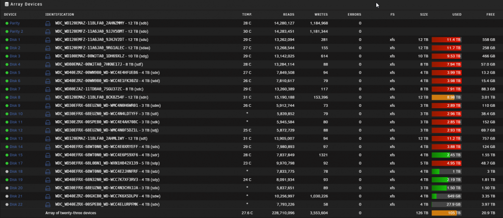

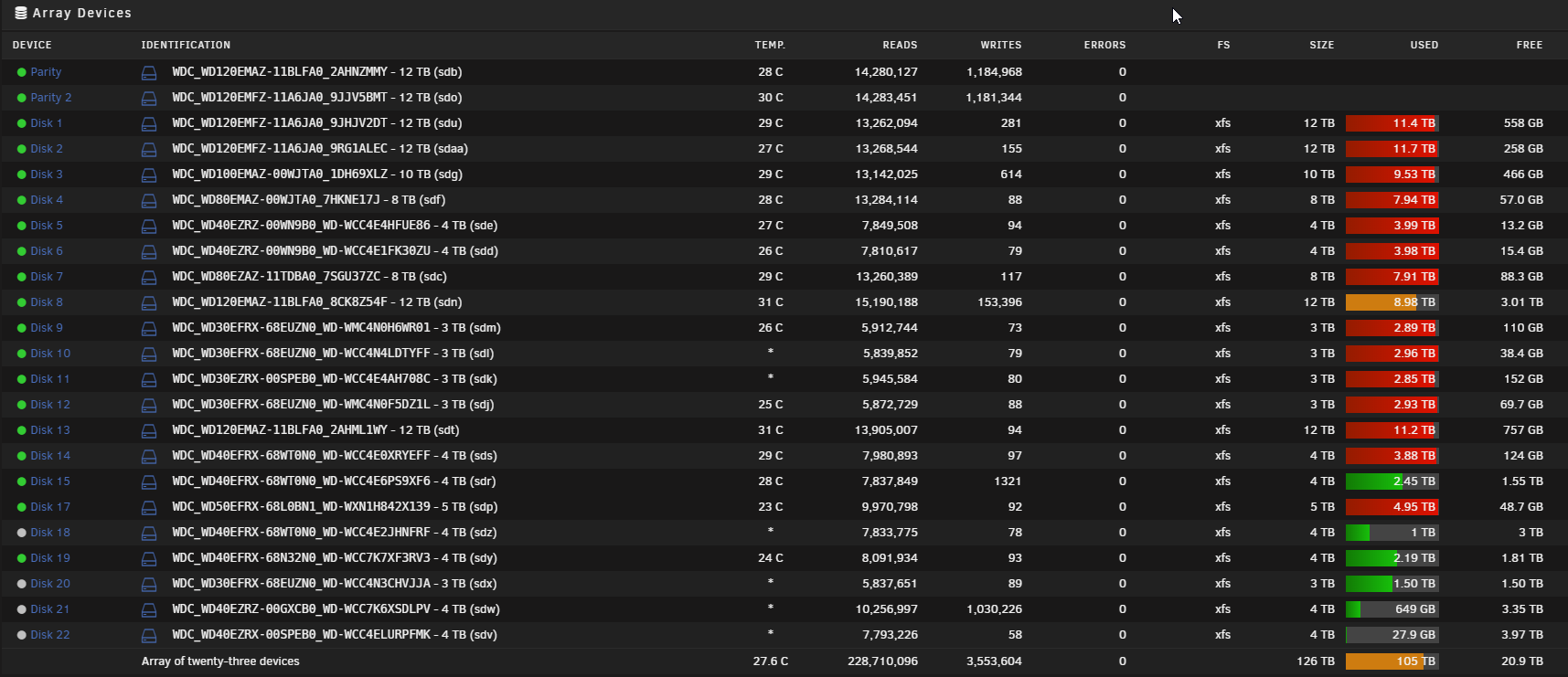

2 - 12TB parity drives and the other 22 drives on that backplane are data, image of array attached and current diagnostics.
Running Diskspeed now, looks like the parity drive possibly the bottle neck, though with a parity check running, I don't know if that's valid.   I'll run another once the parity sync ends.
