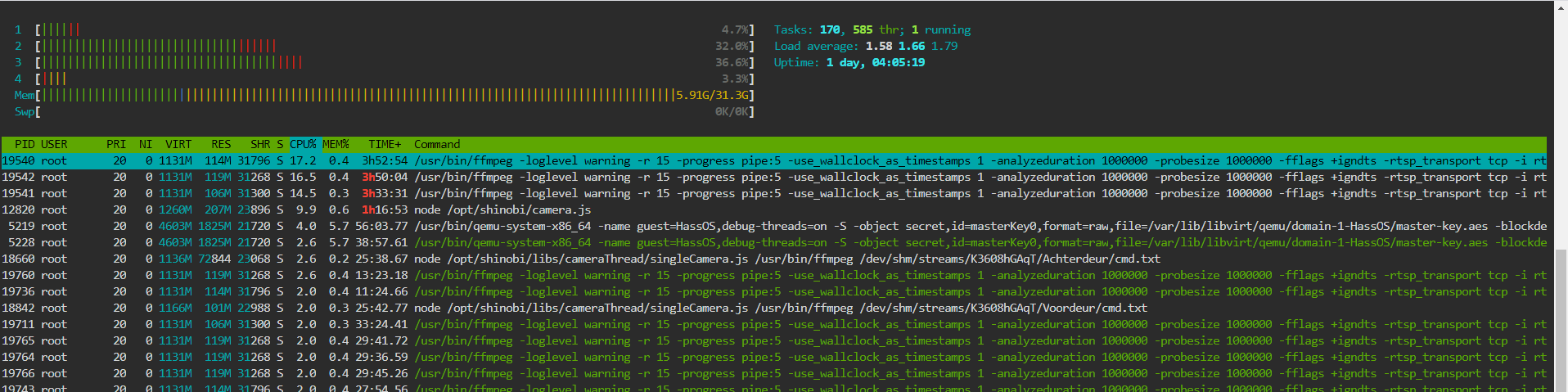

My server is recovering after several minutes. It doesn't need any reboot. I'm noticing now that my unraid server doesn't have any SWAP storage allocated. Is it possible that this could be the problem?image.thumb.png.bf2dabab685654f1b890c95dd7d9ce2e.png
