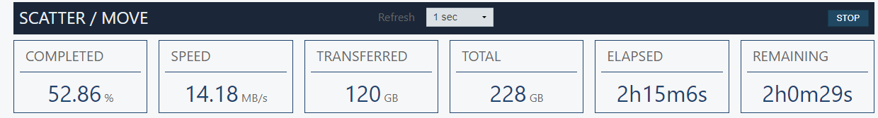

March 26, 20206 yr I just added a second parity disk. That went fine. Now I'm trying to empty a disk (using unbalance) so I can finally change the few riserfs's I have left. Before dual parity, the move was about 30-45MB/s... Now with dual parity I'm hovering 13-15MB/s Is this expected? Thanks, Jim

March 26, 20206 yr Author 1 minute ago, johnnie.black said: Then dual parity isn't the reason for the slower performance, assuming the parity2 disk is working correctly, most likely it's copying small files or from a slower disk region. No... These are DVD VOB's pretty decent size.. I just upgraded a disk. It finished before I started the move.. Everything is green.. But I wonder if it's still trying to emulate the disk I upgraded... Maybe I'll try a reboot. Also, I started a docker upgrade (just recently after I noticed the slow move) and it's taking forever! The dash board said I'm about 50-80% cpu usage... Extracting is taking forever... Once that's done I'll try a reboot, I guess... Jim

March 26, 20206 yr Author I think my issue might be the fact that my destination drive is an archive (Shingled?) drive? That might be killing my writes? Jim

March 26, 20206 yr 56 minutes ago, jbuszkie said: Grasping at straws?? 😄 I think the shingled drive might be my answer... Is it slow during the entire transfer or starts fast and gradually/suddenly slows down? Its my understanding that SMR drives leverage a CMR cache area to speed up writes but once it fills then any other writes slows to a crawl.
March 26, 20206 yr Author 50 minutes ago, civic95man said: Is it slow during the entire transfer or starts fast and gradually/suddenly slows down? Its my understanding that SMR drives leverage a CMR cache area to speed up writes but once it fills then any other writes slows to a crawl. I'm copying big enough files that get past the cache pretty quick, I imagine.. one thing I noticed when I broke the unbalance into smaller chunks, was that the copy would be "finished" but the remove (rm) command took a while.... or like it was waiting for the disk to be ready again before it could start the next group..
