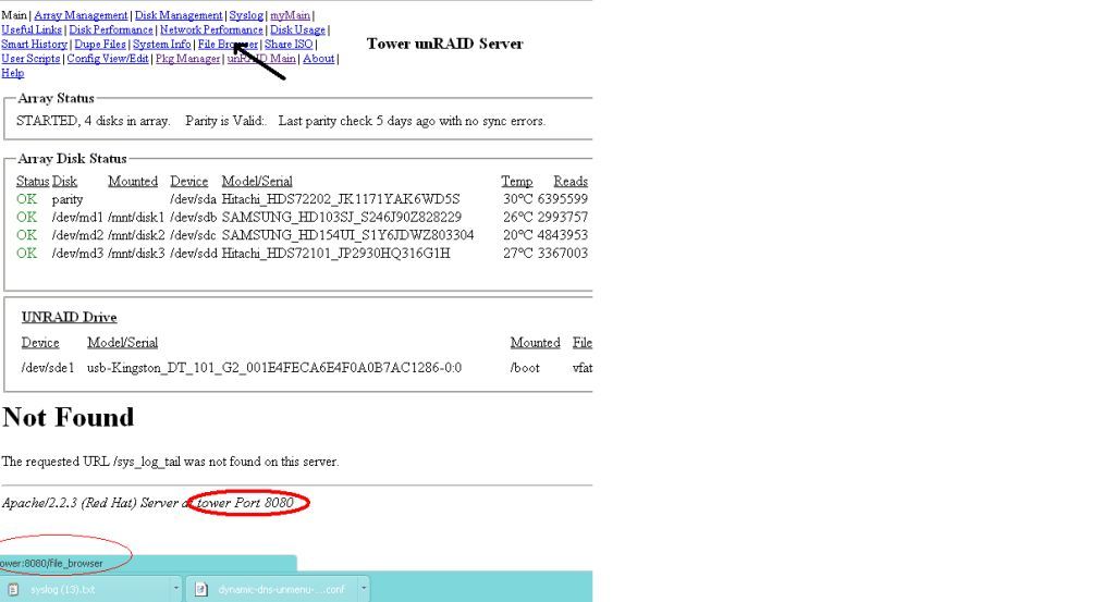

I don't think I asked the right question and was not very clear.
I have a host named "xxxxx.com" through no-ip (also tested with dyndns)
Setup with port forwarding in my router, and my no-ip account has my dynamic IP address.
After going to "xxxxx.com:8080"
This brings up the unRAID main properly.
When I click on any of the links through unmenu it wants to direct me back to my LAN address.
Example:
If I click on "File Browser"
it wants to send me to...
"tower:8080/file_browser"
that will attempt to direct me to my LAN address.
192.168.1.112:8080/file_browser
If I manually insert
"xxxxx.com:8080/file_browser" it works.
See attached.

unMENU is not secure in any way.  It would be a HUGE mistake in judgment to allow access to your server in the way you describe.  It was never meant for WAN use.
unMENU has no way to dynamically get the external address on the WAN.  Sorry.  You are just asking for hackers to invade your LAN they way you've set things up.  You'll just have to settle for "security through obscurity" and change the URLs yourself.
Joe L.
Thanks Joe.  As I was writing my reply, it made me realize that there are no security measures and I was making a mistake with the setup.  Thanks again.
