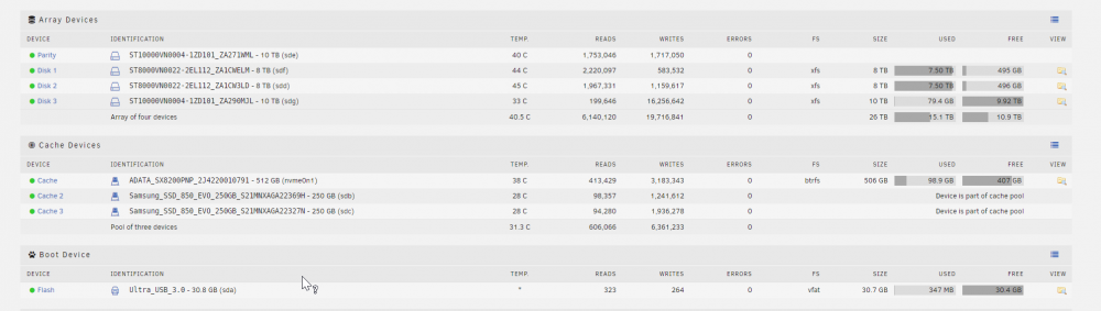

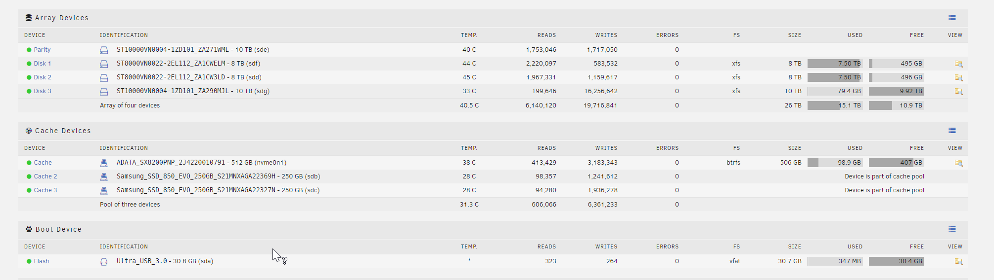

I was thinking the same thing. I have 2 x 10 and 2 x 8. 1 of my 10tb is a parity drive(have another one ready for double parity)
But the total size doesnt add up to me. Its giving me 26Tb(~23tb useable) atm but i only have a 10tb parity space. Am i missing something? or something i have not selected? i would have thought with the disk config i have would be around an 18tb  array.
Loving unraid btw.. have moved off 2 Synologies to my old gaming computer (x99). Shits all over DSM
Calculation is correct.  You have 26TB (10 + 8 + 8 )of storage space available.  The 10TB parity drive can (in conjunction with other drives) rebuild any data drive that suffers a failure.
